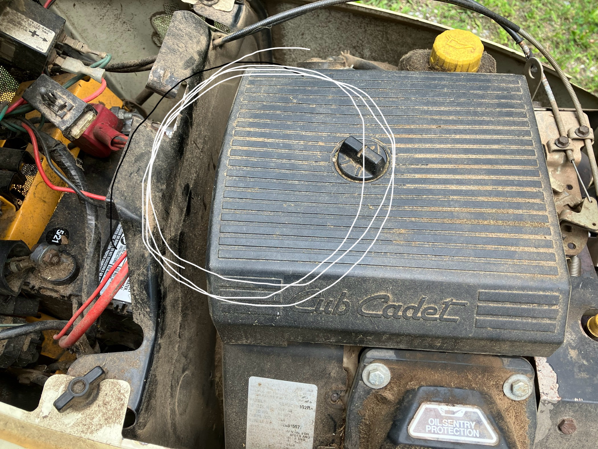

This just started. Mow for an hour or so and engine starts smoking. If I catch it early I see it starts at the back. Oil level is normal, don’t see any big leaks but it is a smell of oil burning which I know well from other engines. So far I’ve just shut it off and waited for it to cool down. Any ideas what I should be looking at? Thanks in advance. Gerrit

I can't easily tell if it's a B/S or a Kohler from the photo, some of these OHV engines are prone to head gasket oil leaks in the area around the pushrod chamber.

It’s a Kohler. My feeling is the motor is overheating and maybe some other issue as well. It’s running normally, though. On the one occasion—the first time—it happened, I stopped because a lot of smoke was coming off the engine and it felt a lot hotter than normal. Air-cooled, no temp gauge. Guess I can get out my digital kitchen thermometer.

Have you checked the cooling fins under the engine shroud to make sure they're clean and no mouse nests?

It looks like a Kohler command engine. The air cleaner base should have 2 triangular holes in it. You can see some of the cooling fins on the flywheel side through those holes. You can stick a air hose in there and blow some of the stuff out, then blow around the cylinder shrouds.
Kohler Courage engines on a Cub Cadet riding mowers were well known to leak oil from the bottom of the valve cover. It was caused by a design flaw that allowed oil to pool in the valve cover and not drain back into the engine block like it should.
The leaks dripped oil onto the exhaust and caused them to smoke once it got hot. At times the leak could be hard to detect.
Once you get the engine cleaned as others have recommended. Check the bottom of the valve cover for oil. It may need to sit overnight after running the mower before it shows up if it's leaking.
You will definitely want to pull all the tin off and clean the crud out. It will be everywhere. Watch the little screws cause they like to break.
The CH series Kohler engines also like to leak from the head gasket. The new gaskets you get are the upgraded ones that are a bit more durable. If you redo the head gaskets, check the cylinders for wear right away. The engine on my Cub Cadet is burning oil on one side & leaking oil from the gasket on the other. Hope to get that ironed out this year.
You'd also benefit from pulling the tin off the engine & giving it a good blowdown or power washing. Those engines seem to leak a bit less when they are not getting so hot. And those engines do like to get HOT!

You've been given great advise by others about pulling the shrouds and cleaning. It was amazing how plugged up our ZTRs (mostly Kohlers) got in a year at work. Finding oil leaks is easier with the shrouds off also.
Thanks, all. Finished up my mowing yesterday. No smoke but I didn’t run it very long. I’ll carve out some time to get at the engine and do a thorough cleaning and inspection. Been a relatively trouble-free machine, time to show it some love. Thanks again. Gerrit
Judging from the circle in your picture, I would guess the crankcase breather gasket has failed. There was a buliten on that a few years back. I think there was a kit that included a thicker cover plate as well as a gasket. If that is what it is, you should see oil around the breather cover plate once you get the air cleaner base off the engine.
