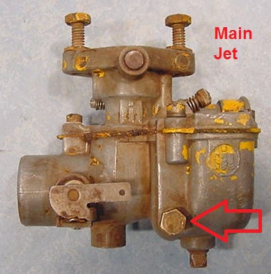

What would cause this? I ran my cub up and down the road the other day and it started surging. It surges even at idle. Could it be a clogged or partially clogged jet, choke butterfly opening and closing? Not sure. Any help appreciated.
It is very likely a passage in the carb has become plugged. Grab the rod going to the carb and hold it in one spot, if the engine still surges it is in the carb. If the engine runs steady then it is the governor. There is a buffer adjustment on those, I am not sure what the proper method is to adjust that if needed.

If you Cub has an IH carburetor pull the main jet and clean it.
Sounds like either a clogged carb or a fuel delivery issue. If it is a plugged carb cleaning out the jets is a great idea, if it is a fuel delivery issue open the carb drain plug and see that a generously sized and steady stream of fuel flows out, and continues to flow after a minute or two (you'll want a clean jar or jug to catch the fuel in). If not, shine a light down into the fuel tank, the sediment bowl intake in the fuel tank is likely plugged with bits of gunk from the inside of the tank. There could also be gunk clogging up the fuel line or the needle valve could be stuck mostly closed. In any of these scenarios the gunk plugging up the fuel system will have to be removed.
