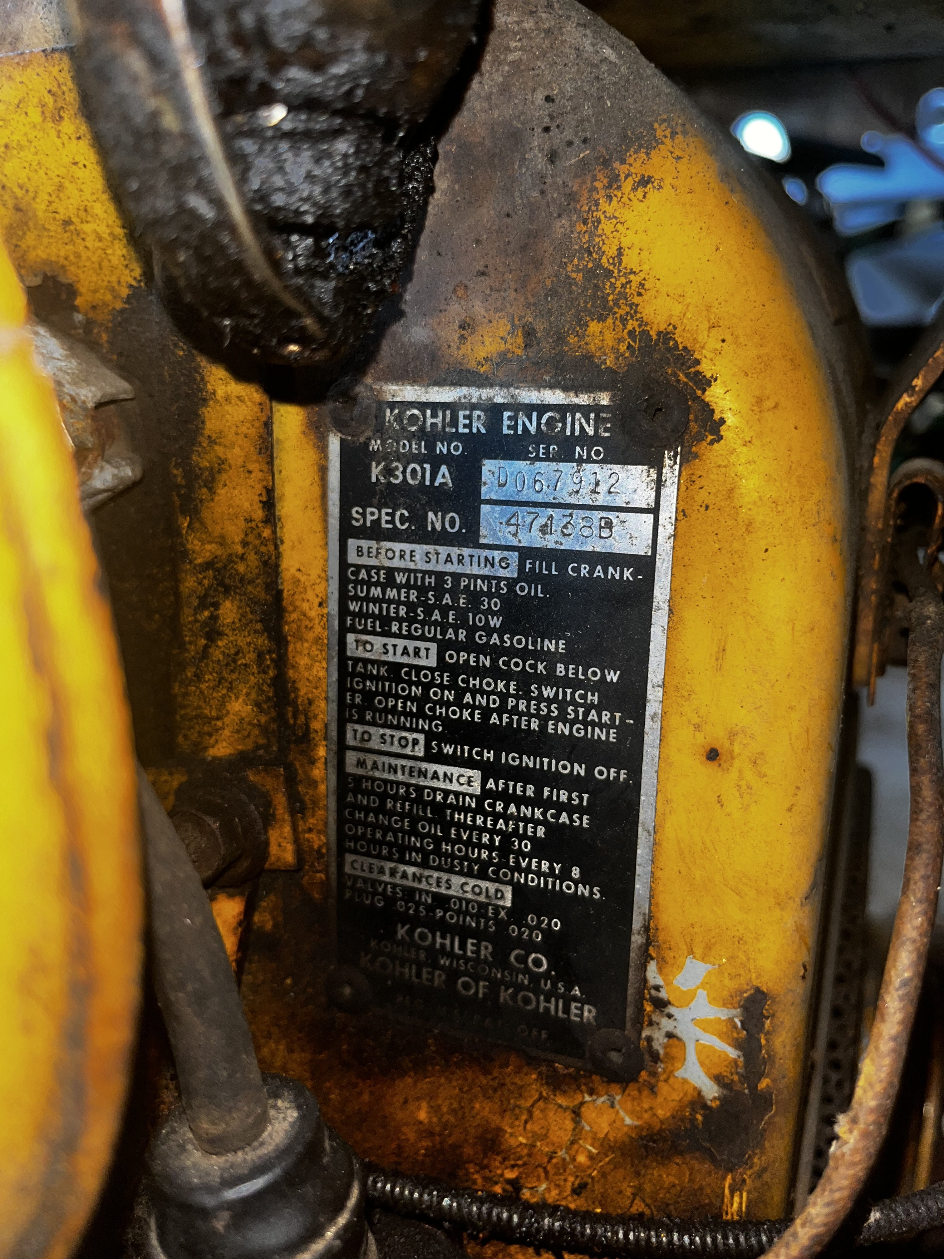

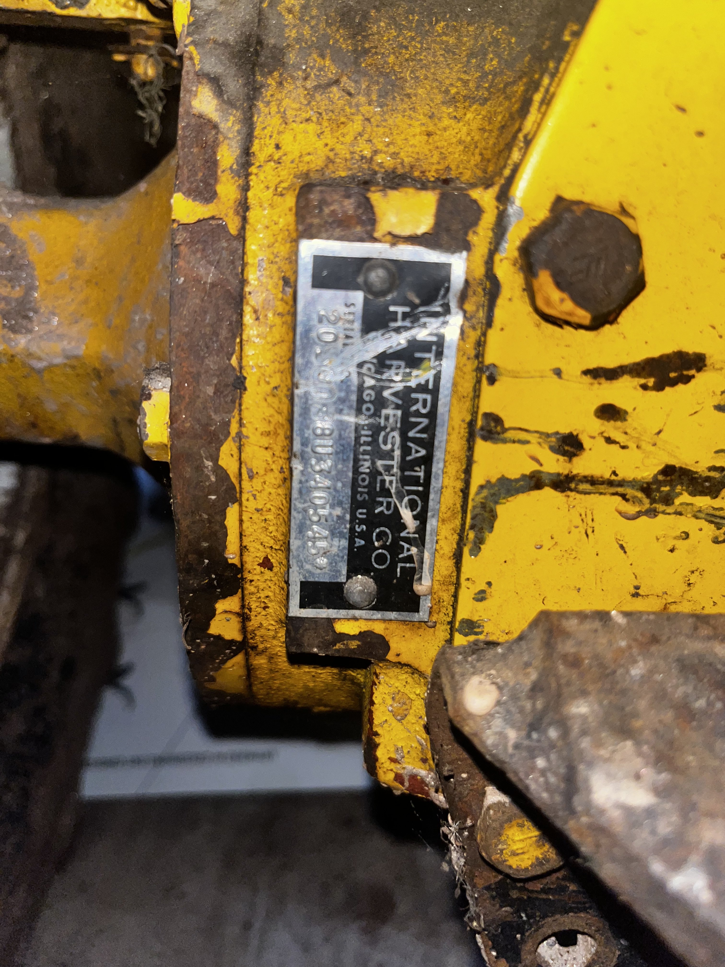

the engine is yellow i took a picture of the serial numbers and attached them here

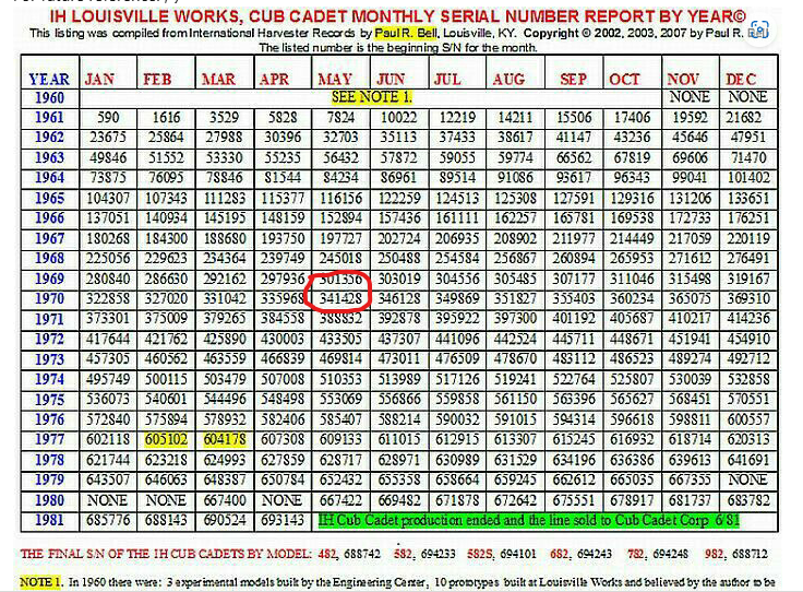

I checked TractorData and that serial number for the tractor would put it as a late 1970 model. I'm still digging on the engine number.
Actually TD is off.
Below is more accurate.
Looks like made April of 1970
Post what the entire tag says "2050038U340545" ??
If 0038 is there, the tag is for a 107. That tag #, the model # decal on the dash and engine are the only differences between a 107 and a 127 (10hp or 12hp). The hoods alone are identical including the decal.
