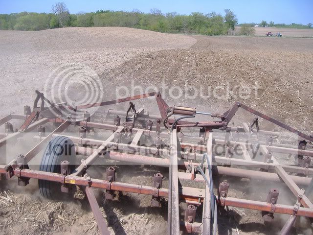

Different areas have different names for the same tools. I'm in western Ill. The first picture is a field cultivator. The tines are close together and work at shallow depths. It is used for seedbed preparation. The next picture is a chisel plow, it is made for deeper, primary tillage, the shanks are usually about 1' apart, and are run 8" or deeper. Usually about as deep as the tractor will pull it. Don't have a row crop cultivator to show you, but the tines or shanks are spaced close together with a space between where the row is planted so you can work the middles and not tear out the crop unless you fall asleep and plow out crop (NOT GOOD). Newer row crop cultivators have a single beam for frame with shanks mounted behind on a parallel frame to allow it to move up and down independently as you go across the field to follow ground contour. Not much cultivating around here anymore, herbicides are used instead. A guy I work with said he pulled the row crop cultivator out of the fence row to use it this year, and his 15yr old son didn't know what it was or what it did. Hope this helps. Chris
