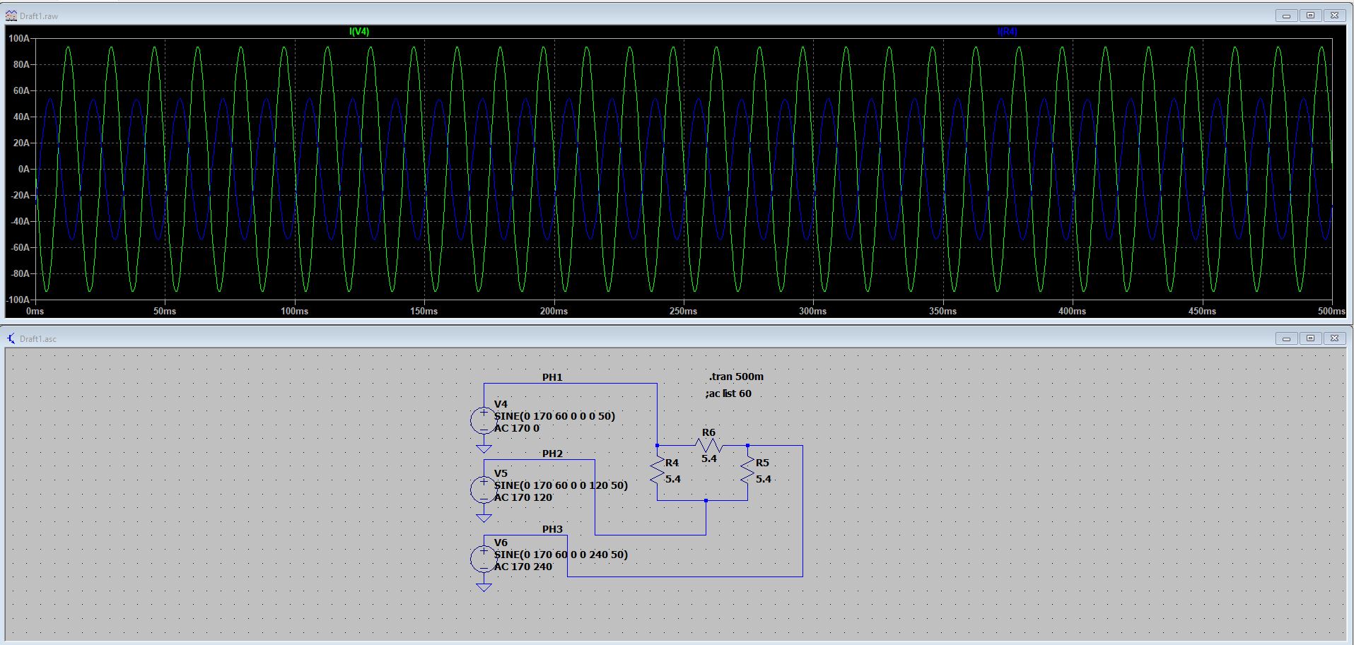

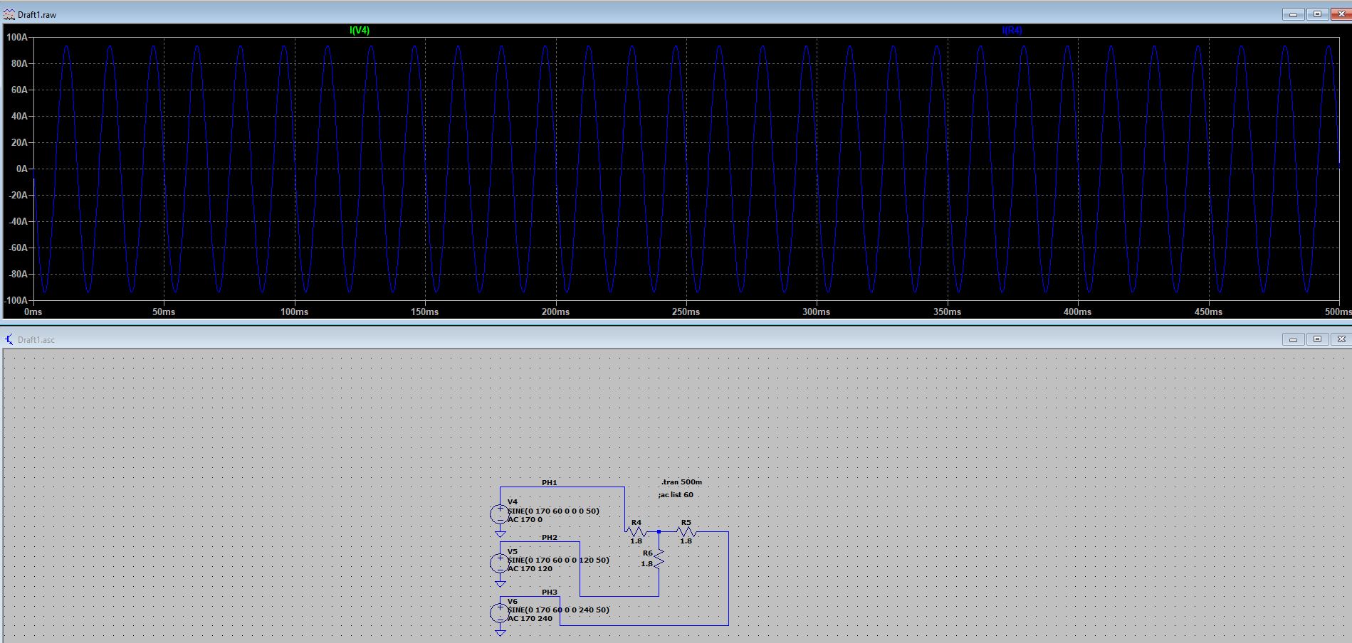

Pictures are worth a thousand words.
Both diagrams are 208 3Phase, 66.6 Amps (RMS) per phase.
Both are possible configurations of the existing elements. Delta with 5.4 Ohms per element. Y with 1.8 Ohms per element.
Both should result in higher current per phase, and total power produced if connected to 240V 3 Phase. (there were never any lies detected in that statement)
Notice that no neutrals are drawn. 3 Phase is usually implemented so they aren't needed, due to balanced loads. But sometimes they are there for various reasons. By "usually"... usually a delta, because of the statement below.
The behavior of these two possible configurations is different, in the situation where one element burns out (opens), especially if there is a neutral that may now have to carry the unbalanced current.
Further interpretation is left to the motivated reader. Especially if there are neutrals involved, because they get messy.
No warrantees given or implied.
LTSPICE is a free program, if anybody wants to fiddle for themselves.
