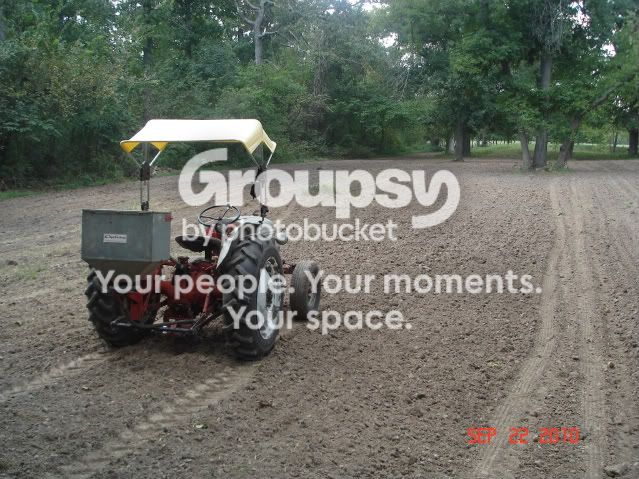

Hey JED, is it like this one?
If so, I've got the original chart, it does list speed and height above ground, ( I believe). Also has rates for fetilizer. It's out in the barn, I'll get it and scan it tomorrow. Shoot me an email and I'll get it to ya.....40.....50 bucks tops! :mrgreen: Mark
The one Dad had was a heater motor but only one speed but a constant speed is what he liked about it.
Here ya go JED. Holler if you can't read something. I got this spreader from my uncle, he bought it new probably 40 years ago to seed a pasture on his 30 acres near Camdenton, MO. I couldn't believe it when he had the original chart, and all the parts and pieces that came with it, including the box the parts came in. It's one of my favorite pieces of equipment. The last picture is a turnip patch for the deer, I set the gate to a little over "2", if I remember correctly. It was more than enough. The seed was so thick, it was little more than tops in the middle, but plenty of turnips on the edges of the patch. I made 2 runs, then lightly disced the seed in. Next year, maybe just open er up to "1". HTH Mark
