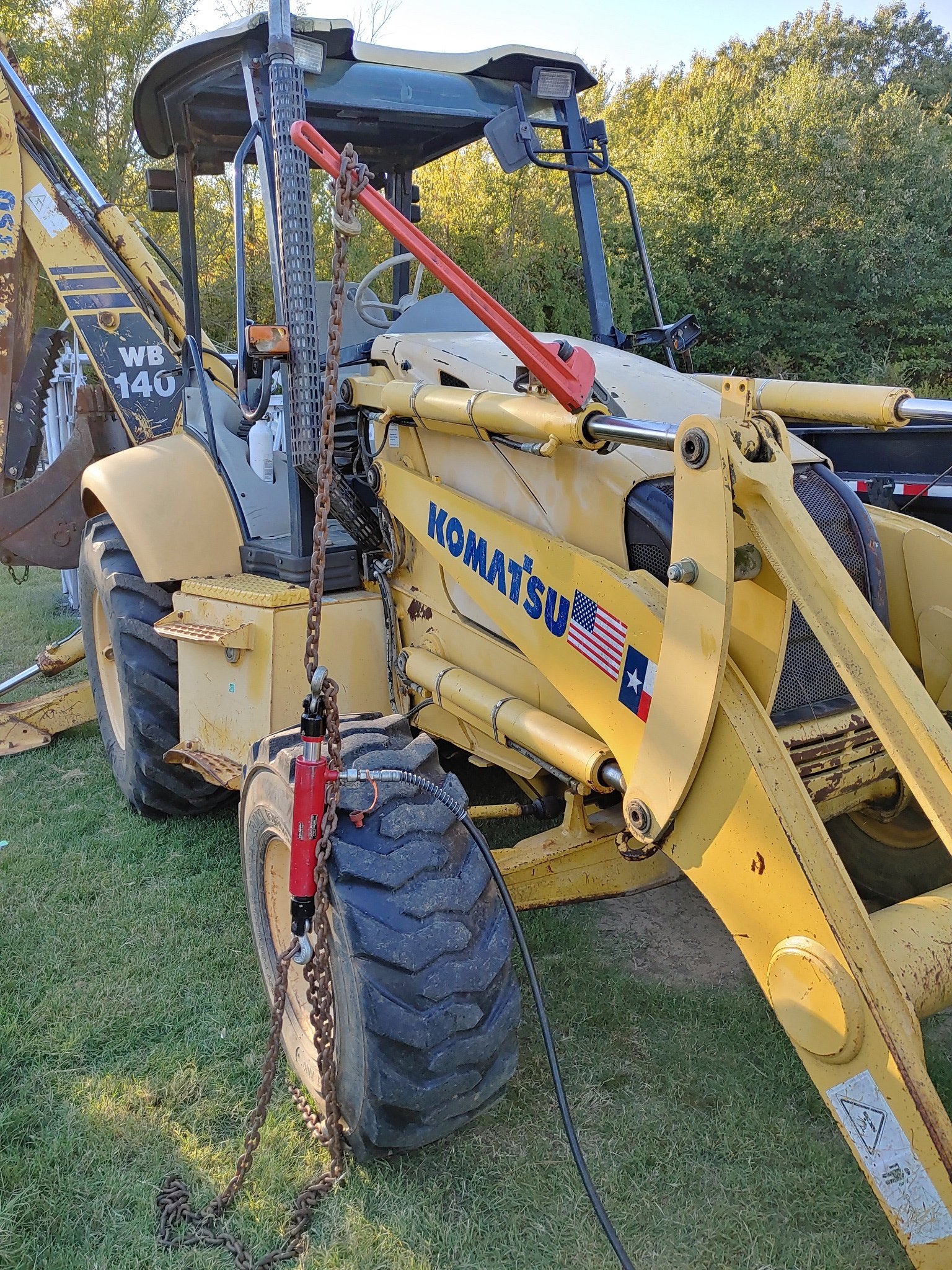

I'm no stranger to opening hydraulic cylinders, this one is just too big for my tooling. 36" Harbor Freight pipe wrench ($25) and about 45min in the shop making a replacement for the pin-in jaw with a radius to match the cylinders it will fit and a 3/8 pin for the spanner slots. The moving jaw I just milled in a pocket for another 3/8" pin. Works fine on the cylinders it fits and some still require extreme torque. The cylinder in the back above the WB140 is the problem one, too big for the wrench to fit. The cross pins are also problematic.

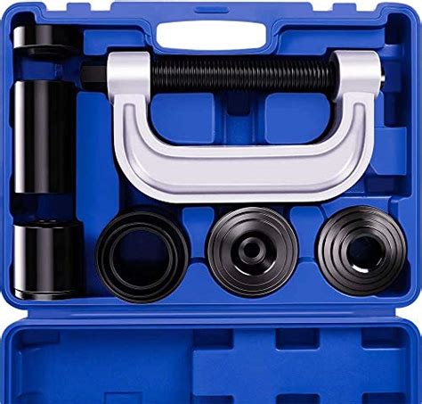

Ball joint press? If one will not work. It may give a little inspiration on Fabricating something.

I have one, way too small. We're talking pins roughly 1 3/4" dia x 13.5"+ long that have roughly 4"+ at each end somewhat rusted in place. Big stuff.

The modified wrench which works on cylinders with end caps up to about 4 1/4" dia. Perhaps I just need to mod a larger wrench to fit the current 4 7/8" cap and the boom cyl cap which is about 5 1/2" dia. ETA: It appears a 48" wrench will only get me to 5" capacity which would do this cylinder but not the boom one. HF also doesn't appear to have a 48" option and the cheap one I find is $80.

That is the 5T rated pull back ram. I doubt the wrench could withstand anywhere near the limit but it did take a good amount of pull to get that end cap loose.
The current problem cylinder is on the backhoe and is too large dia for that wrench to fit. The stuck cross pins are also a lot longer than they are on the loader.
