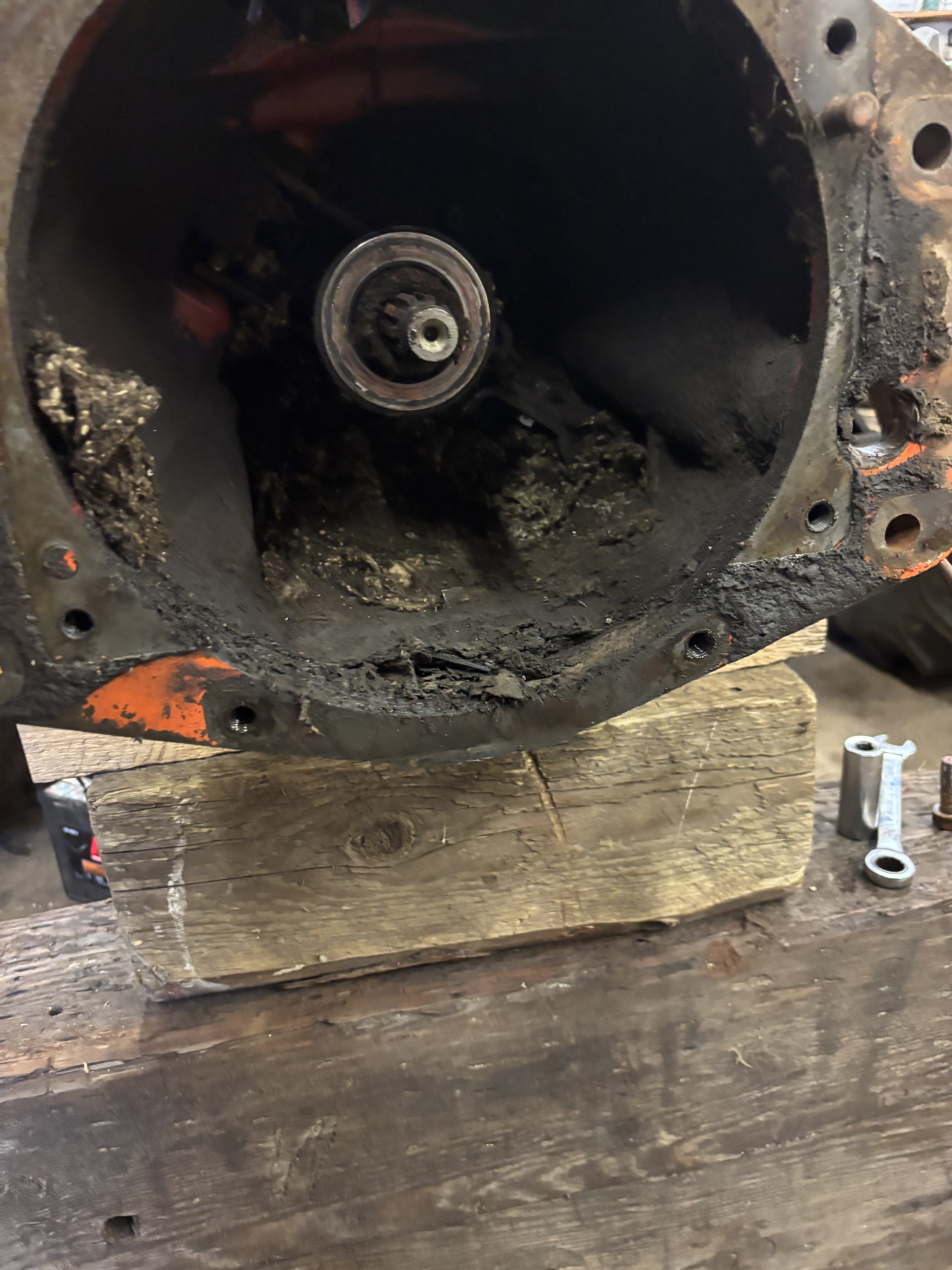

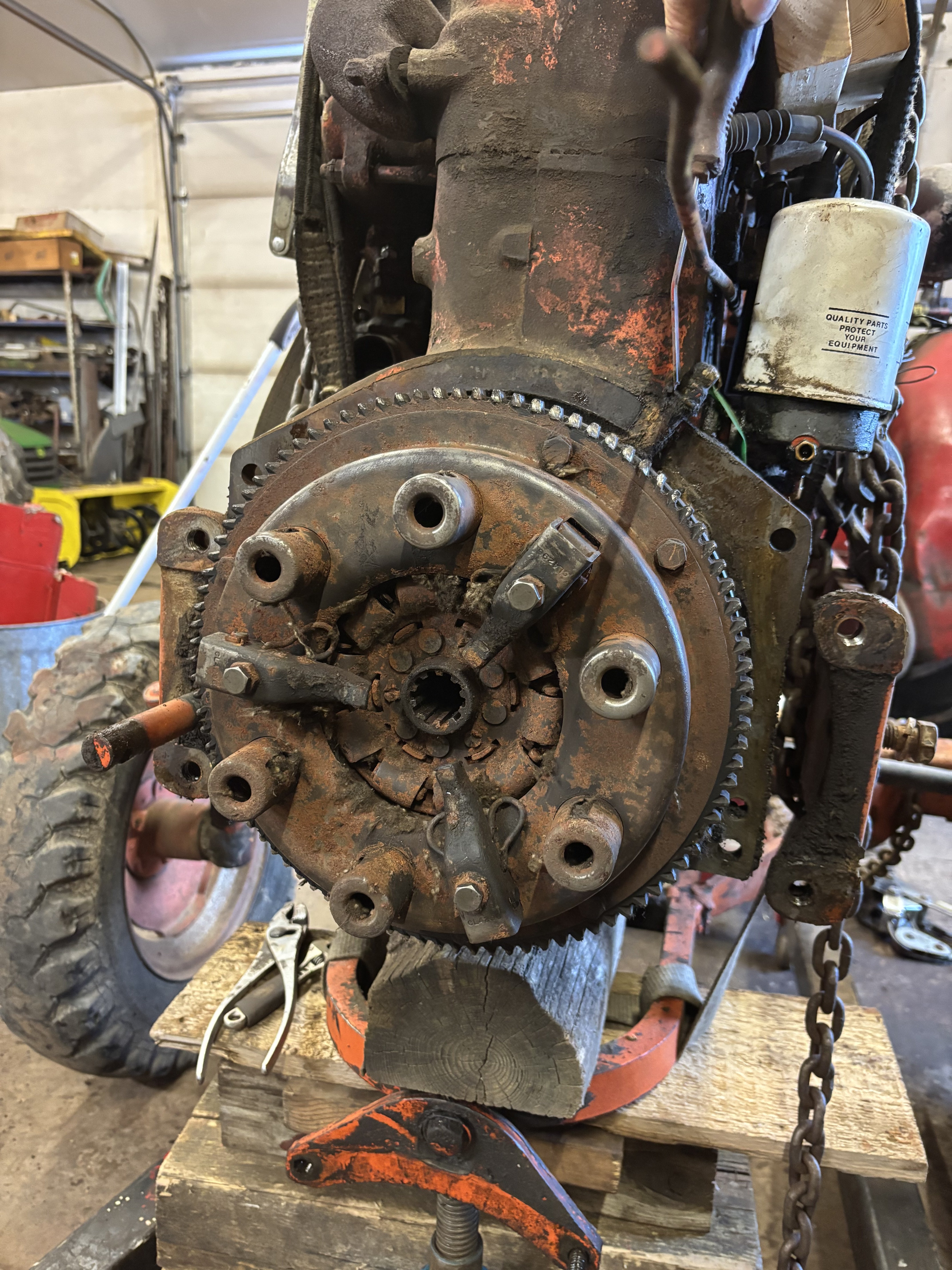

We did get our D 14 split which is an easy tractor to do. We ordered a new ring gear from Agco before Christmas but it still hasn’t got here. Amazing how much fuzz was in the bell housing from the mice.
So, what was the tooth count on the ring gear?
Are you replacing the clutch while you are in there?
the ring gear is a 93 tooth. the clutch disk and pressure plate are good. looks like they were replaced not long before we got the tractor so its going back together.
