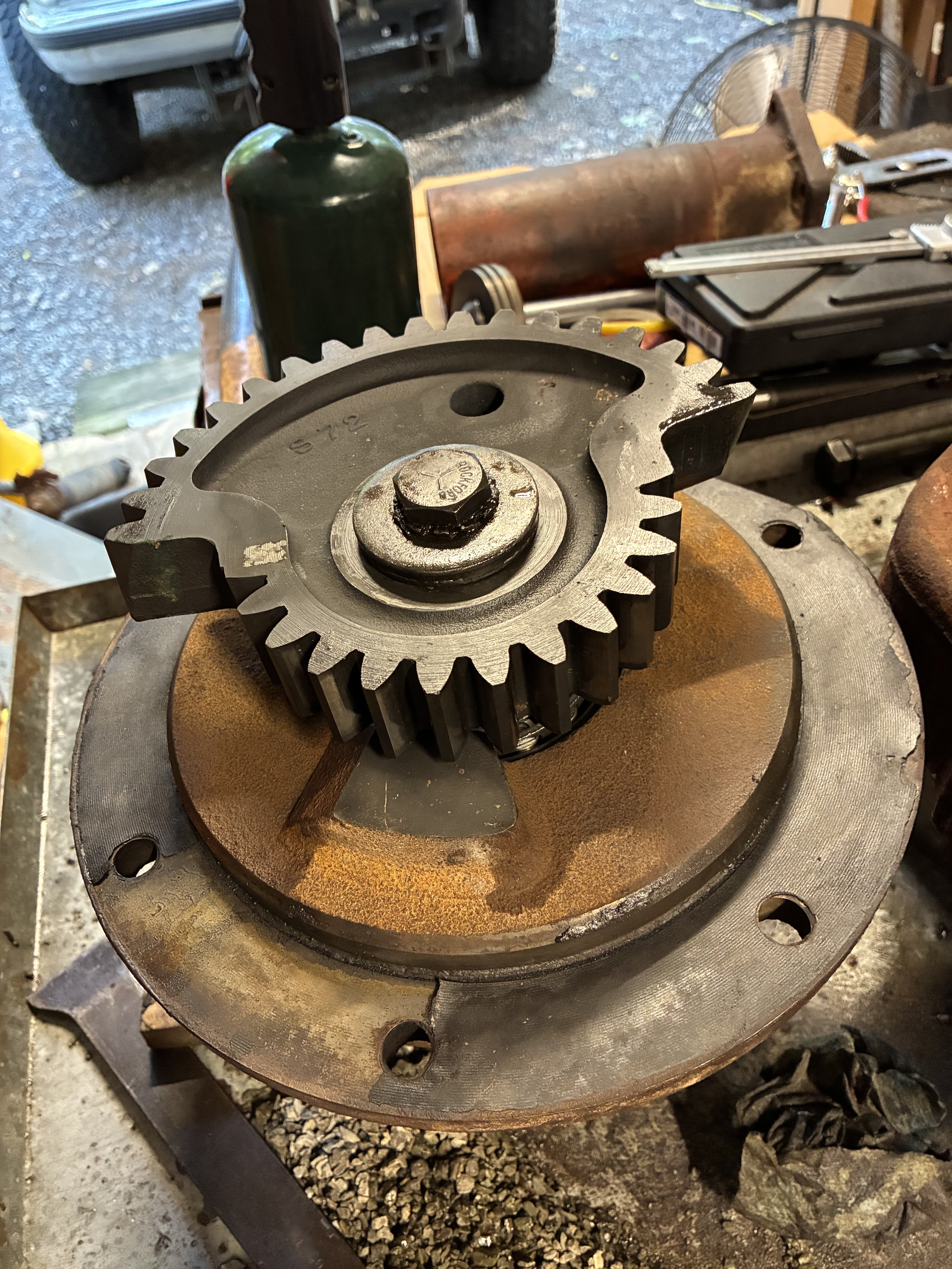

Finally got back to the tractor after dealing with vehicle repairs and other more pressing matters. Pulled the front wheel and spindle, slid steering gear forward, then pulled completely off the tractor and brought it home for cleaning and inspection.
After cleaning, pulled the hydraulic ram to find the pin intact, glands intact, and nothing obviously amiss. Proceeded to pull the control valve and worm gear out. Upon removing the front cover from control valve, I discovered the nut holding the bearings on worm gear was barely engaged with the threads and not staked to the shaft. I suspect the nut worked its way loose enough the valve spool wouldn’t shift adequately when turning left. Cleaning and reassembly will proceed evenings this week or next weekend, if I don’t head to the national forest with the kids to camp out.
OK. That does happen occasionally. That nut cannot be TIGHT. Basically, you just snug it up to contain the Orings on each side of the spool. So, too tight will make the steering assist less and too loose will allow the Orings to blow out. The front support still had to be pulled to get to where you are now at.
Understood. Service manual specs 5 ft-pounds. No complaints about pulling front support, it definitely needed a thorough cleaning.

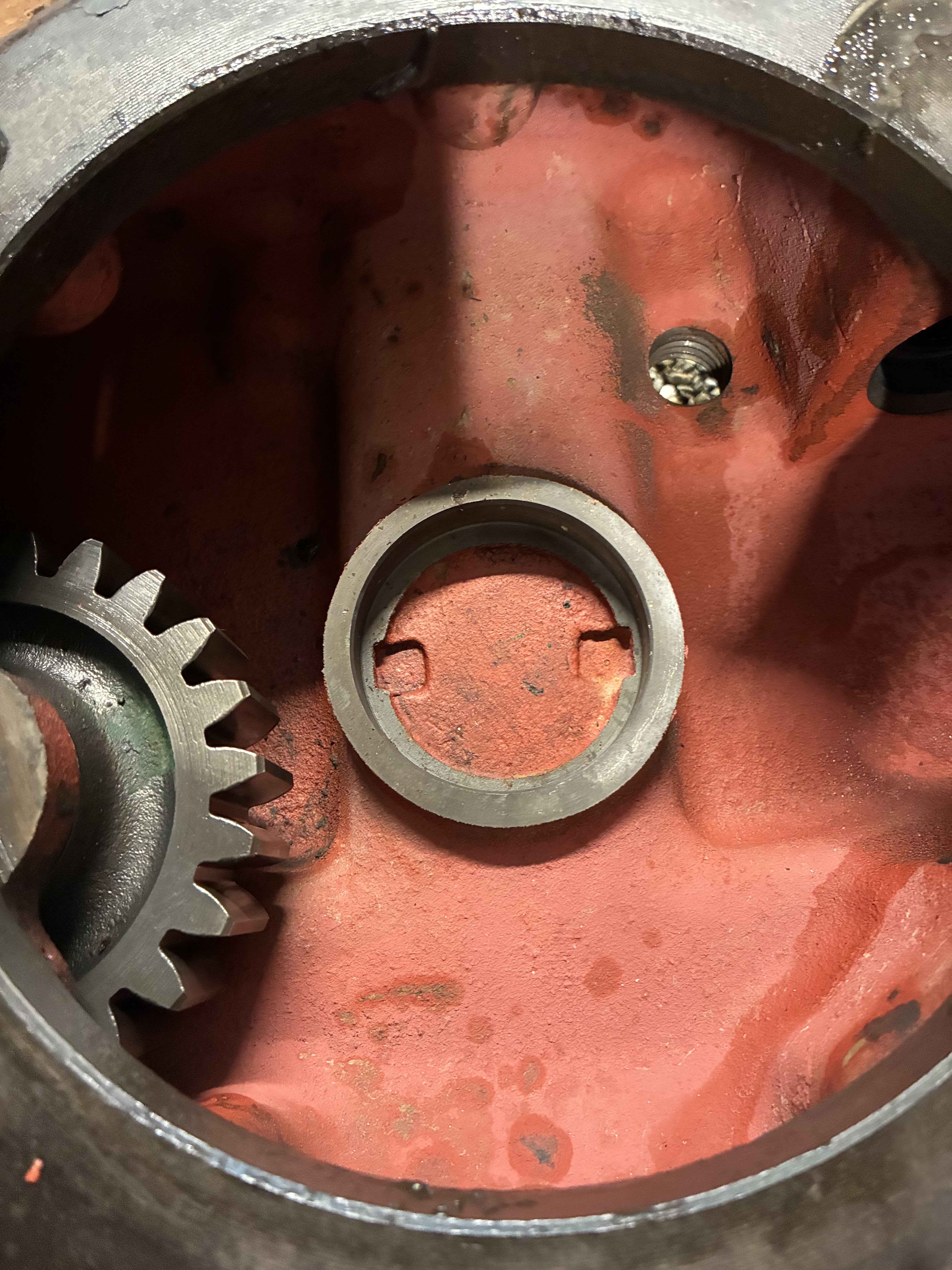

Continued cleaning and inspecting over the past two weeks. Aside from sludge build up in the front support housing, nothing amiss in that area. Did go ahead and drop main gear and bearing assembly (retainer) out to allow for more thorough cleaning.

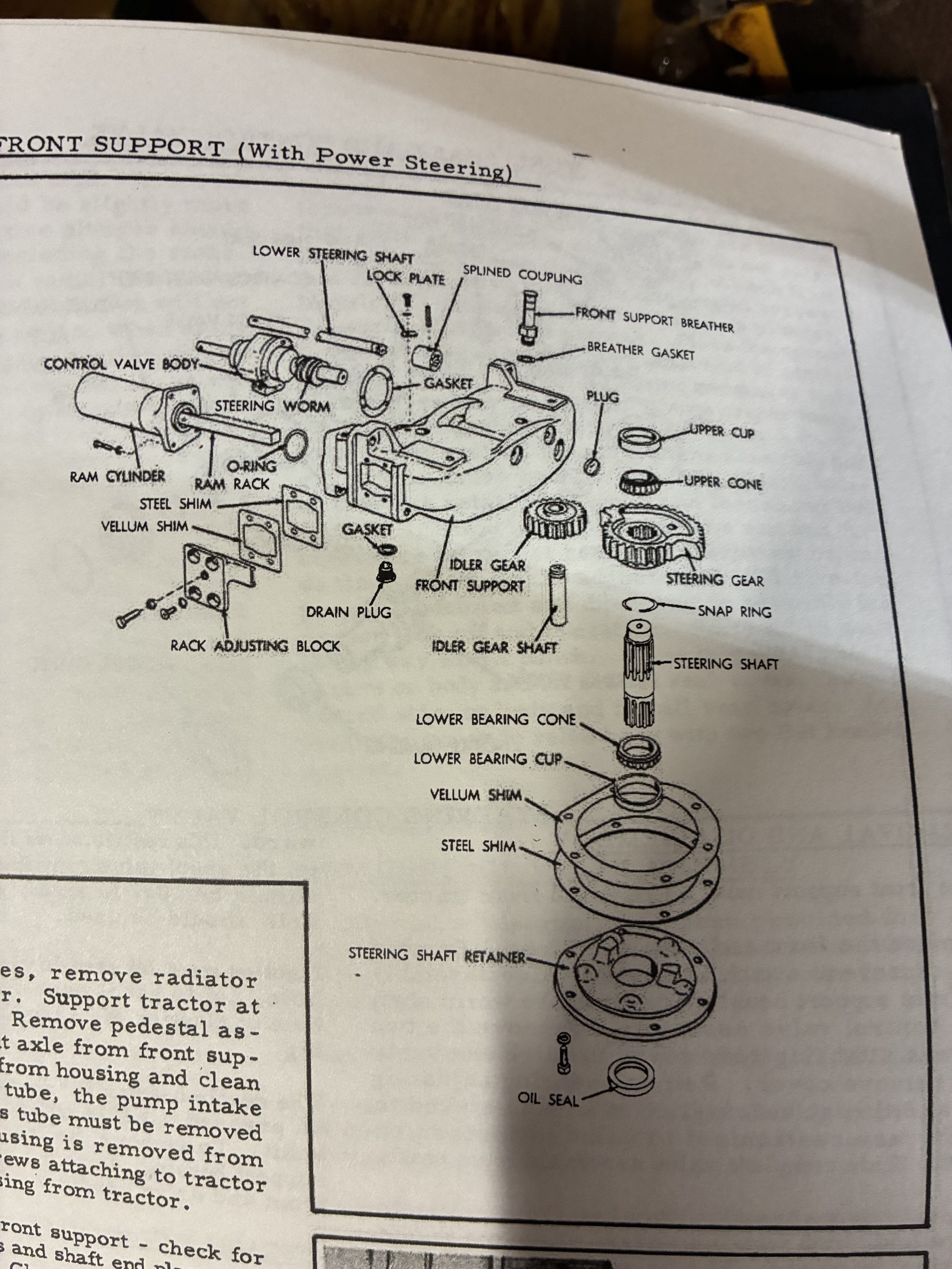

Now to locate a source for the 0.005 vellum gasket replacement between the bearing retainer and front support. Is the .005 critical or can a 1/64 gasket (0.015-0.016) replacement serve without issue? Does not appear to impact preload unless my support has been missing a bearing for who knows how long.
In essence, what I see on the bench doesn’t match the service manual.
Well yeah !! A tapered roller bearing and cups top and bottom !!! Set your bearings to a slight pre-load. Do NOT make a gasket !! be careful with what you have and smear a layer of RTV in place of a .005" gasket. IF THIS IS A SINGLE FRONT WHEEL I'VE NEVER SEEN ONE BEFORE !!! AND THAT MAY BE HOW THEY ARE !!!
It is a single front wheel unit. I suspect the manual is written for wide front axle units or mine is a Frankenstein.
The retainer assembly has a tapered roller bearing below the main steering gear that appears to be the upper bearing. I’m assuming there is another lower in the housing but haven’t disassembled that portion, just flushed out with brake cleaner followed by a light oil.
