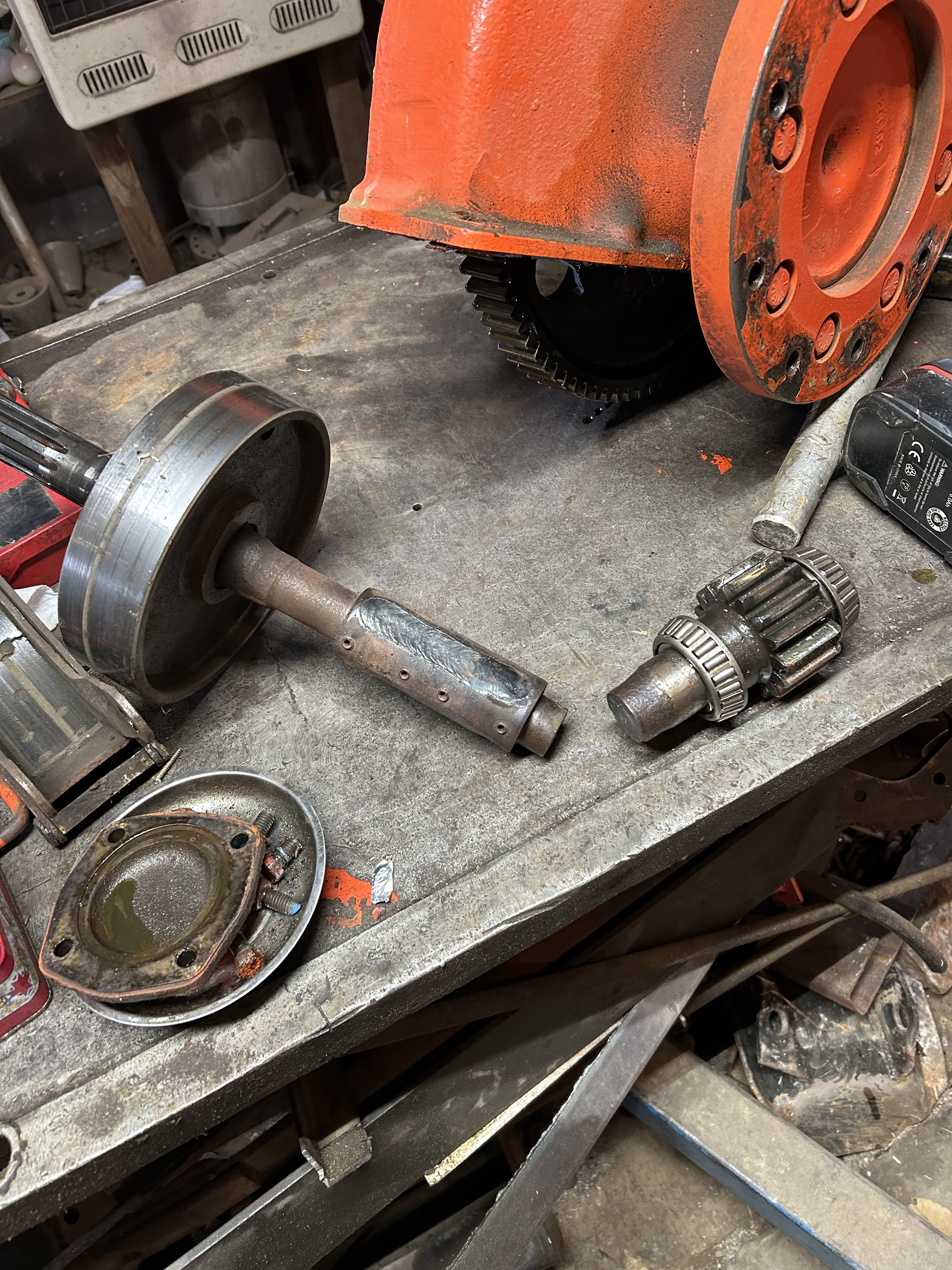

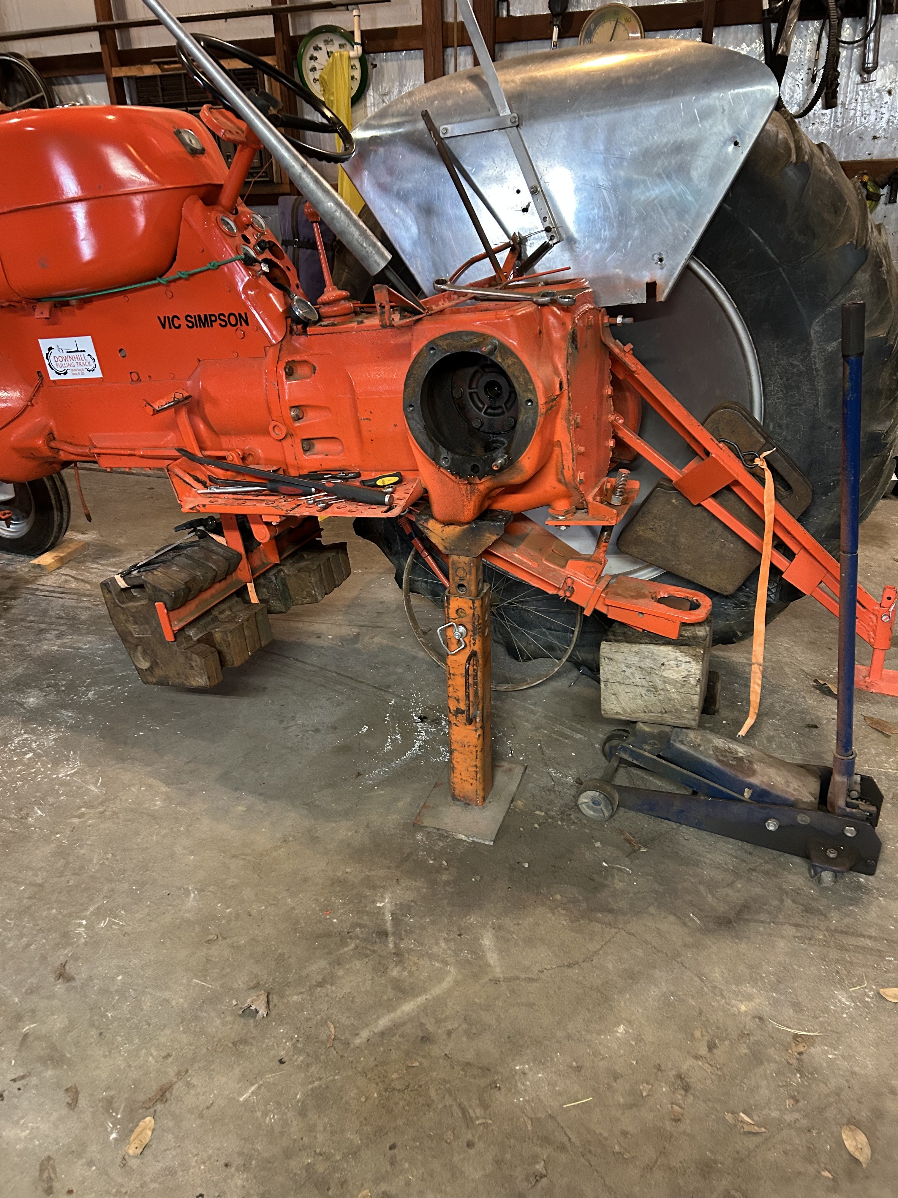

I know you posted this a long time ago. What have you done? Don Karpel, Did the crank in my D17, and Bored the block and installed the sleeves. Harrison Automotive in Albion flowed the head and fit the pistons. I put everything together. But don’t expect everything to fit the first time. Like my push rods were to long. Or be done on time. Now I’ve twisted the left inner axle off. Waiting on machine shop to work their magic. They are 10” shorter than stock
