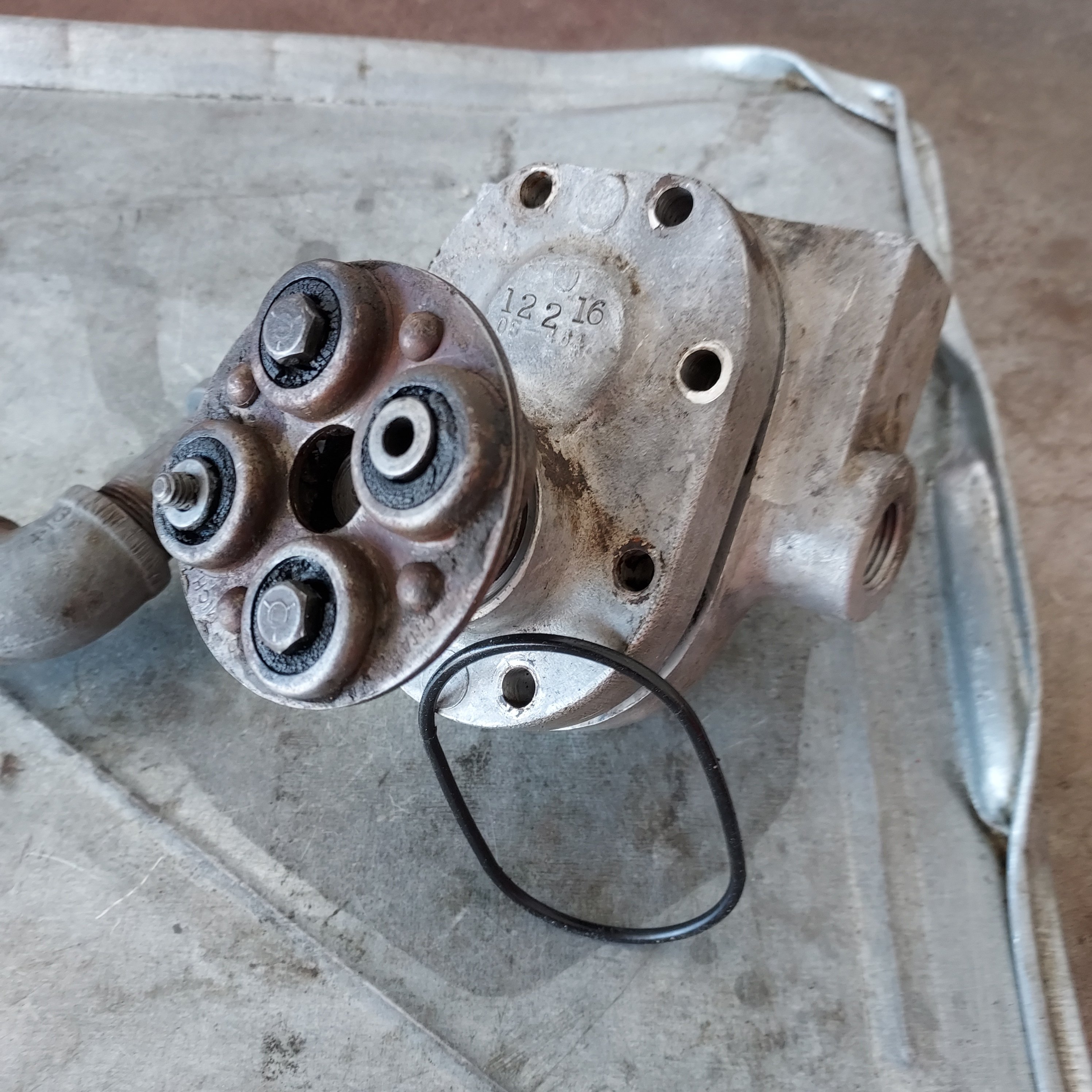

and the tractor model as well as numbers off of the pump. Images would also help. Front mounted crank driven pumps are common, and nearly generic. I would search for you but the task is yours. JimBy chance are there parts still in stock for the Dearborn equipment and if there is I just can't seem to find an E- mail or phone number for them, need a little help here, Thank you..
I very much doubt you are going to find an email or phone number for Dearborn. With the model number you might find something under New Holland, since Ford is now under them.By chance are there parts still in stock for the Dearborn equipment and if there is I just can't seem to find an E- mail or phone number for them, need a little help here, Thank you..

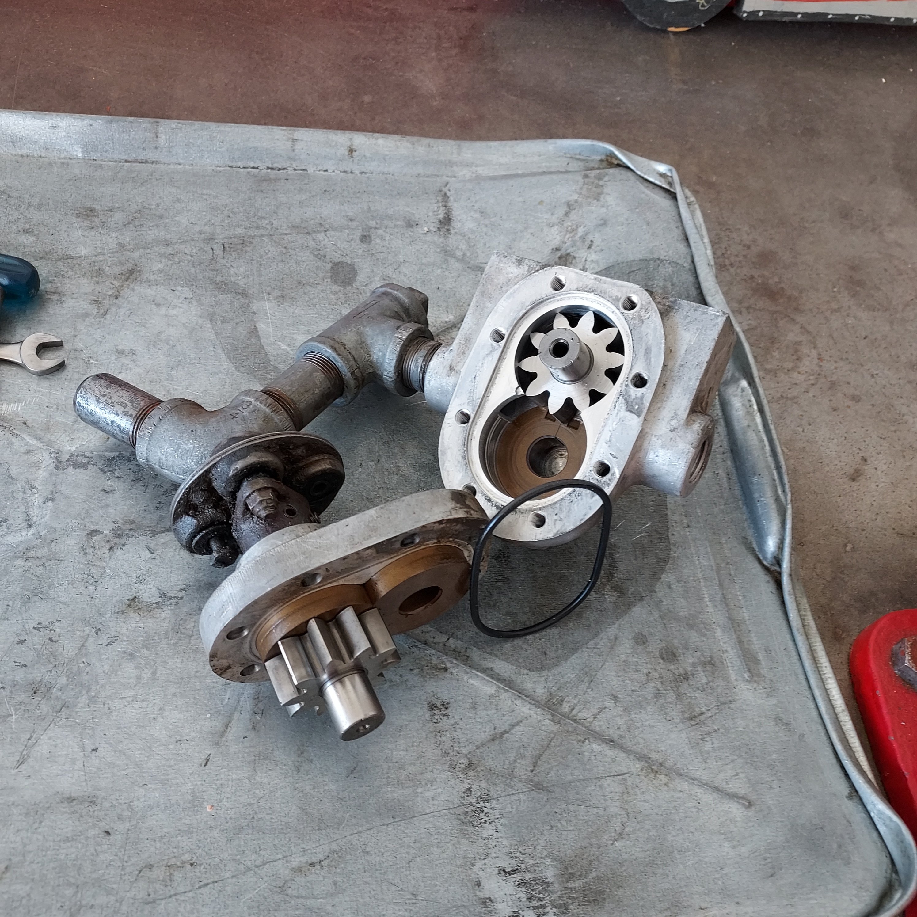

Take the pump to a good hydraulic shop. They will check both the wear and availability of parts. I would not use the common schedule 40 galvanized pipe for hydraulics. Not rated for that at all. I would also replace the drive coupling because the isolator rubber is deformed and can cause vibration that wears out pump bushings. If there are scrapes inside the housing it might be time and money ahead just replacing the pump. it is a easily replaced commodity ! Jim
Dearborn does not exist any more! The Ford line of Farm tractors is: Ford New Holland.Like I was saying earlier, If I just had an E- mail or phone number I would eighther by a pump or kit, I have called a couple a places with no luck..
Contact Yesterday's Tractors Parts or PartsASAP, they have pumps that will fit. Many other places will have them also. You will likely need to give them mounting info and dimensions, shaft type and size, and oil port info. Linked is one example this site has.Like I was saying earlier, If I just had an E- mail or phone number I would eighther by a pump or kit, I have called a couple a places with no luck..
The company has not existed since the 1950's or 1960's. You are not going to find an email or a phone number.Like I was saying earlier, If I just had an E- mail or phone number I would eighther by a pump or kit, I have called a couple a places with no luck..
19-8 would be a typical Dearborn or Ford loader model. Diagrams are available for this loader online at Case New Holland or Messicks, go to link below, scroll down to Select your Diagram and choose 037 - Hydraulic Pump and Drive. The seals you are looking for seem to be still available. I'm skeptical these will solve your leaks, aluminum- body gear pumps tend to wear out over time and eventually need to be replaced. Adapting a modern pump of similar specs might be the best option.Model # 19-8 05100205004. 05-484View attachment 72914
