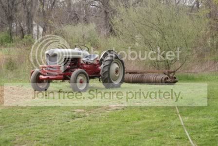

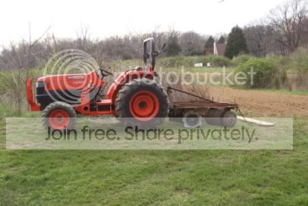

Just for comparison and to show off my tractors:
Kubota with loader off and disc on:
NAA with cultipacker:
