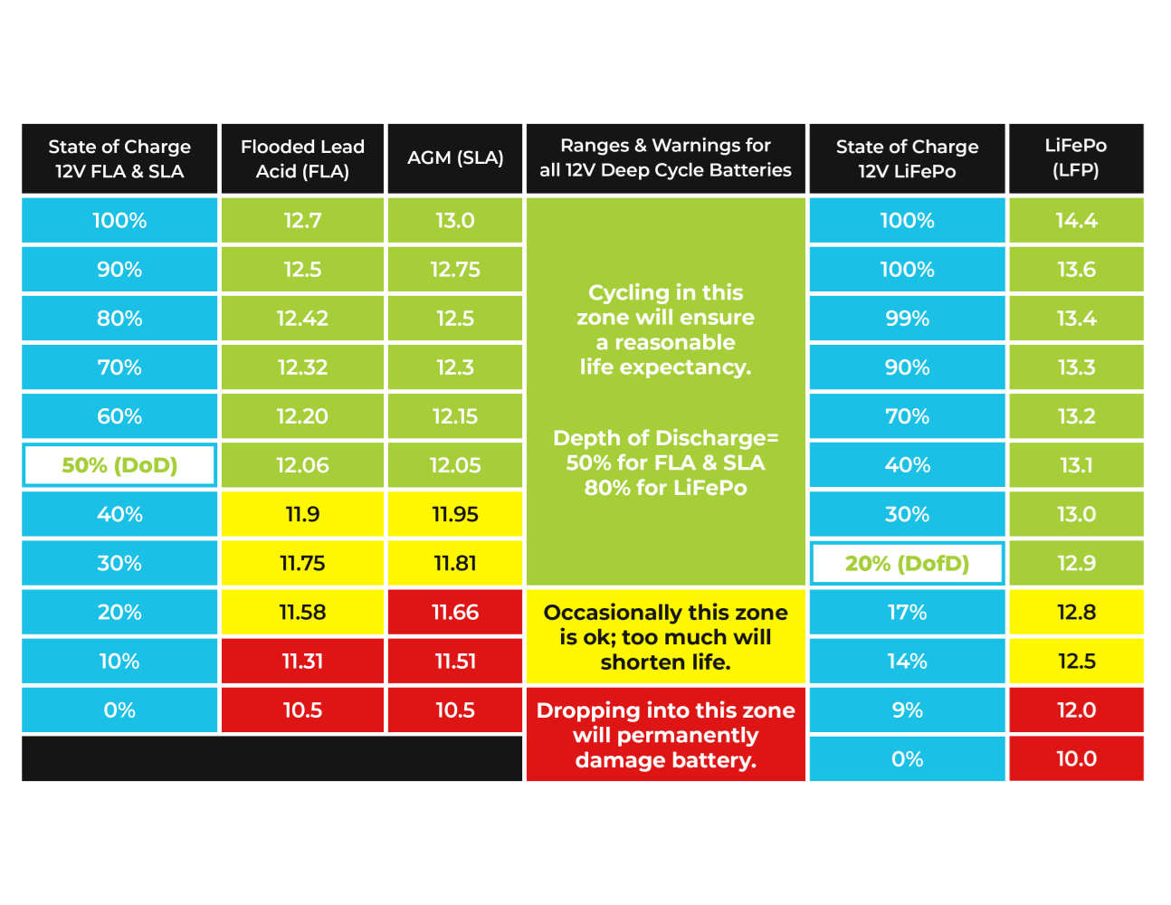

A true deep-cycle battery will not use the term CCA anywhere. This is a true deep-cycle battery:
https://www.renogy.com/deep-cycle-agm-battery-12-volt-100ah/
Exactly that’s what I found as I posted above!!!!! The true deep cycle batteries I’ve used like Trojans are typically labeled in Amp Hours while Starting batteries are usually labeled in CCA. That doesn’t mean there may not be exceptions and I have seen traditional posts orrrrrr threaded terminals on all sorts of batteries. Over 50 years of rv and golf cart use I evolved from wet flooded lead acid to agm to RV Marine (semi deep cycle) to true Deep Cycle to Lithium I’ve seen it all and enjoyed the evolution !!!!!

As previously stated . Do not discharge any lead acid battery below 50%
Do not leave a battery sitting discharged .
Do not over charge a battery .
That is a common misconception, not discharging a lead acid battery below 50%. The only thing that happens is it shortens the lifespan of charge/discharge cycles; unless a LA battery is discharged below 30%
