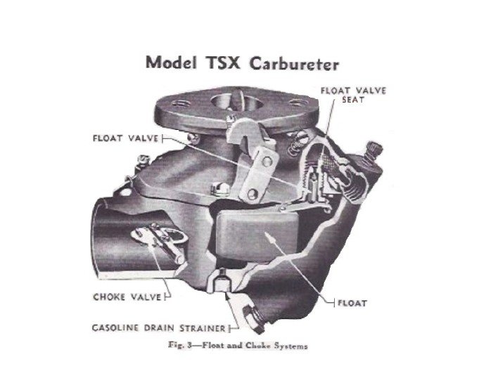

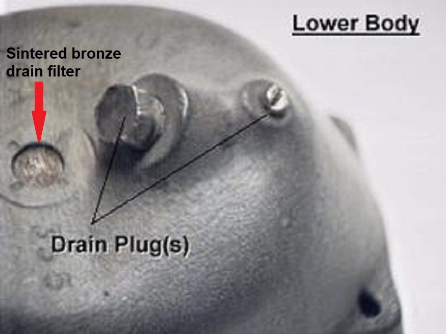

There is supposed to be a sintered bronze "screen" in the hole in the bottom of the air intake of the carb, about 2" in. It is supposed to let any gas that accumulates in the air passage drip out. is that there on your new carb?

Those screens are pressed in, not screwed in.

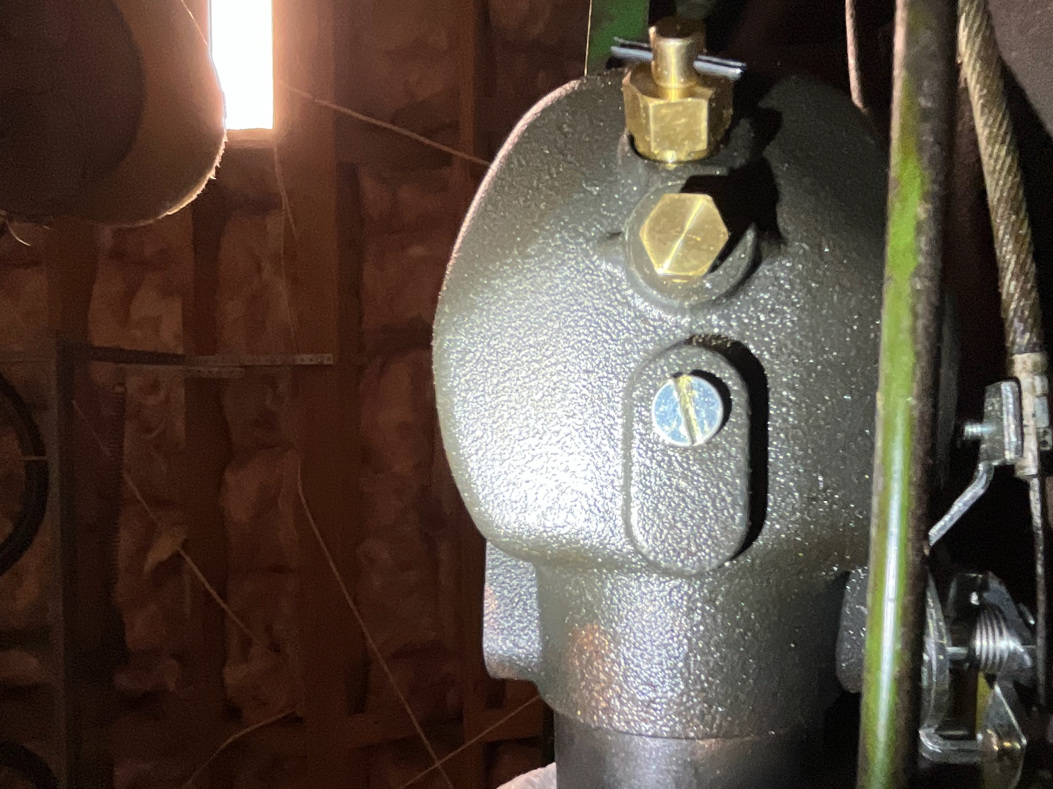

Thought they were screws - both are slotted. I have the old MS one that I removed and a new MS one I put one (non solenoid type load screw). How would the gas drip out?

Did you see where the arrow in the picture I posted points to the sintered bronze drain filter? Did you notice the 4 puncture wound punch stake marks around the hole that hold the filter in?
Post some pictures of what you are looking at.
Old and new carb have slotted plugs. I can see screw threads on old carb. No sintered screen on inside of either carb. New carb screw is brass.
