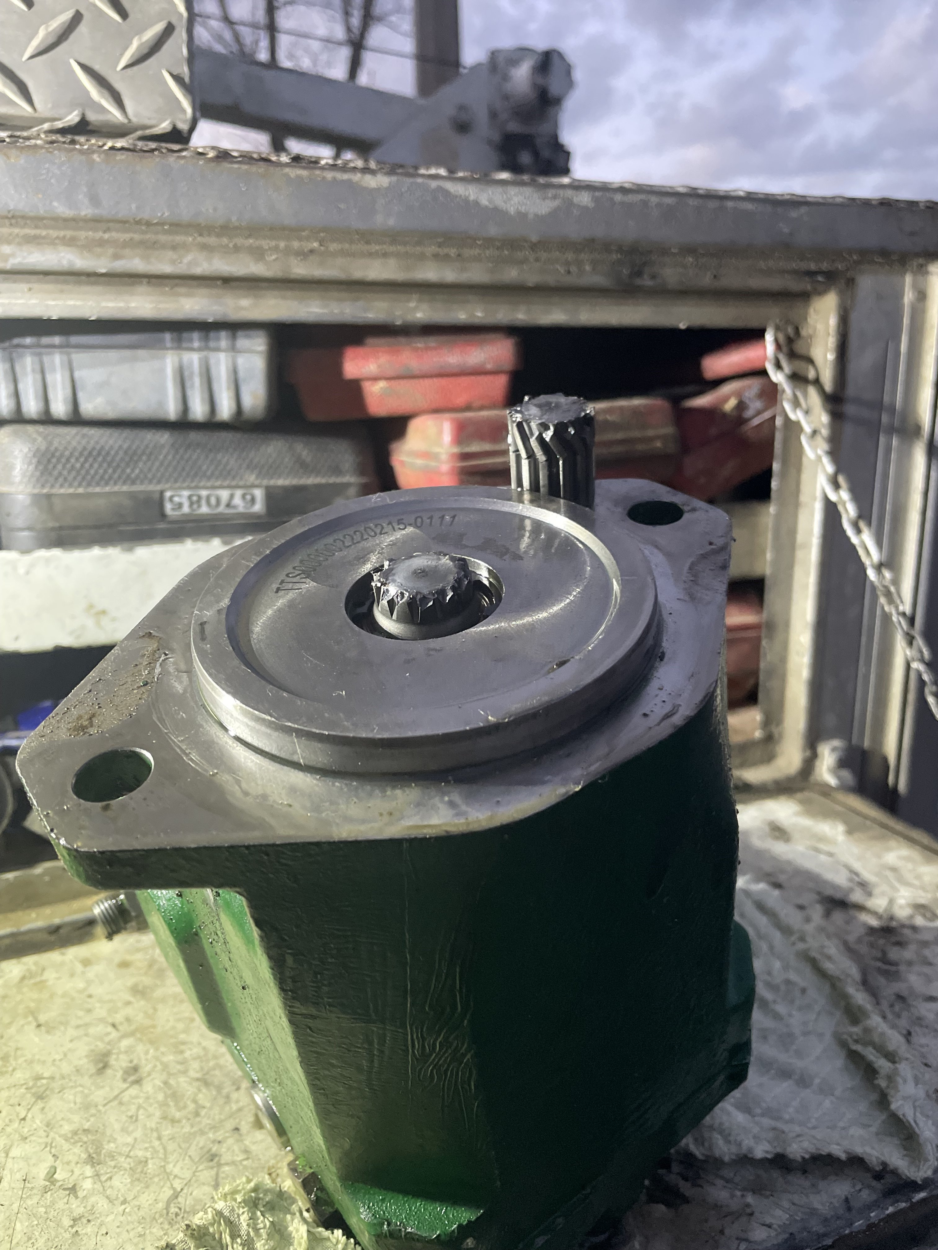

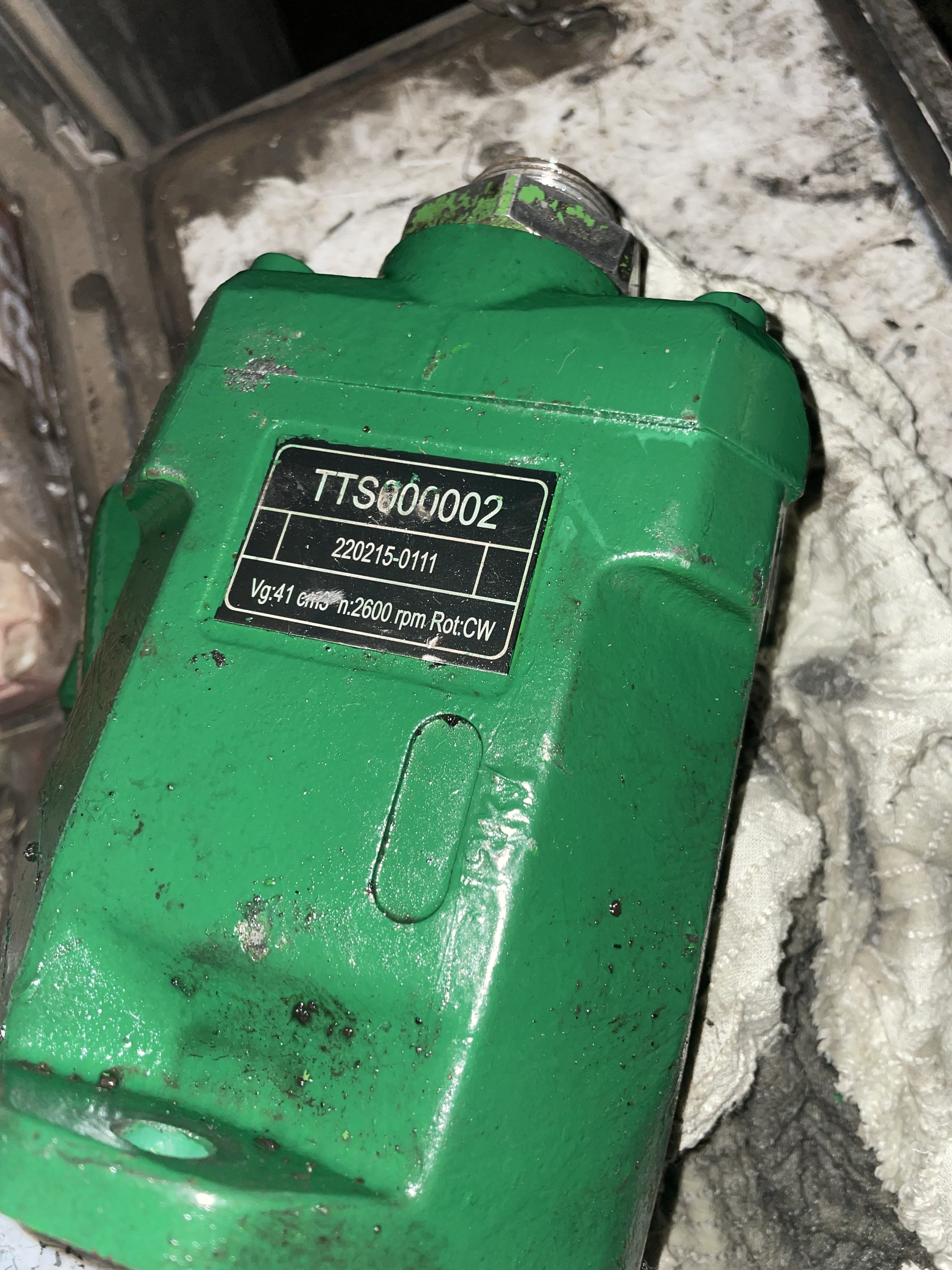

Found a problem, why would it twist the main shaft off like this unless the destroking valve didn't work and send the excess to sump, there wasn't any signs of deadheading, engine never pulled down, just about POP while idling, I oiled pump prior to installation as to not run dry, but she's locked up internally,
Pretty sure that is an open centre pump . Open centre systems do not destroke . They pump full volume all the way around the hydraulic system . Then the oil returns to sump .
The system builds pressure when flow is forced into a load such as a hydraulic ram .
Should the system pressure exceeded max rated . A reload valve is supposed to open and divert flow to the sump .
What pressure does the relief valve lift at ?
