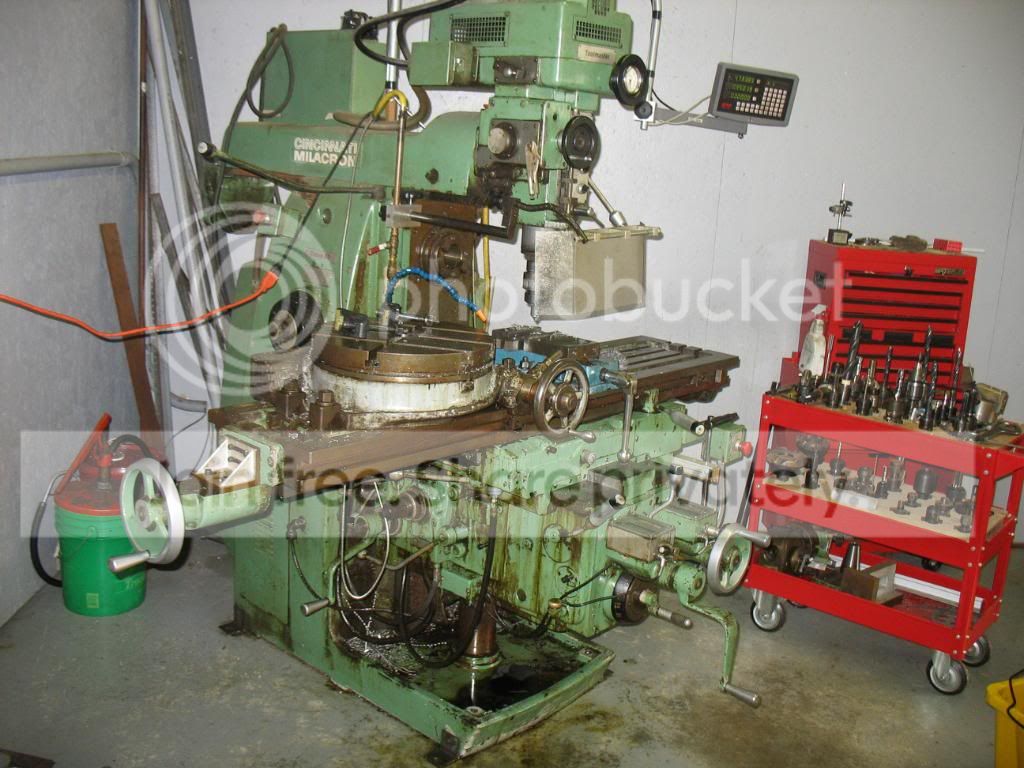

China produces some really fine manufacturing technology and they are rapidly challenging other countries for that market. I recently acquired the SINO 3 axis digital readout you see on the top right of this picture of my my mill. It along with three glass linear encoders for the table were purchased direct from a distributor in mainland China and were shipped direct to my home. Cost for the system was $350 and shipping was $125. That same system is around $800 from domestic resellers. An equivalent US or European made system would have been close to $2000.
The SINO encoders have a resolution of .00002 and the DRO reads perfectly without any signof skips. I have milled small (6") test pieces to check the accuracy of the DRO/encoders and the error is so small I cannot measure it with any instrument I own. It has been on the mill for a little over two years and the only problem I have had with it is one damaged encoder - I crushed the 60" horiziontal scale against the column on the mill when I overshot on a fast Y-axis table traverse :oops: :oops: I emailed the distributor and they promptly sent me a replacement encoder - $150 total. Cost of a replacement domestic scale that length is over $1000. The only downside so far is the manual which appears to be written in Chinglish by a British educated author so you have to work some when reading it :roll: :roll:
