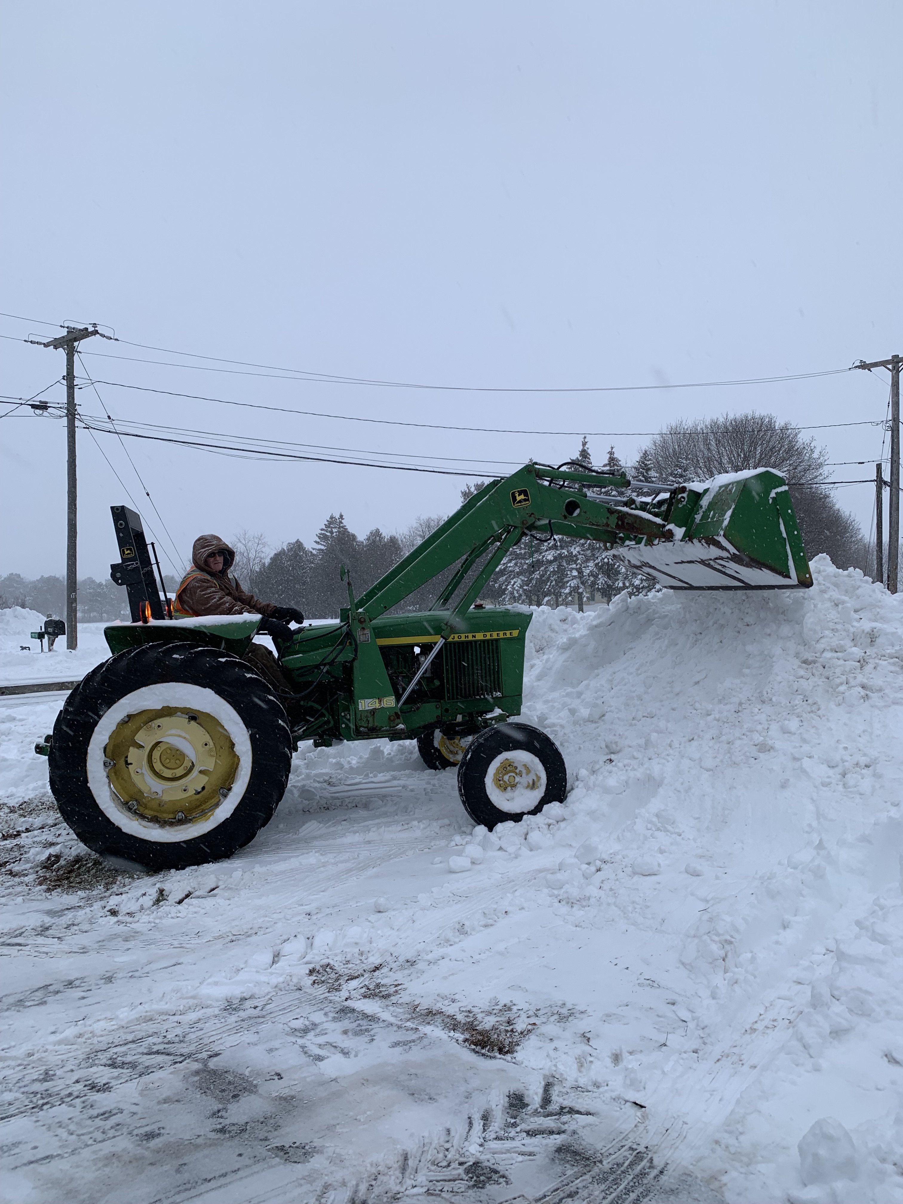

This 2020 HU rowcrop has been a great tractor. I have a 146 loader with a 90 inch grain bucket, loaded 36 tires, and handles heavy snow 6 months of the year. The rest of the year I use it with a 5 ft bucket and other various accessories.

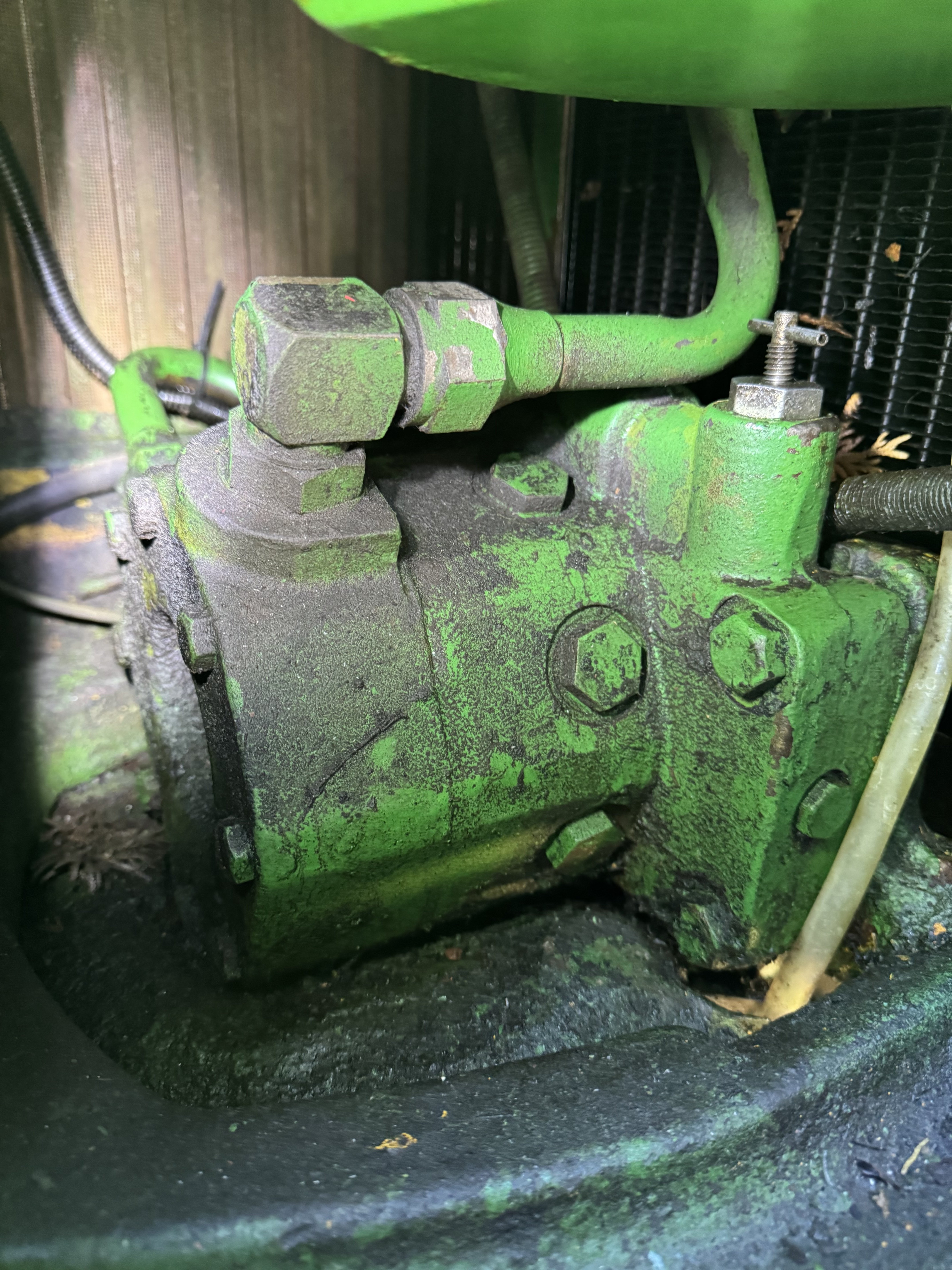

They don't show it in the partsbook like they do in a 3020 partsbook, but like Tx Jim said he needs a picture of your pump to see what pump it has to see if the destroker will work.
The manual Destoker works great.
Unfortunately, it’s my old fingers that don’t work well anymore in the freezing cold of winter. A retired JD service manager suggested I try and find an electric one they used to stock for the New Generation tractors.
Another option is drill a small hole through flat sides of hex nut then remove roll pin install nut on destroking then reinstall rollpin through hole in nut & DS screw shaft. Then as Hay maker2 suggested utilize wrench to turn nut
