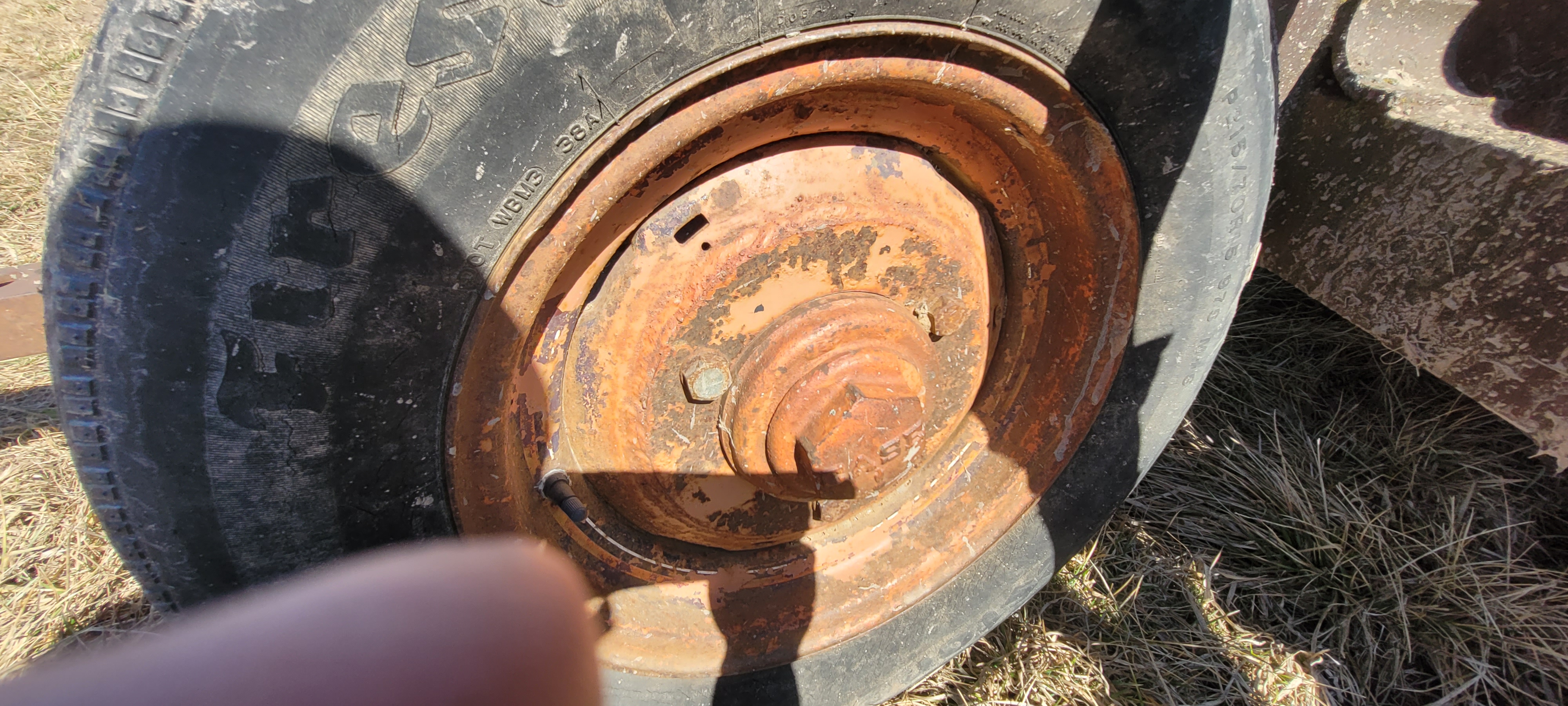

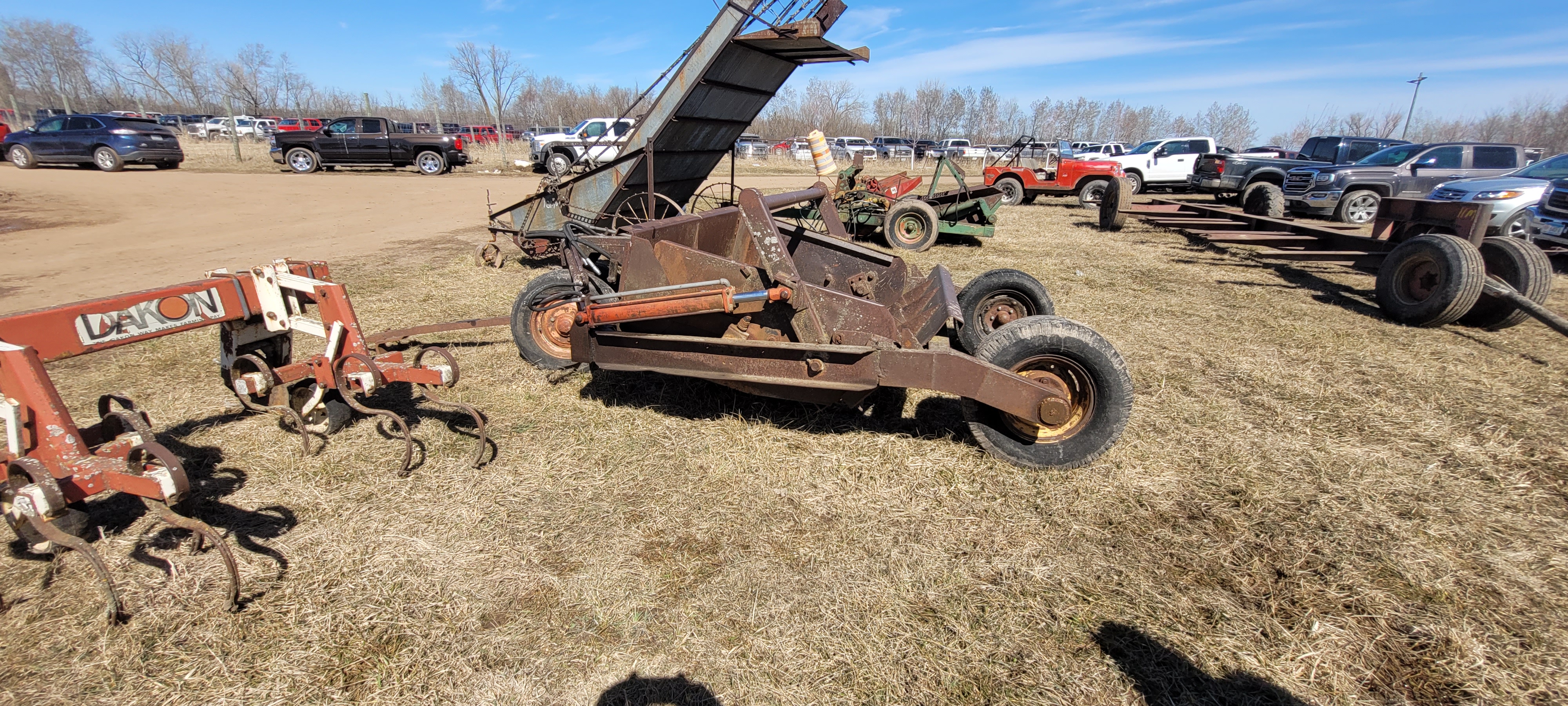

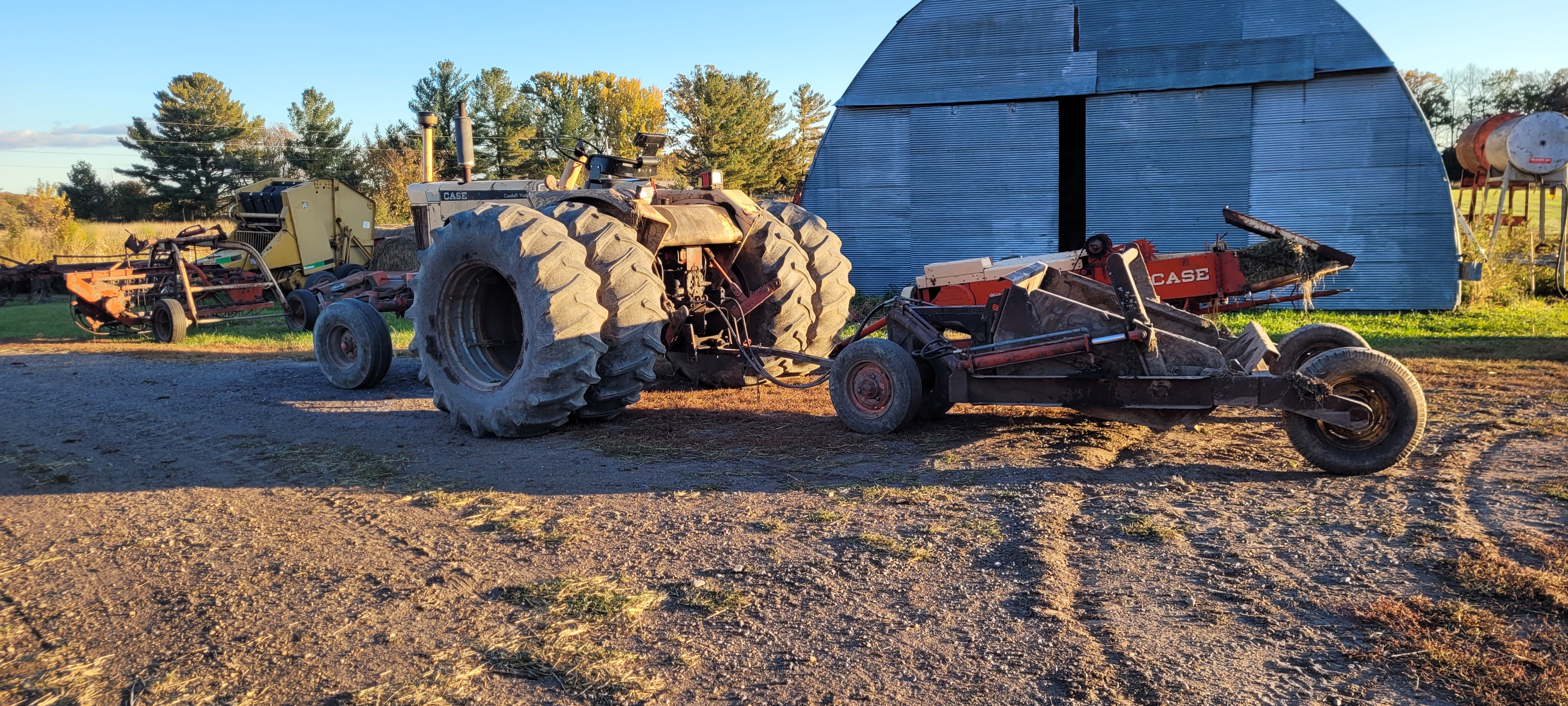

Last spring I bought this scraper, I think it's a case but haven't confirmed it yet. It has case hubs on it for sure.
This weekend I finally had time to use it. In spite of it being the most busted up and repaired piece of equipment I've ever seen, it worked good. Had it hooked to the 1030.

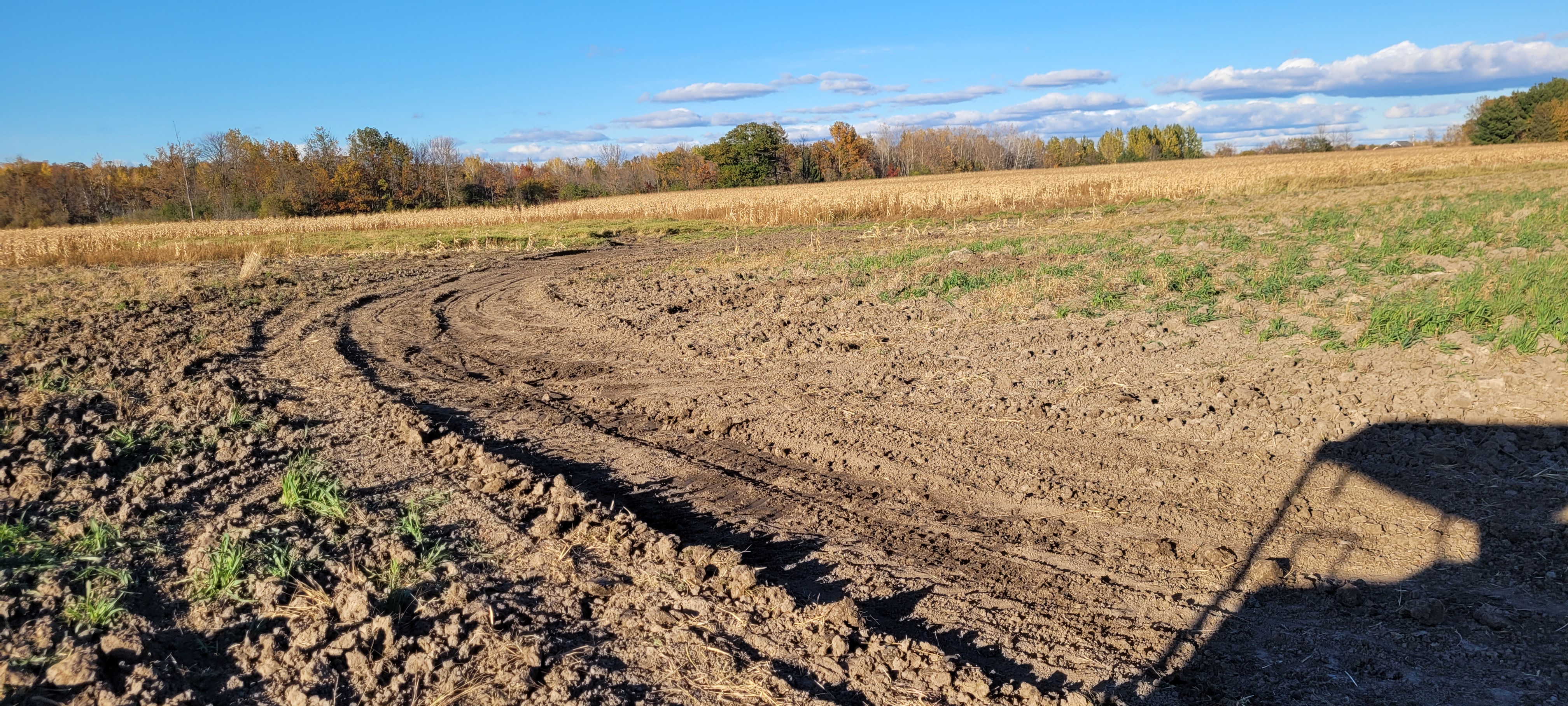

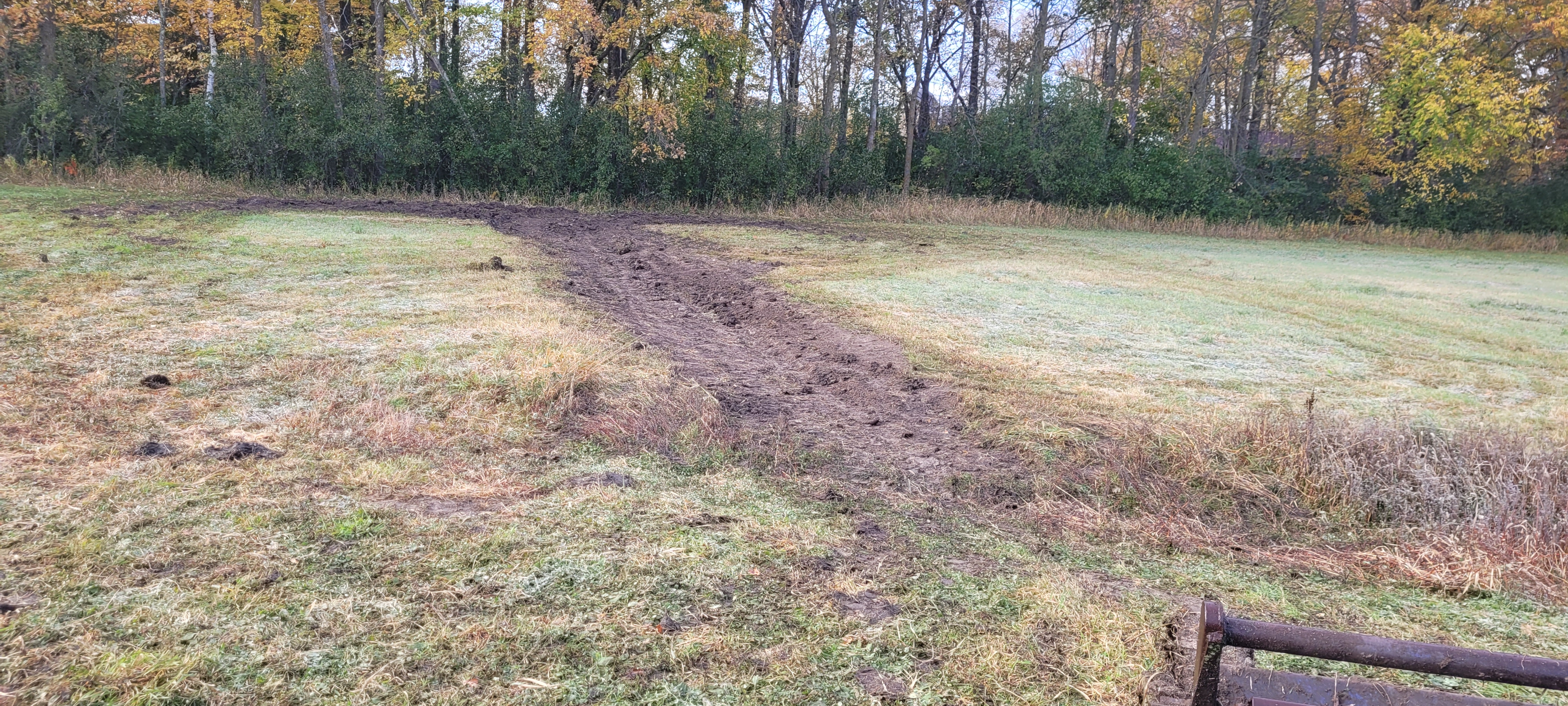

Did this short ditch first to drain the wet spot by the trees, it's where the neighbors sewer drains so is always wet and had developed a low spot. Put the dirt in the low part and made a ditch to drain it.

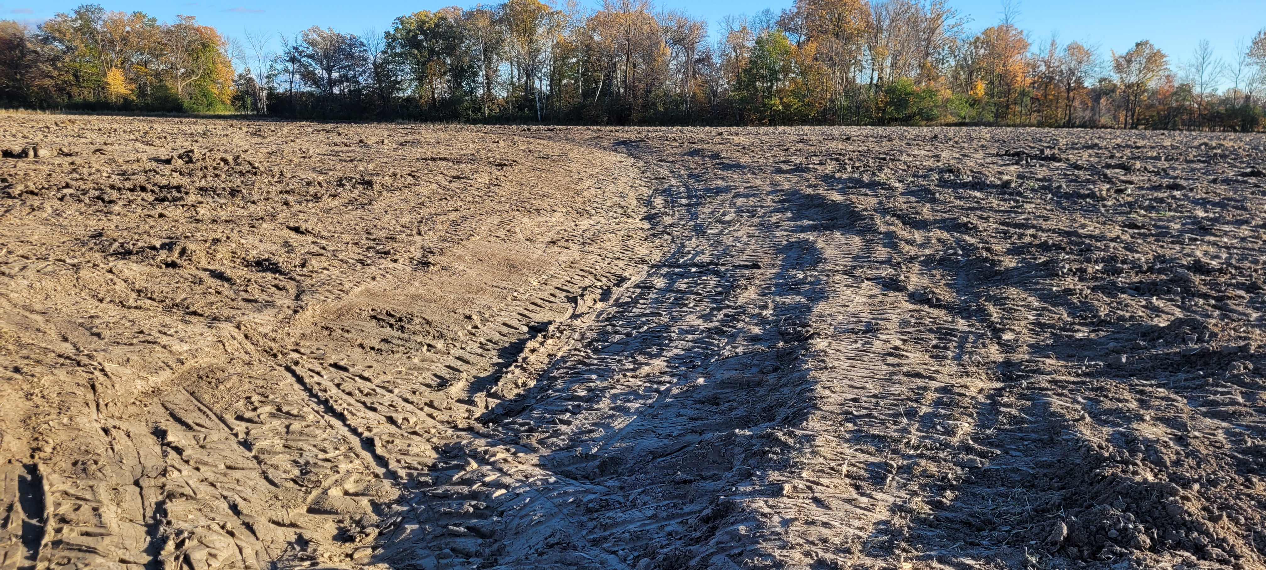

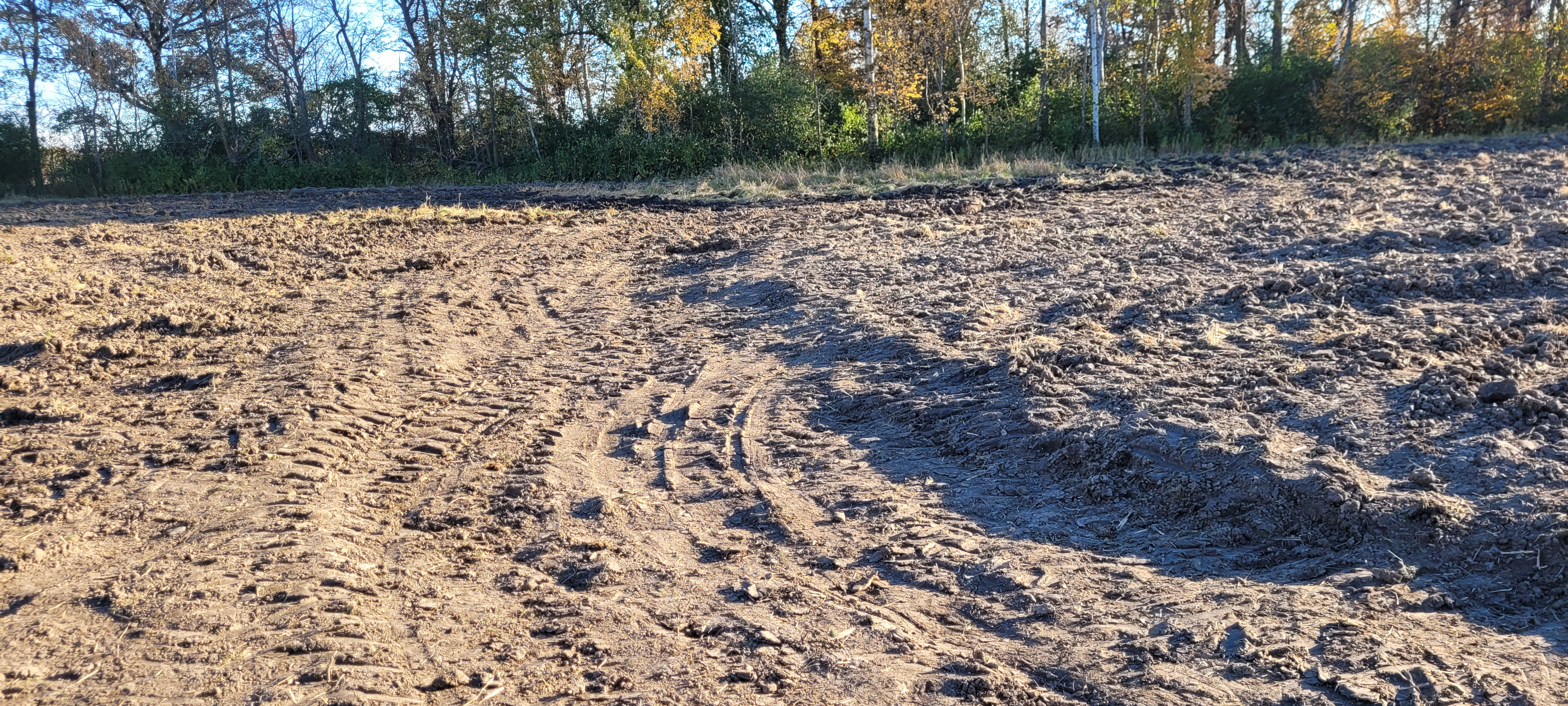

Then went on the the big ditch. The part along the trees has a spring that feeds it and is always wet and I've never been able to farm it. I'm hoping this will drain it enough now that I can farm through it. It was still too wet to get all the way to the trees, but should dry now so I can finish next week.

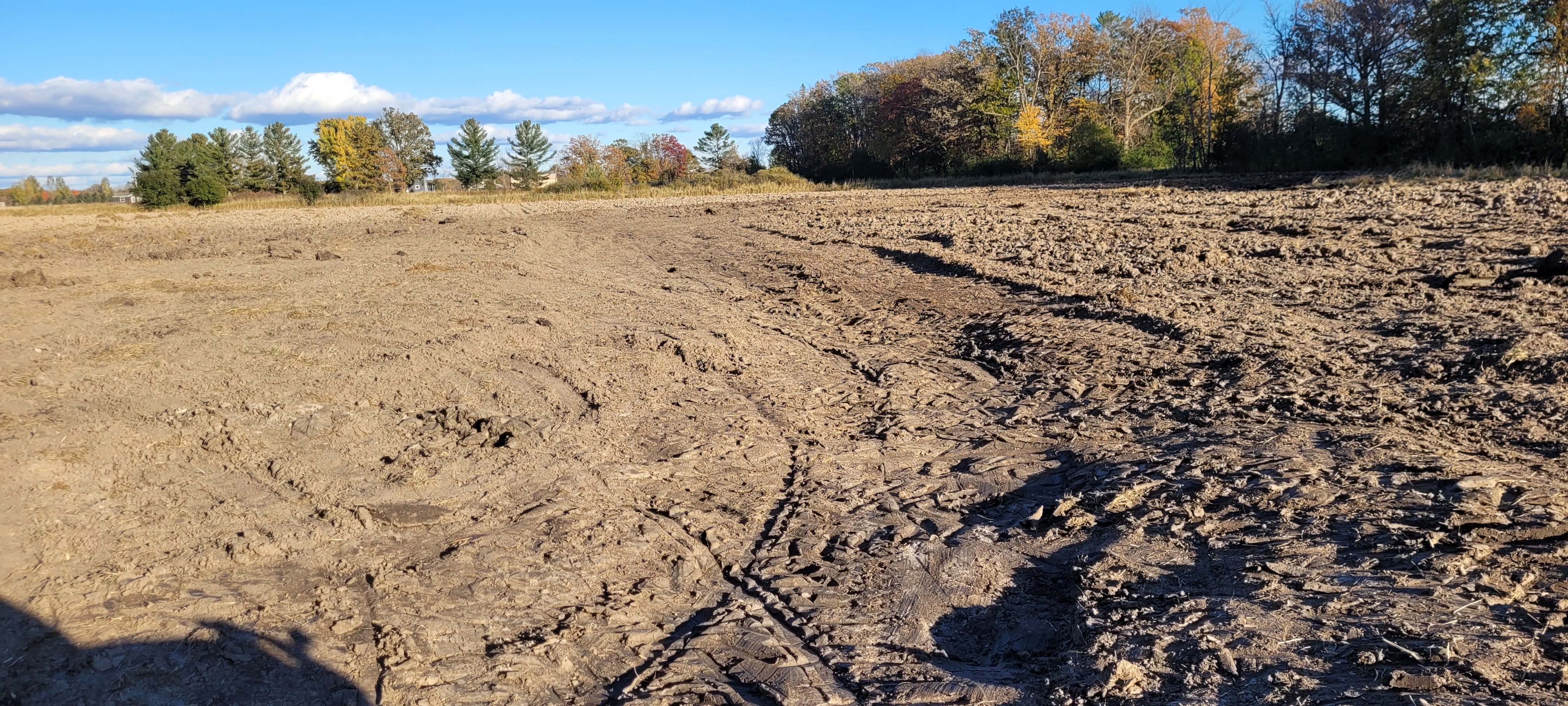

More progress further along. This ditch snakes along diagonal through the field and was about 1/2 mile long total.

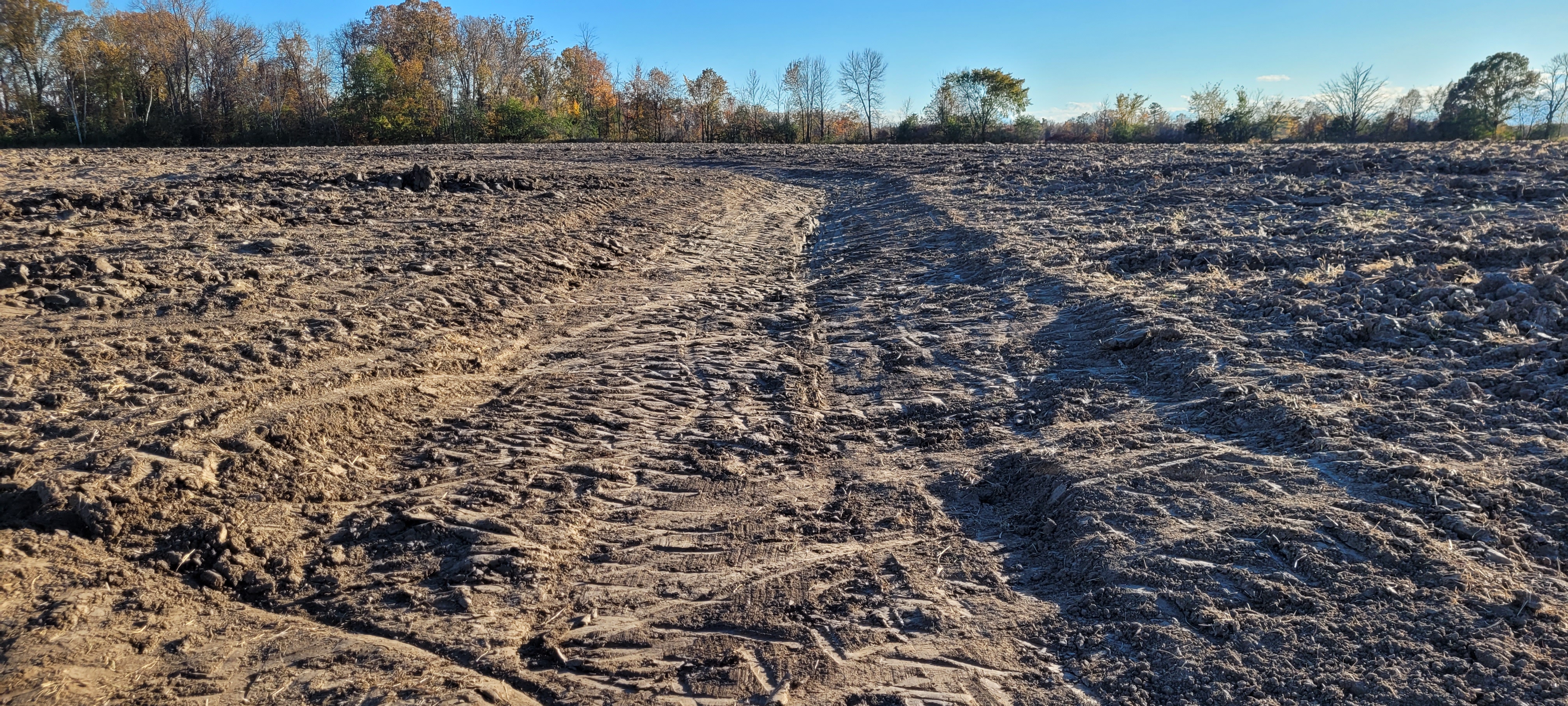

This is the deepest part and is about 3ft deep.

by the way Jon looks good, I like the scraper and 1030, but I am a little partial to 1030s, run a light disc down them to even/smooth stuff a bit and you have a great waterway!

Just one comment on the ditching. You may want to widen out that deepest part a bit and try to flatten the bottom a little. Having a V bottom waterway can lead to it eroding if you get a heavy water flow.

hard to tell with camera angles but I would try to make that something one can farm through, make the slopes smooth enough. It doesn’t look like a big area or a lot of fall so it shouldnt wash out. Gully. Again, based on here in my back yard, might be different there. :)

I doubt it will wash because most if it is near level
