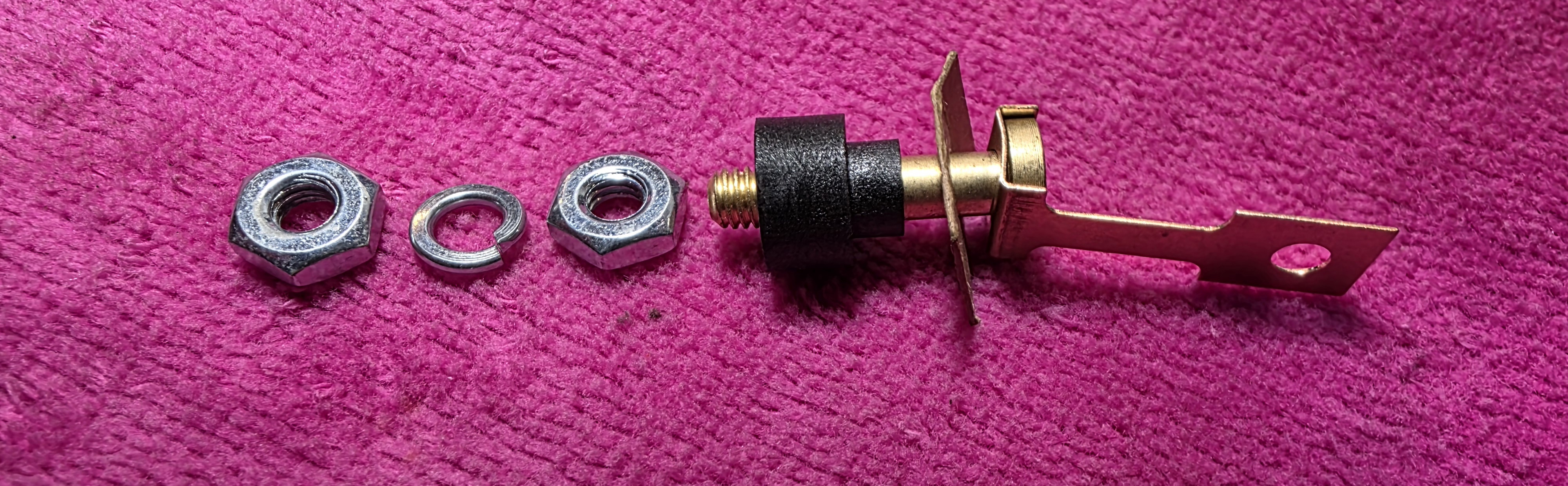

My 52 12V 8n dies on me for some reason. It'll be running just fine then suddenly die, no sputtering then dying, just dies. If I run it at higher rpms, half throttle or higher it seems to not do this. I've replace the ignition switch, the condenser, and the fuel filter. On the fuel side, I've pulled the hose at the carb and I have a steady stream of fuel. So what should I try next? Thanks.
Next time it dies immediately check for spark. The best way to check for fuel flow is to remove the bolt at the bottom of the carb bowl and check for flow. Your method will not rule out a sticking float or needle valve. But, check for spark first.

On spark, the primary terminal on the distributor has insulators that can fail intermittently, so primary grounds out, or the copper strip cracks or touches, killing spark.

One like that can be hard to figure out sometimes. If it where me I'd hot wire it and run it and if that works and it doesn't die then you have a wiring problem. If it still dies you have a carb problem/fuel problem
I would look again carefully at both the coil and condenser. Either can cause this type of stalling failure when hot due to breaking down while under load. Many condensers now days are bad right out of the box.
My ‘52 8N did exactly the same thing - I chased down phantom fuel issues until it was DOA. Changed the points and condenser in the field and it is still running fine five years later….
Whatever it turns out to be, you will find it. Remember, change only one thing at a time.
