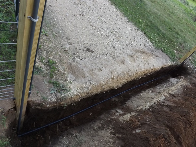

I had to run PCV and wire under the driveway for electrical fencing. The trucks are too tall to place it overhead.
24-inches down, even though our code says 18-inches minimum.

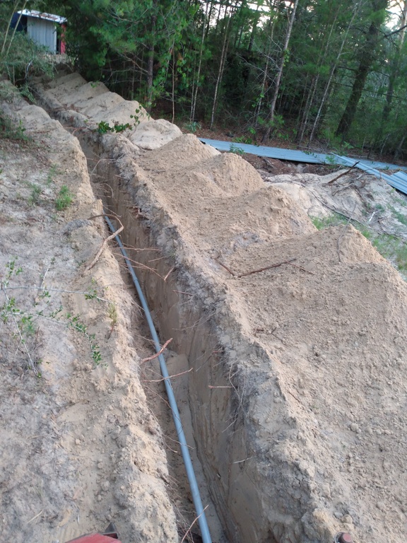

When I did 120' to my barn, I rented a trencher and went 2' deep through a yard a concrete truck with 10 yds. on wouldn't leave ruts. Only took an hour and very minimal mess. Or you could get one of these (I got this long after the electric was run). Either way you won't regret it.
