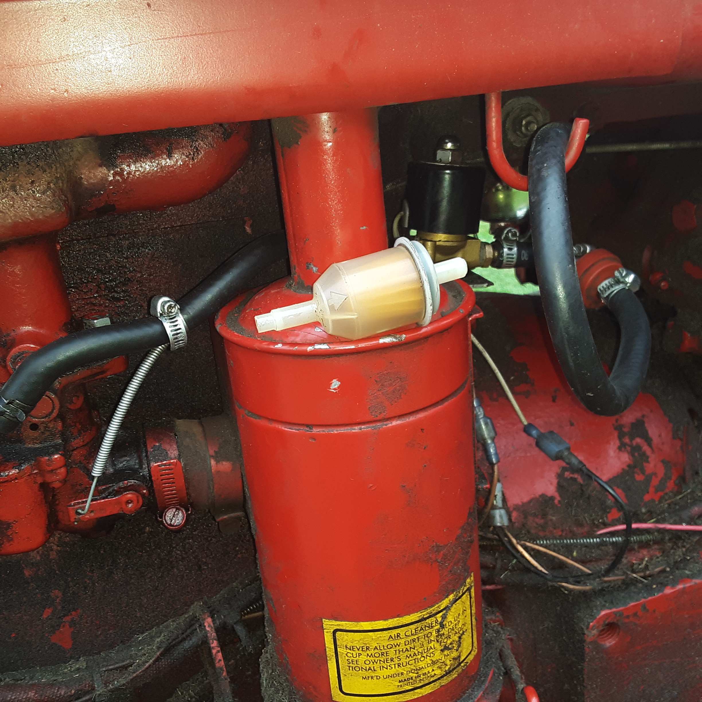

No idea why the cardboard inline filter wouldn't work on my Farmall C
I bought the red round filter used on lawnmowers. It is just a screen filter.
That worked just fine.
If the fuel lines are rubber that option works great but a lot will be metal. Screen as part of the sediment bowl that sticks up into the tank is usually the best bet at that point
That worked just fine.View attachment 7172
