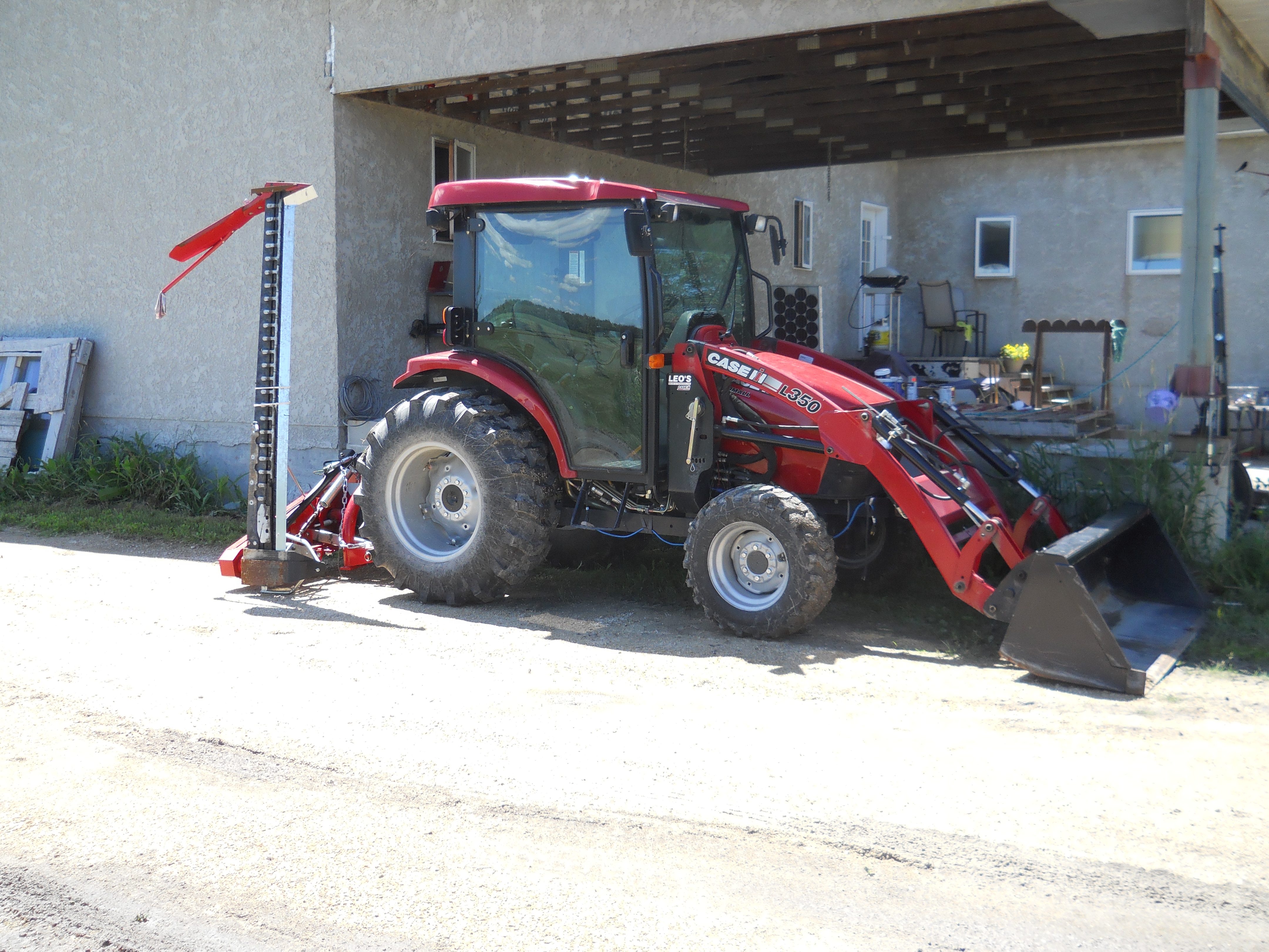

Sickle bar mower, 3pth mount works for me. No complaints other than it takes a bit of effort in mounting it. Hydraulic up/down, breakaway bar, angle up or down, cuts fast, cuts up to 1" dia. Mine is a newer model with 7' bar. The other nice thing is cuts grass so you can rake it for hay.

Sickle bar mower, 3pth mount works for me. No complaints other than it takes a bit of effort in mounting it. Hydraulic up/down, breakaway bar, angle up or down, cuts fast, cuts up to 1" dia. Mine is a newer model with 7' bar. The other nice thing is cuts grass so you can rake it for hay.View attachment 98933
Interesting... And you find that it can cut some vertical brush without damaging the cutters? Was it originally set up for the bar's angle to be hydraulically controlled, or did you do that? We have a Deere 350 mower, that perhaps I ought to see what it would take to get that to work. Thanks.
A sycle bar mower Will cut anything that fits between the points on the cutter bar if you go slow enough. If you mow with it in the vertical position, remember the safty breakaway doesn't work in that position.

If you don't have a lot of thick woody stuff to cut, that newer sickle mower with a hydraulic bar lift is a good idea. I don't think you have enough tractor for one of the side-mounted rotary (Bush Hog style) mowers. There are some smaller side flails that would work. I think Ferri is one brand. I highly suggest making a cage for the fender on the flail side of an open station tractor as they have been known to throw stuff and break cab windows.
Yes bought my sickle bar machine a few years ago, before that I had an 'antique' semi-mount JD sickle mower with a rear wheel, that worked well too but not as manoverable as 3pth, had a pitman drive stick. That stick would break at least once a year. Sold the tractor it fit on, so that mower went with it. I have a 3 pth rotary mower too, strictly for 'lawn care'. Guess what, the sickle bar works just as well for lawn care and I'd say uses half the horsepower at way faster forward speed. Also, yeah it will cut bigger than 1", if you give it time to cut by going slow. The one I have came with hydraulic bar lift. I forget the model but supposedly Italian made. Came with an extra cutter bar. When I hit something, rock, ant hill, the bar breaks away undamaged and all you do is drive reverse to reset. No need to get off the tractor. Keep any dogs and children well away from the machine!!!
