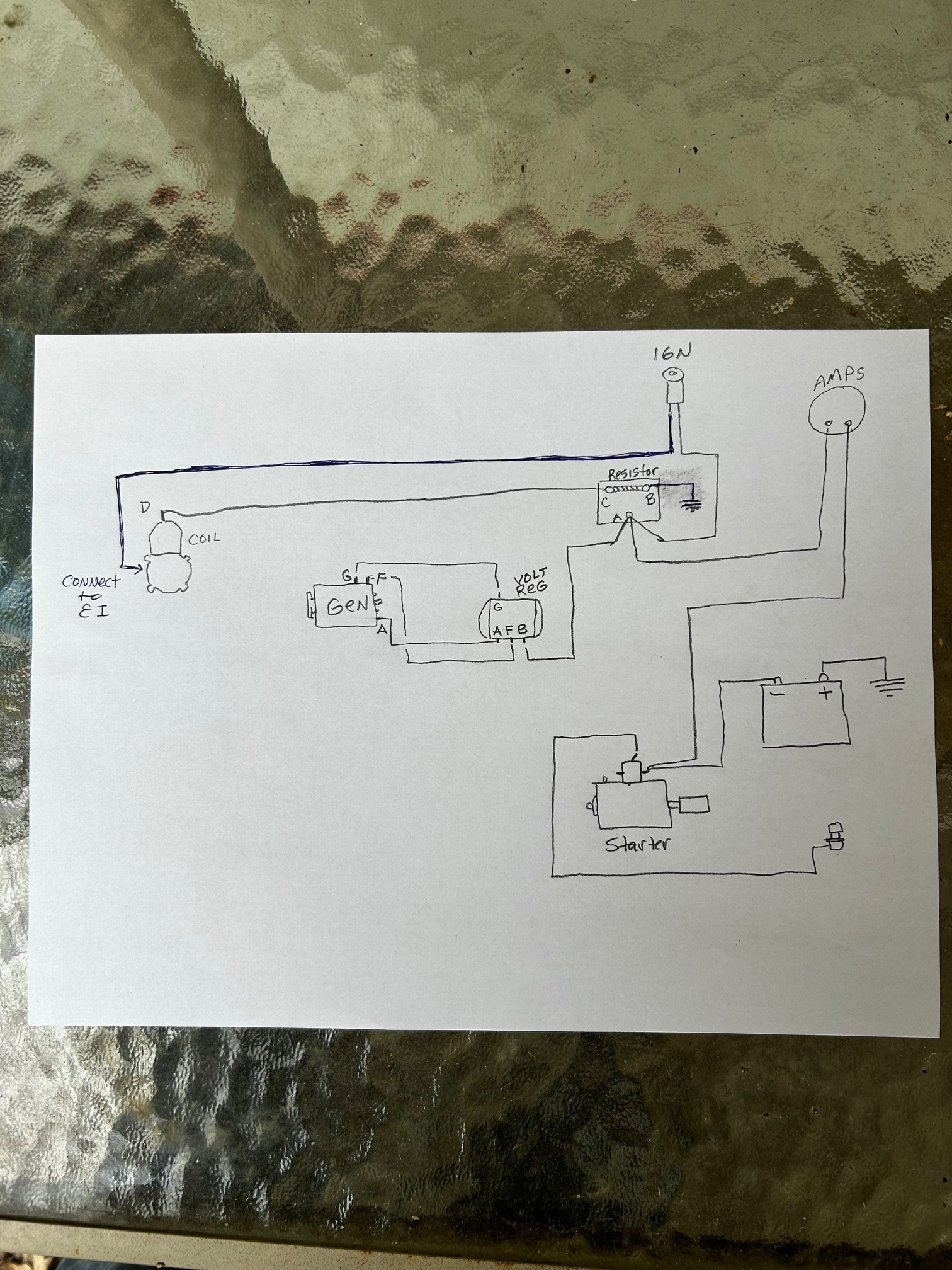

I apologize for any confusion and for this rather crude drawing I made, on it is what I'm suggesting I can do. Given that JMOR's drawing on his schematic sez I can install resistor AFTER the coil. All I did was remove the ign wire from resistor block B and connected with EI unit. The connection from top of coil to resistor was already there (OEM set up) but then I made an additional connection from resistor B to ground.
To be really clear, draw schematic, take picture of same & post it.....better than words! Or just follow Pertronix installation instructions & save "words" & "mis-spoken".

Looks good to me and fits Pertronix latest instructions! Good
I got a more reliable reading on the coil-1.1ohms. Just so I'm clear, if the EI kit calls for only .7 ohms, I should be good to go without any added resistance?
You arranged it with a minimum of wire crossings. Very nice. You should go work for Helm, Inc.
The instructions for the Pertronix part number 1247P6 which is for 6V positive ground posted by JMOR seems to me to be as explicit as it gets.
It says:
The minimum primary resistance for the igniter is 1.5 Ohms. This is the resistance of the coil and ballast resistor combined.
It says to use suppression core spark plug wires.
When it comes to wiring it has a diagram showing the black/white wire to the concave screw where the "pigtail" of the coil sits. The black wire to ignition switch (-6V) and the top terminal of the coil to the OEM ballast resistor, the other end of the OEM ballast resistor to +ground.
It does not say anything about using a 12V coil on a 6V system. It says if using a 6V coil on a 12V system additional resistance is required and it is better to just use a 12V coil in that case.
I do not see anything VAGUE about it.

DTB, what is vague is I have a 6V system, which begs the question- can I use a 12V coil? and if so what resistance is needed?
Also, and not for nothing but when talking with the Pertronix tech, he did say the primary resistance that is required is in the coil, not the "wire resistance" that you get from the ballast resistor...but that's another can of worms I'm not sure I wanna open.
