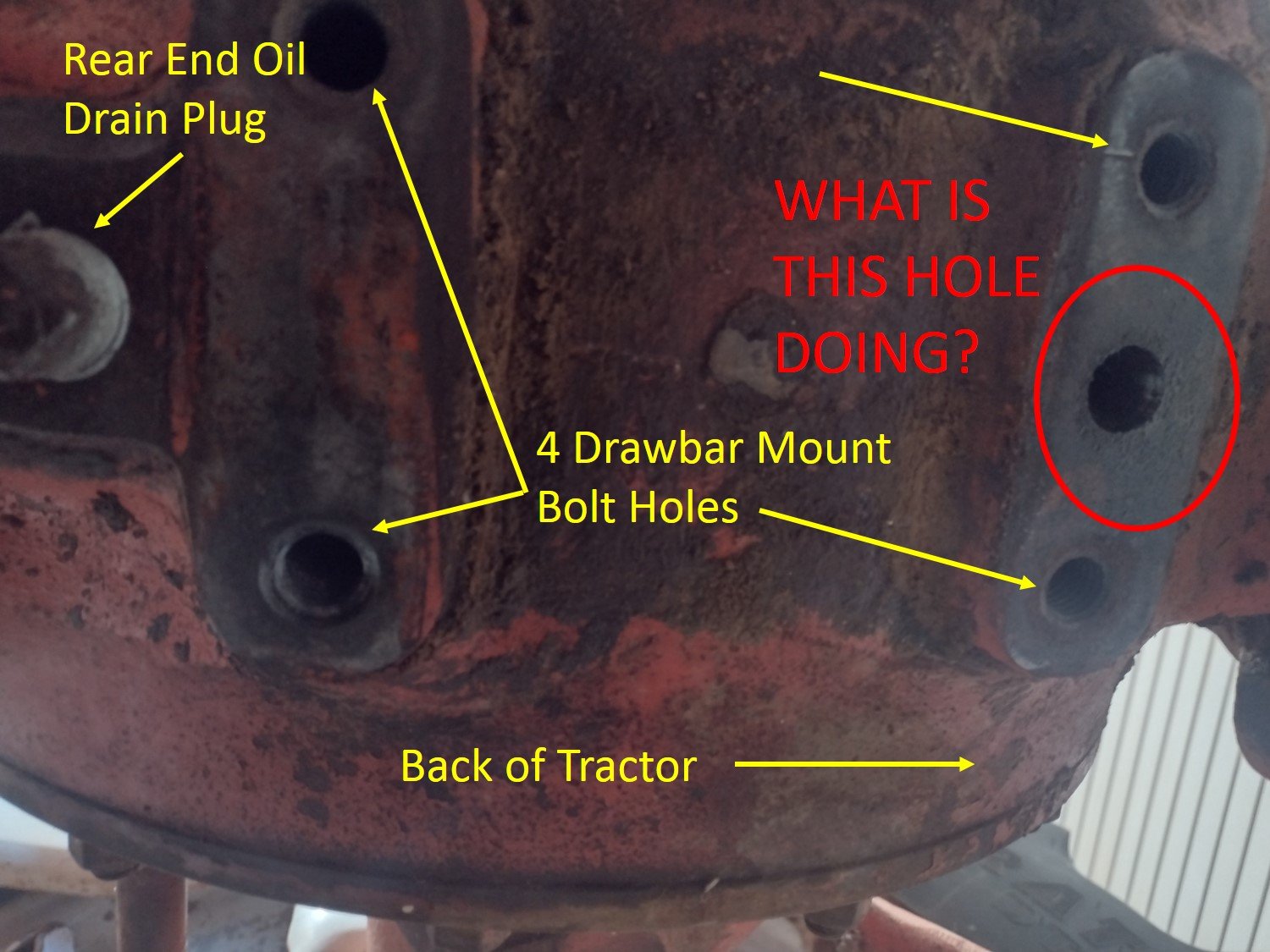

Second, referring to the photo of the underside of the rear end where the mount is bolted on. Removed the four bolts which was such a pleasure after 50 years of dirt and oil caked all over them. The mount came off and I was surprised to see five (5) holes, rather the the four (4) bolt holes. The fifth hole is in the middle between the two bolt holes closest to the rear of the tractor. That hole is sort of countersunk – tapered smaller towards the top of the tractor. What the devil is that there for? Should I do anything before putting it back together?

It is obvious that the right front hole has a helicoil in it, so I will go with they got loose and the threads got buggered so at one point they tried adding another bolt.

Not to argue, but why not this is YT! I can’t pull enough resolution when blowing up his photo to convince me the right front hole (lower left in his photo) has a Helicoil. It looks to me like the first few threads got pulled out of the casting. But hey, I might be wrong been there before. Only the word of the owner or a better photo will tell us.
To the OP: If you have a tap that size run it in the holes, if not if the bolts go in fairly easy squirt some penetrating juice on them and run them in and out a couple of times. Then use some brake clean to clean the holes and threads, apply some blue lock tight and assemble it tightening them down appropriately.

Showcrop: I was kicking myself for laying under that tractor for over and hour without seeing a helicoil, but when I got under it this morning there is not one there (see photo). But you had a brilliant theory about that and drilling a replacement hole. I wouldn't have thought of that myself. Good reasoning, bad photo.

used red MN: (I am seeing an "MN" trend here -- haha) You're correct about the previous photos, maybe these are better. The holes are pretty clean. After the initial break out torque the bolts backed out pretty easily but I will clean the holes before reassembly.
I've also included a pretty good close-up of that hole in the middle of the back two bolts. It's not a partially drilled hole, although that did make a lot of sense. It tapers down then is straight about 1/4" diameter and maybe 1/2" deep. It doesn't appear to go anywhere. Any ideas?

My extreme SWAG is that tapered hole had to do with being a location hole for a factory machining locator and/or a mount pin for the assembly line fixture for the housing during the building of the tractor.
You can take or leave the Loctite suggestion, it is just what I would do if I had a concern with them coming loose.

used red MN: I wouldn't have thought of the tapered hole for that reason but it makes total sense. Thanks for the tip on the Manufacturers section, I'll try to find it next time.
