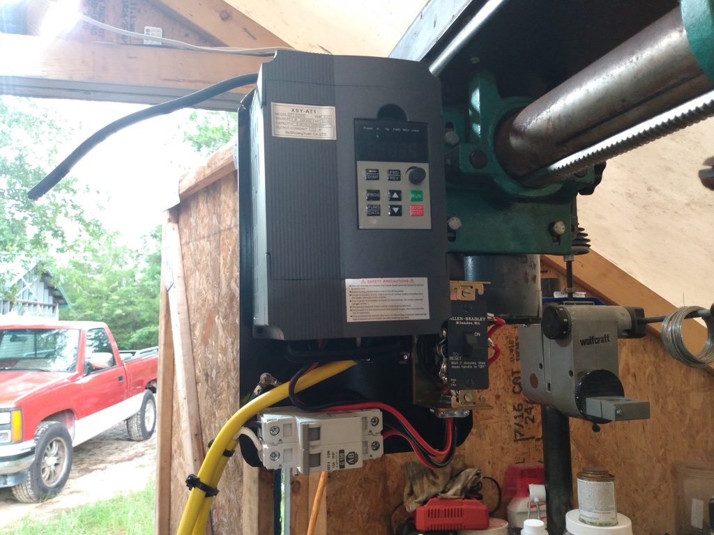

I put a 1hp 3phase motor wit a Varible Frequency Drive on my old Grizzly drill press. Fully reversible and speed control. Runs off of 240 volts, but you can get VFDs that run off 120 volts also.
Interesting that there is a 600T manual starter w/overload behind a pair of SP1D breakers feeding what is presumably the line side of a VFD, which should have its own current limiting and ramp parameters. That's belt, suspenders, AND velcro all in one pair of pants.
