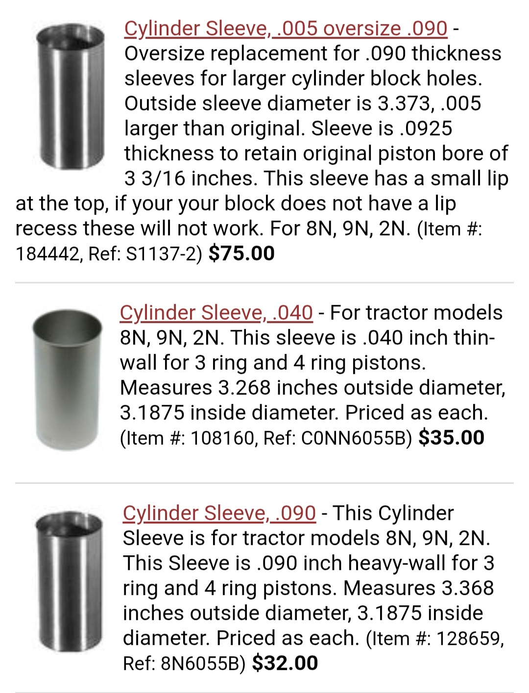

.040 sleeves came with early 8ns with a star shape preceding, and then following the serial number.
Ford changed the symbol to a diamond on later 8ns designating .090 thick sleeves.
.040 sleeves dont have much of a flange.
Blocks are .001" less than the sleeves, so they should not just drop in.
Many use modern sleeve retainer to "glue" if not enough interference.
Here are our host's listing, with dimensions.
