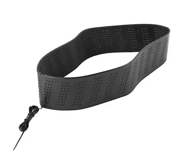

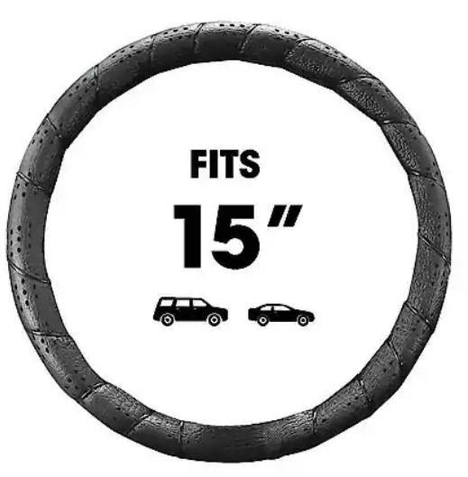

I would like to know if you have ever found the secrut to keeping them from moving as you are trying to drive. I never could that is why I junk them as soon as I would get something with them on.
Nope, they'll scoot around some. AND the tractors I have them on have power steering with spinner knobs. I don't have to horse the steering wheel around.
