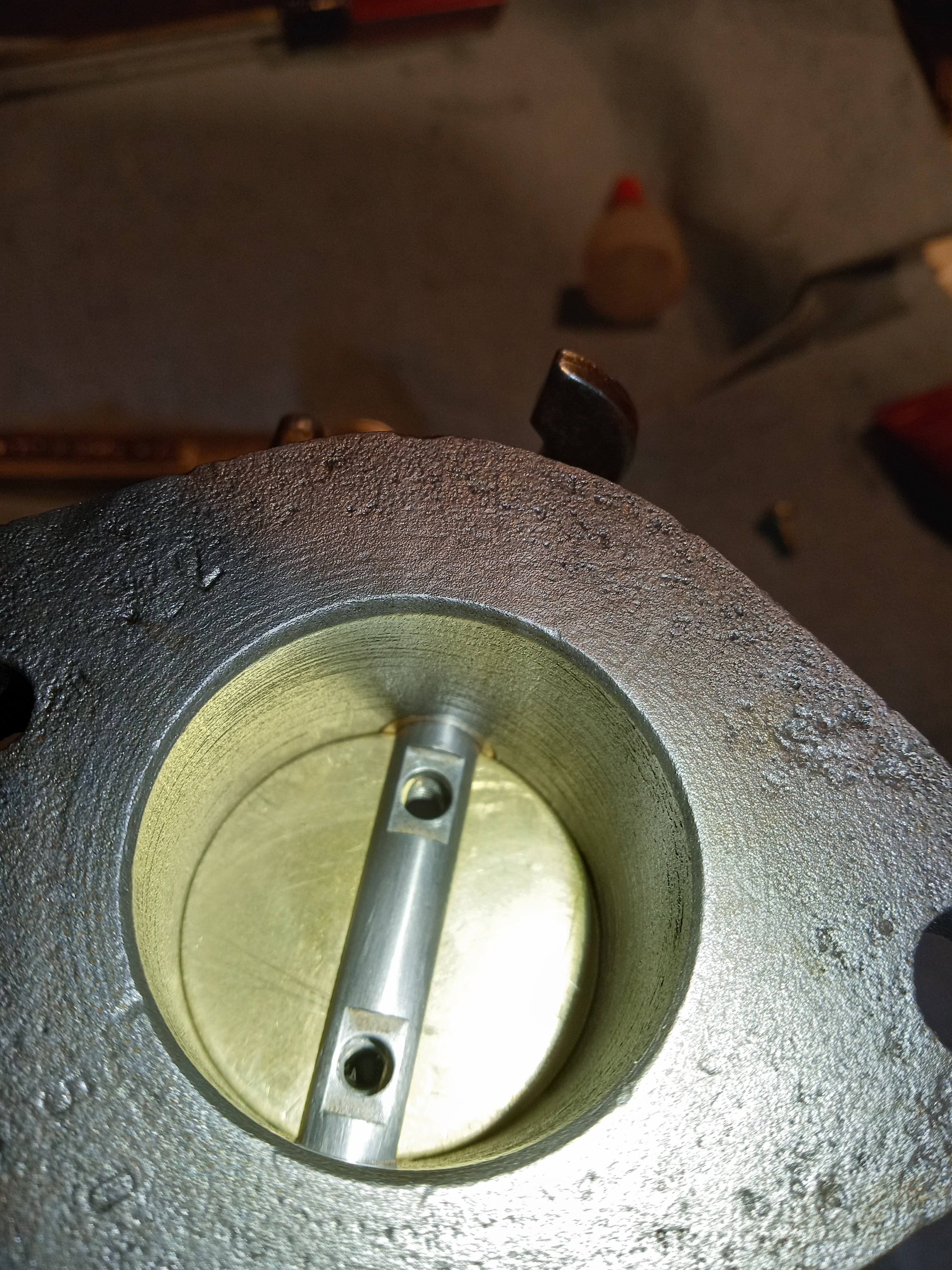

Hello folks,
Sorry to be a bother, but how hard is it to rebuild a DXLT 71 carburetor? My only carb rebuild experience was on an SU from an MG midget. Are there any specialty tools that j need to look for?
Also , is there a recommended vendor I should shop with?

Not too hard, you may want to get a video from Robert's Carb shop that shows how. Ron MN
Special tools I use are:
1/4" tap to tap threads into the nozzle and use a 1/4" bolt to remove it.
An adjustable reamer for reaming the throttle shaft bushings. https://drillsandcutters.com/7-a-hss-adjustable-reamer-9-32-5-16/
Drill bits
https://www.amazon.com/Black-Aircraft-Extension-Qualtech-Length/dp/B07BF5QZ8B
And I have a sand blast cabinet to bead blast the entire carb. If you don't have cabinet find someone who does and have them blast it.
Carb kits I've been getting from Marks Carb Parts on Ebay or Steiner tractor parts.

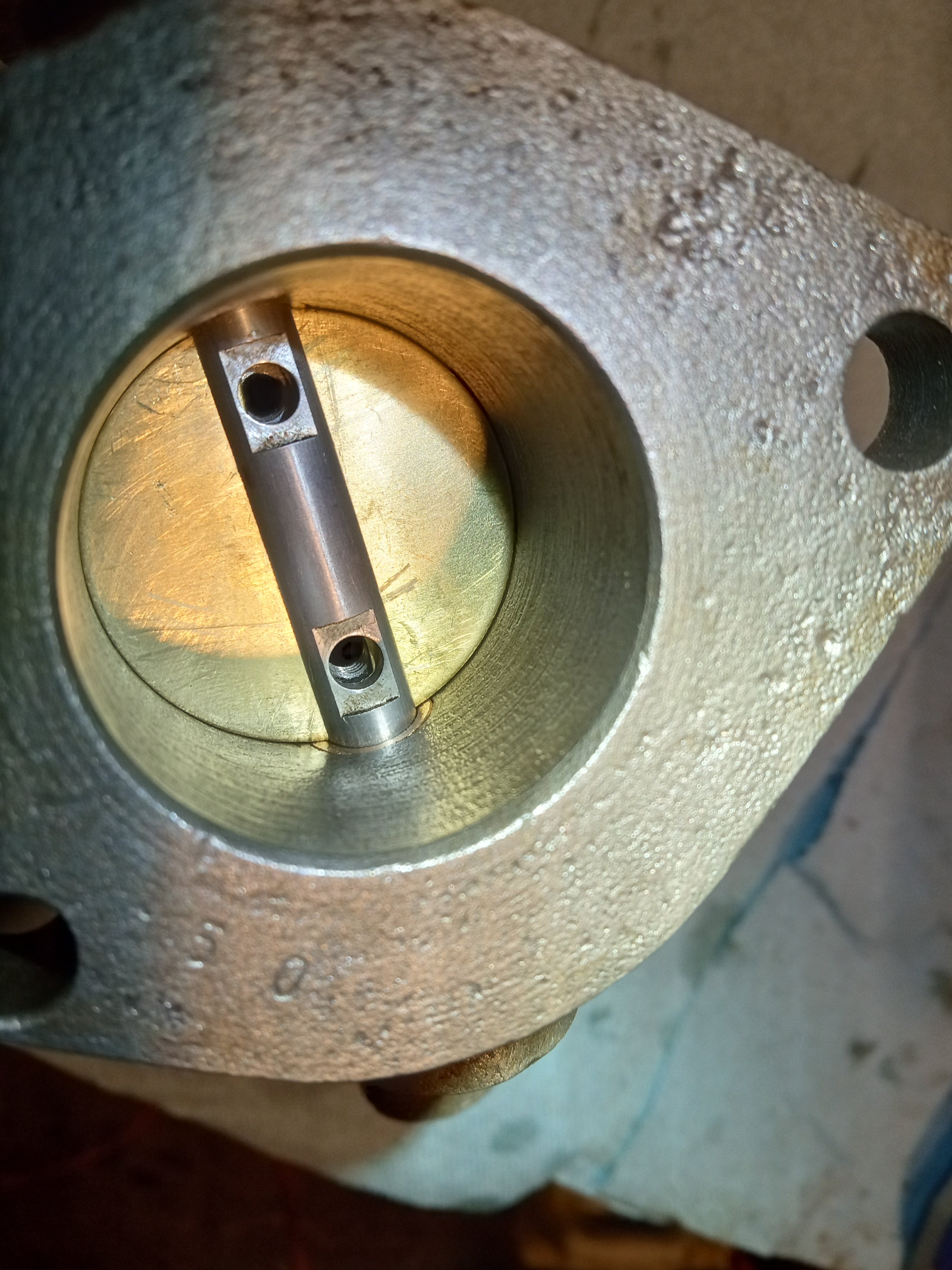

I rebuilt a 71 and 46 with parts from Roberts. The throttle plate will wear at the bottom due to its vertical shaft. Get a new one. With the new bushings it helps to file them flush with the bore or it will be hard to get it to idle well. A little heat with a propane torch will get the brass plugs to come out easier, just use a good screwdriver. I made a puller for the nozzle from a 10-32 threaded rod and nut.

I do something similar with the throttle bushings.
I push the bushings in further than they need to be and use a die grinder and flap wheel to shape the bushing to the same profile as the carb bore. Whether this makes a noticeable difference in performance I do not know.

I used a die grinder or Dremmel too. Didn't mention it because most guys don't have one.
