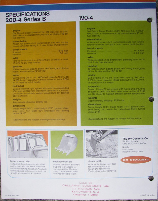

Since the 490 was basically an updated 190-4 here is a brochure page for the 190-4. It should give you an idea. Front bucket and shipping width was 8 foot. The 490 seems to be a couple tons heavier, I don't know where the weight gain was. Also a link to a sold 490 on Bigiron, has some good info and pictures.
Bigiron 490

I found my original brochure. Weight difference is because 20720 lb weight for the 190-4 doesn't include weight of cab.
