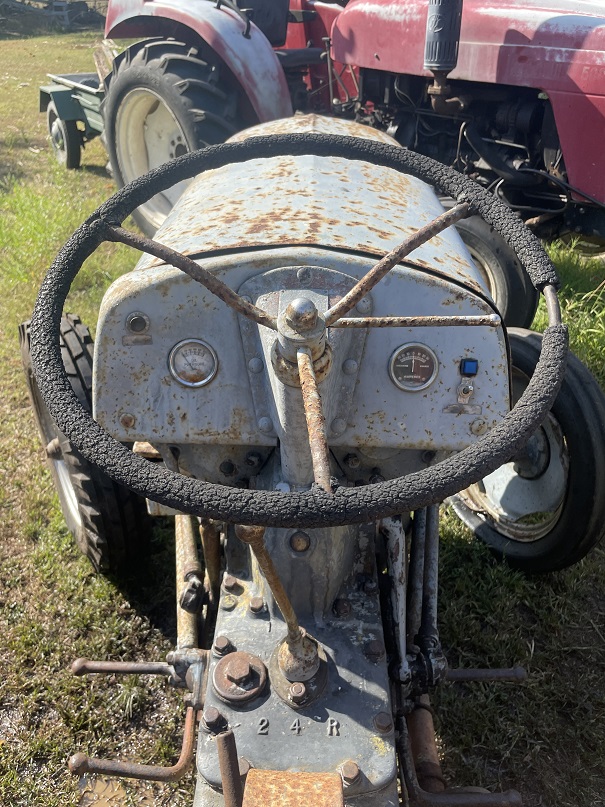

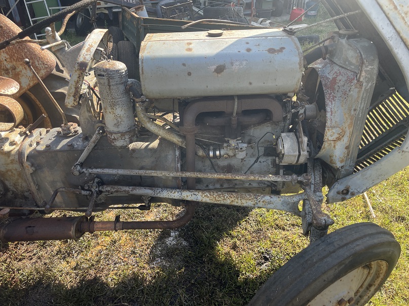

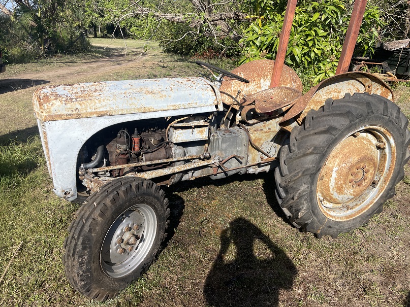

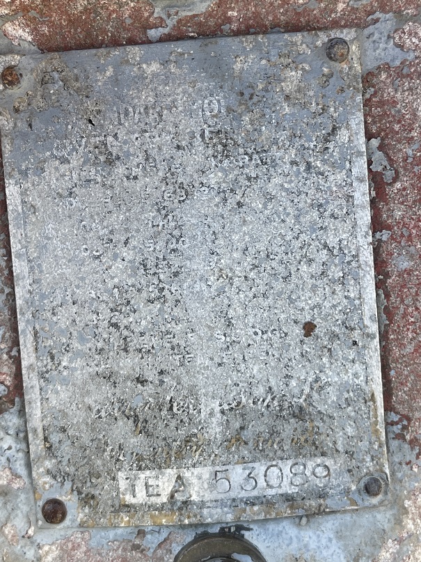

hi all, wondering if can get some help on exact year / model version of my TEA-20 please.
The name plate is extremely weathered, and I was only able to get the bottom line clearly legible after much careful scrubbing.

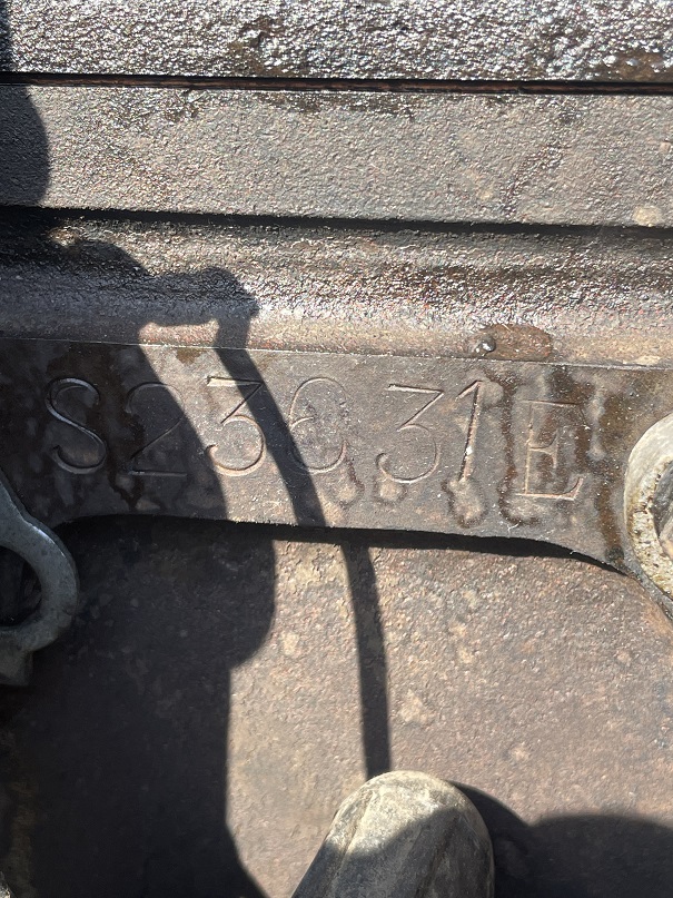

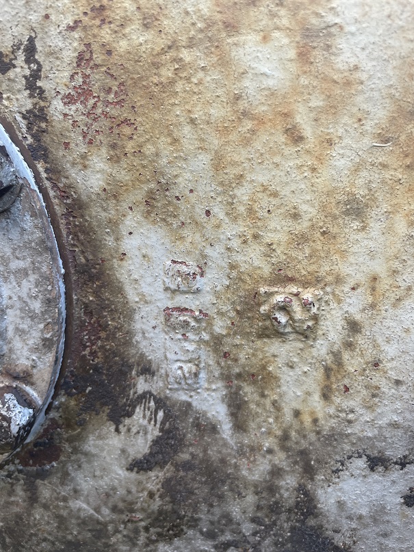

I have found also the number stamped in the engine block on LHS, and I"ve put some other pics of casting numbers in the chassis.
Is this the first lot of Standard gas motors.? it has the vertical mount oil filter at front of motor.
Any insights or comments appreciated.

Your Tractor has a 6 Volt Starter.
A factory 12 Volt starter will NOT attach to this engine, as the Transmission bell housing is not designed to allow a factory 12 Volt starter to attach.
"IF" the electrical has been converted to a 12 Volt.....system?
"IF" the Starters internal torque absorbing "RUBBER Volcanised drive component fails....well ......................:)

Thanks Bob, good to know. By the looks of the modern alternator on it, i dare say it has been converted to 12v, although I haven't had enough time to go through and check things yet. Will keep you posted. Cheers
