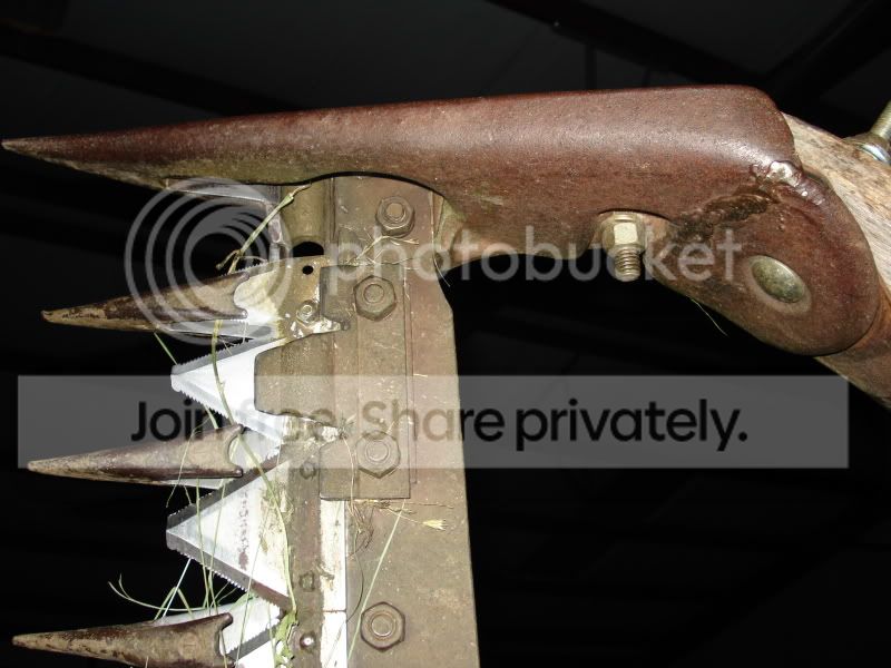

Completely rebuilt the JD 39N 7' knife with all new sections and added an end section.

Put an end section on the new 9' knife for the JD 350 mower.

Put a new end section on the 7' knife on the #5 mower.

Bought two new 7' knives yesterday; one for "Ben Franklin" a #5 mower and one for "Nelson" a 350 mower.
Will put an end section on each of these knives.

I cut all my hay last last year with a No9 and because the grass was tall I got by with out the extra 1/2 sickle on the end because the long grass kept dragging itself clear. This year due to less rain the grass in the pastures is much shorter and the No9 kept plugging the end to the point that I was getting off to clear every pass. Put the end sickle on prior to moving to the next pasture and have had ZERO plugs since. I have a No38 that I'm fixing up and I won't even try to cut before I put on one. I saw James used rivets; I was lazy and used the bolts.
