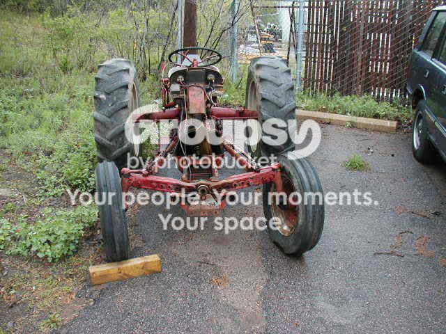

What actually supports the front end of the tractor? the oil pan, or the block?
In other words if you removed the engine block would the pan still support the front end? There's nothing really connecting the two other than the top of the block @ the transmission connection?
The oil pan . I have a few that I used an oil pan to connect the trans/rear end to the front axle so I could roll them out of the shop .
Ken is correct.
For rolling it around a bit the pan alone is fine.
It is the block and pan together that makes the tractor so rugged.

You can also remove the entire engine and bolt a chunk of angle iron (or equivalent) across the bell housing that will rest on the radius rods
Thanks. One of those 'I have to move this thing out of the way - now' flashes. It was on blocks and stands with the front axle and RR's 'over there'. Et Voila !
(quoted from post at 15:21:38 04/06/16) You can also remove the entire engine and bolt a chunk of angle iron (or equivalent) across the bell housing that will rest on the radius rods
