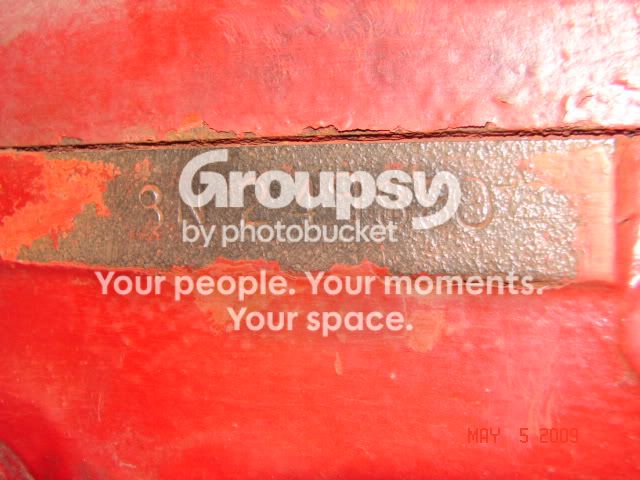

I would like to know where to find the engine number and casting codes. I have registered my 8n and it ask for this info. thank you for your time.
Leroy1142
Check out tip # 71 at the link below.
Also, John Smith's site has more info on casting codes. http://www.oldfordtractors.com/idhistory.htm
The block casting code in the picture is January 3rd, 1950.
75 Tips
Yes, 249880 is the serial number. The block casting code is A 3-0 on that tractor.
The block w/ serial number 249,880 was cast on January 3, 1950.
