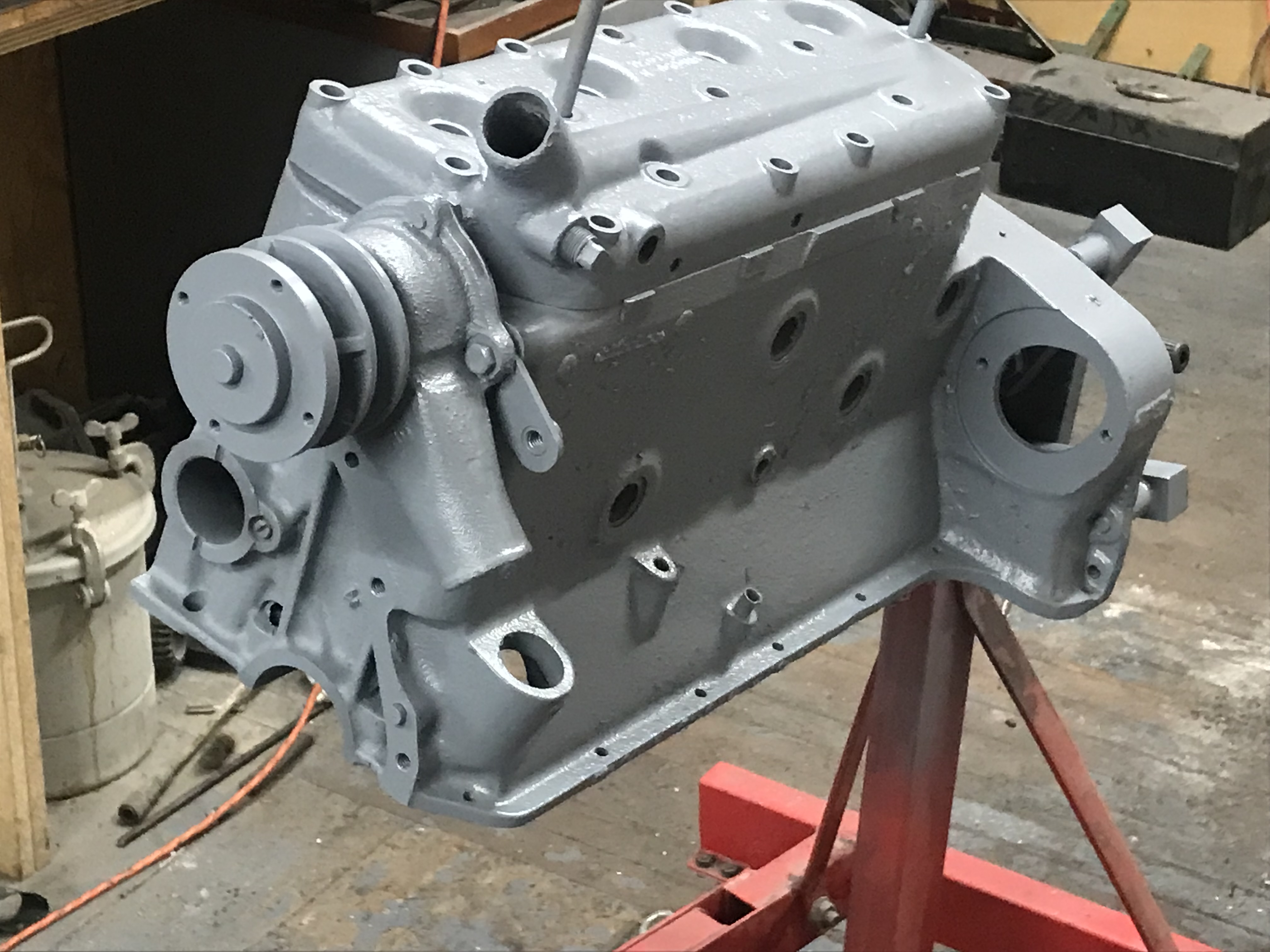

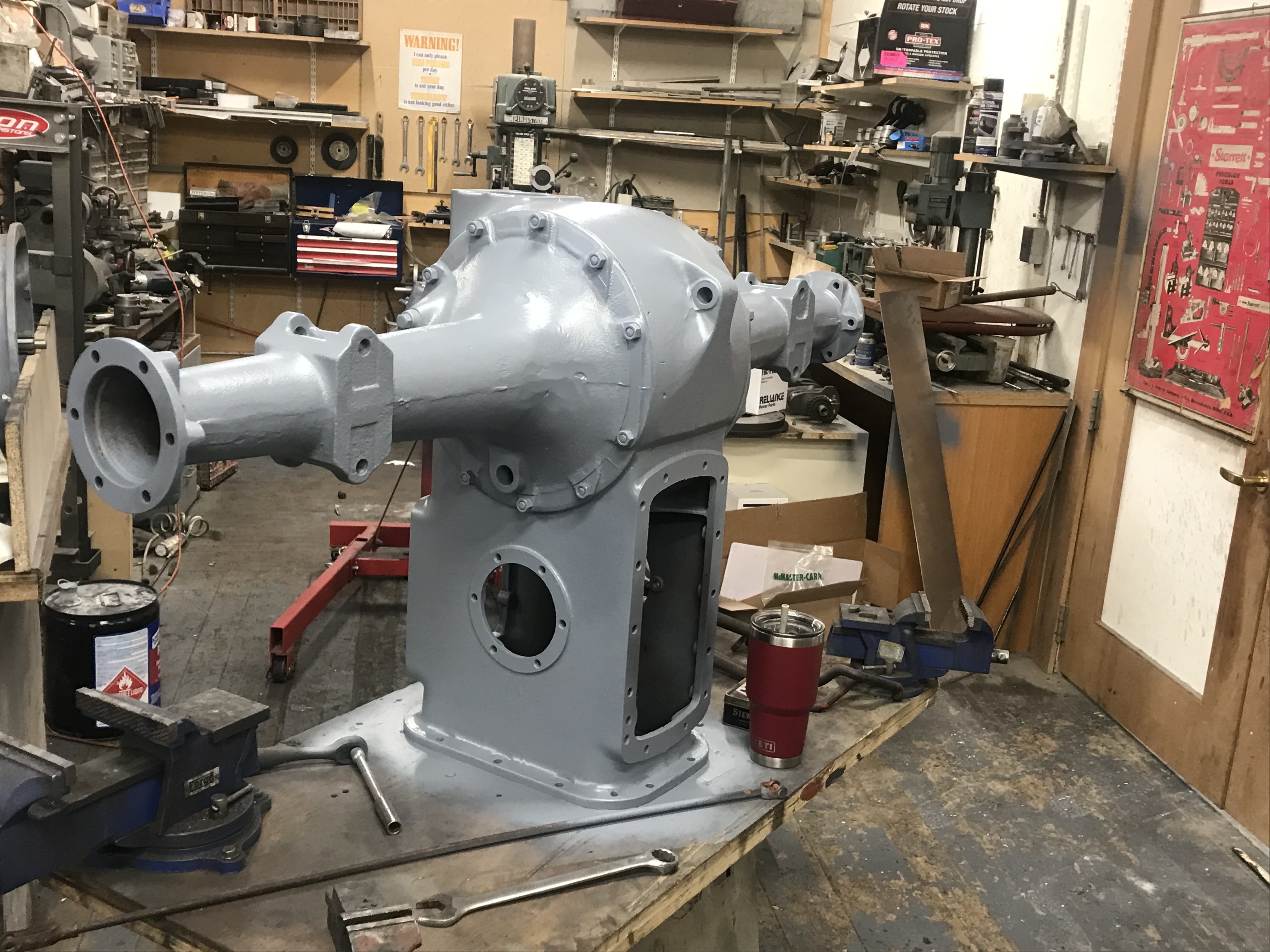

- Newbury, Ohio
Planning to use it on the cast parts of my H after either wire-wheeling or sandblasting. I will not assemble it right away and likely to sit around for months. Epoxys have a recoat window. What would be the best way for painting later? Scotchbrite and paint? Normal primer coat over epoxy coat? I used a rattle can epoxy on an engine block and castings after they were hot-tanked and painted a year later. A friend who painter cars helped and he gave me some kind of solvent to wipe everything before paint and now I can scratch the paint with a fingernail.
