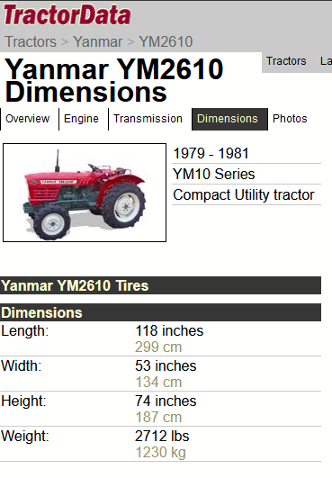

I'm looking to purchase a good power winch for the trailer I haul my YM2610D. This would be more for emergency break-down than regular use. What would the estimated weight be of my YM2610D with a bucket and gannon attached? Any recommendation on a particular winch?

This is the 2WD weight. You would need one capable of 20% more than the total weight of the YM2610D. I say this from experience.
Winches are rated about 4-inches of cable unspooled. The farther the cable is spooled out, the less weight the winch can move. Thus the 20% over total weight is factored in.
Should you need to pull the tractor up and onto a trailer, then add in another 10% of winch capability. Add in a safety factor of 5% and your winch needs to be a 4,000-lbs rated type.
The loader and other items attached would raise this considerably. 10K would be best as @MJMJ clearly stated.
