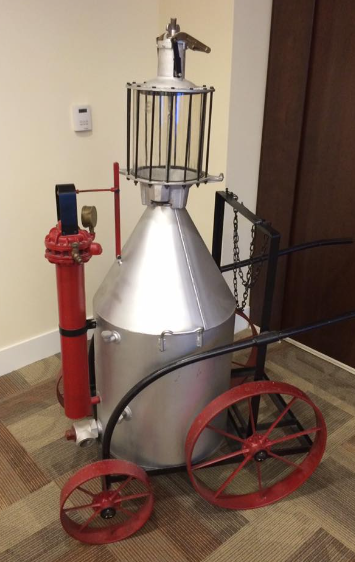

My welding mentor had a sight feed acetylene generator on his welding cart just like the first picture.
Used regularly since WW2 up until 2005 or so when sold.

View attachment 76035View attachment 76037
:thankyou: I couldn't think of the company name, yesterday & didn't want to call it that "light hose lookin' thing". That & the search engines are about as useful as a straight boomerang.
