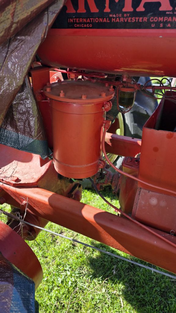

Question. What is this canister supposed to be? Hooks to a tee on the oil pressure gage and then to the block.
That is an add-on bypass oil filter. Baldwin was one manufacturer of these. The filter works on the same principle as the engines stock filter, just as the name suggest a limited amount of oil is filtered. The “bypassed oil” flowing to the filter was limited by an orifice hole somewhere between a 1/32” to 1/16”, that oil flowed through the filter element and down into the oil pan. Notice I said it was a by-pass filter just like the original filter. Oil flowing to the lubrication system in these old engines was not filtered except by the screen on the oil pump pickup. Full flow filtration designs were put in place in about all applications in the mid 1950s to early 1960s. You could leave it in place as a unique feature but block oil flow to it.
Is there an element to change?
Look for some name or numbers cast or stamped into it this might help us determine what type of element it requires. I have heard on here of the claim that a roll of toilet paper was indeed used in some of them but someone else would have to confirm that. I have also heard that modern toilet paper doesn’t have the proper consistency for this application. All I can tell you about bypass filters is on our farm we ran Baldwins on a Case 1070, MF 1080 and IH gas combines. There was a percentage of hours you added to the oil change interval they actually recommended testing the oil and adjusting intervals per those reports which we did not do. Those newer filters had specific cartridges.
