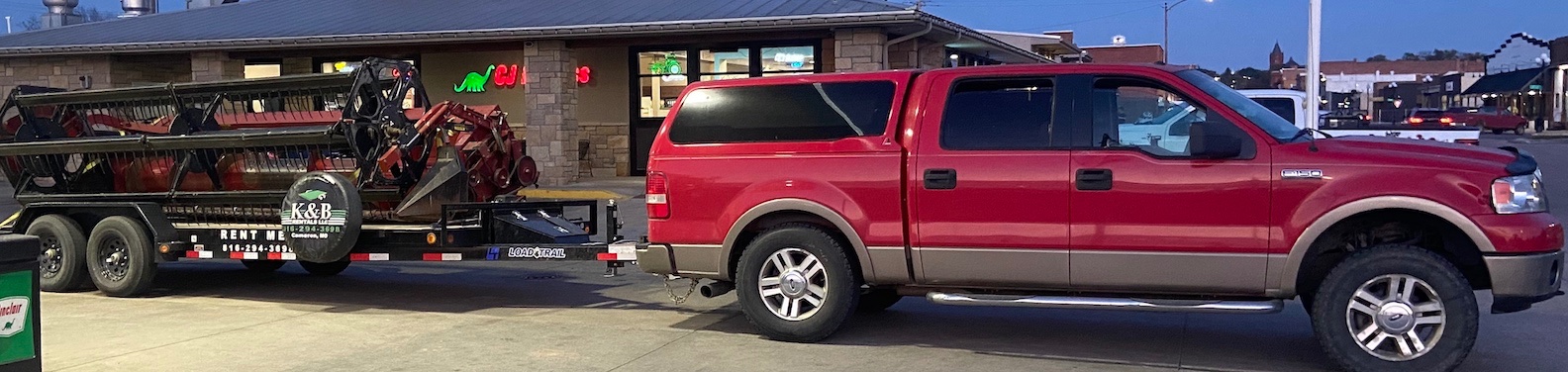

My 2006 F150, 5.4L, has 300,000 miles and mostly works fine, but the temp gauge says it’s hot sometimes, but I don’t think it’s actually overheating.
Normally, the needle is right in the middle, then it will creep up, until it hits some threshold and then moves quickly all the way to hot and Reduced Engine Power will display.
I then put it in neutral, turn off the engine, then start it again and it will immediately be back to normal temperature and works fine again, I keep driving. This is what makes me pretty sure that the engine is not actually overheating. I’ve had an engine get hot and it takes about 30 minutes sitting by the side of the road with the engine off to cool off enough to start again. With mine, it shows pegged hot, but tuning the engine off, then the key back on, it’s immediately back to normal temp.
It’s interment, but getting worse. It used to happen after maybe an hour of driving, now it happens every 5 minutes, but not regular, sometimes it’s fine for 10 or 20 minutes, before it happens again. I shut it off, start it again and it’s fine for another 10 minutes.
I would like to ask your help with 2 questions.
What could this potentially be?
How can I do troubleshooting to find the problem? To be more sure where the problem is?
My guess is that the temperature sensor in the block is going bad and I should replace the temperature sensor.
What else could it be? What do you think?
Troubleshooting? Can I find the sensor and put an alternate gauge on it? Have a gauge (or something) in my cab and run wires to the sensor and see if the sensor shows hot sometimes? Or will the computer let it work without the temp sensor connected?
Thank you!
