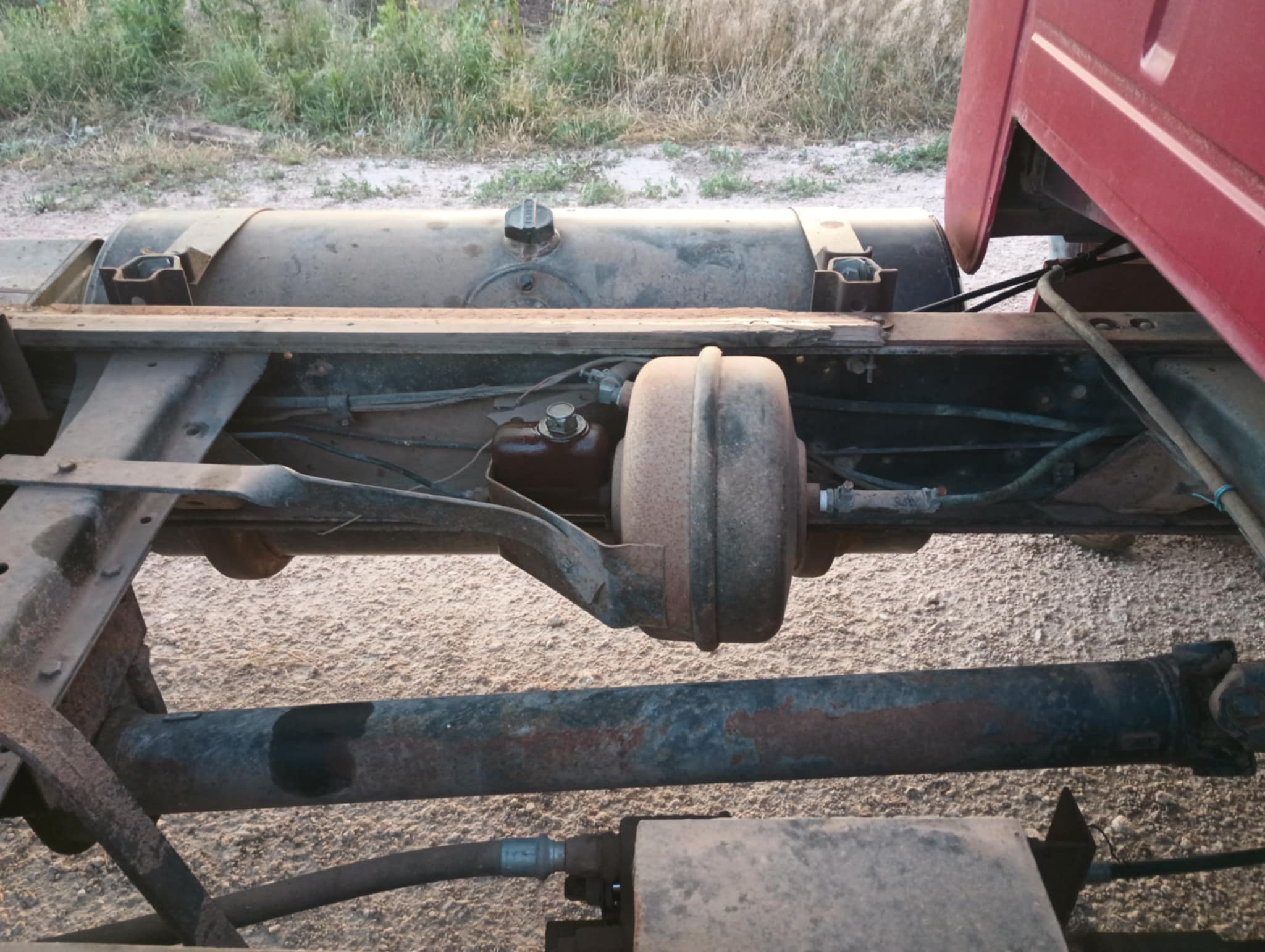

I should have mentioned that this booster is down on the frame and has a “Velvac” label on it. That (and wanting to knock off for supper ha ha) is what had me in the mindset it was more than brake fluid. It WAS low on fluid - but I sure can’t seem to get the air out of the lines or it to pump up like it should.
Can you devote some time to this? Or at least be nearby doing something else? Get a piece of automotive vacuum hose and a pint/jelly jar. Connect it to the left front wheel cylinder bleeder and open it and stick the other end in the jar. Fill the master cylinder and set a timer for 5 minutes. When the timer goes off see if gravity has flowed any fluid into the jar. If it has see if any air bubbles are coming out of the hose as it flows. After it has put somewhere around a 1/4 cup in the jar (an inch plus in a 2” diameter jar) and there are no bubbles move to the right front wheel, then to the rear bleeders. Make sure the master cylinder is kept full during this process. Another thing I am not certain of but it may be that you need to bleed the hydrovac first before the front wheels I can’t remember exactly how the those old system are plumbed. If the line coming out of the master cylinder goes to the hydrovac, bleed that first. This method requires clean open bleeders they can’t be partially blocked or plugged. After you have done all this then see if the pedal pumps up better or is any solider. As I said earlier in reply 10 about the adjustment being a very important part to having a good outcome of this process bares repeating.

Another thing I just thought of would be bleeding the master cylinder by itself first. Not sure if you ever bench bled a master cylinder with a screwdriver prior to install they usually come with a bleeder hose set. Basically screws in the outlet port and the short hoses loop around back into the fluid. It is important that the end stays immersed in the fluid. Once the hose is on you pump the cylinder until the fluid is air free. This way you are not pushing all that air out of the master cylinder all the way through the system.
