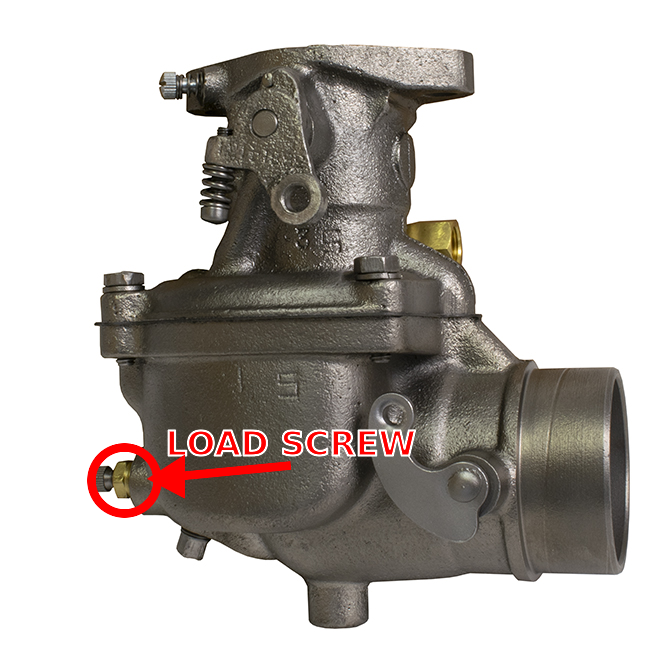

Now for the dumb question, which screw is the "load" screw? I don't have a good drawing of the Farmall carburetors. I could guess with some certainty, but why not ask an expert.
Joel

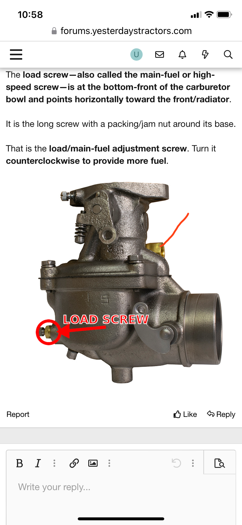

The load screw—also called the main-fuel or high-speed screw—is at the bottom-front of the carburetor bowl and points horizontally toward the front/radiator.
It is the long screw with a packing/jam nut around its base.
That is the load/main-fuel adjustment screw. Turn it counterclockwise to provide more fuel.

I would suspect you did something or at least looked at the points and plugs after it sat 20 years, if not that would be where I would go first. And FYI BDG in reply 2 mentioned screen before the carb being plugged I drew a red line to it in my screen shot of his carb photo.
