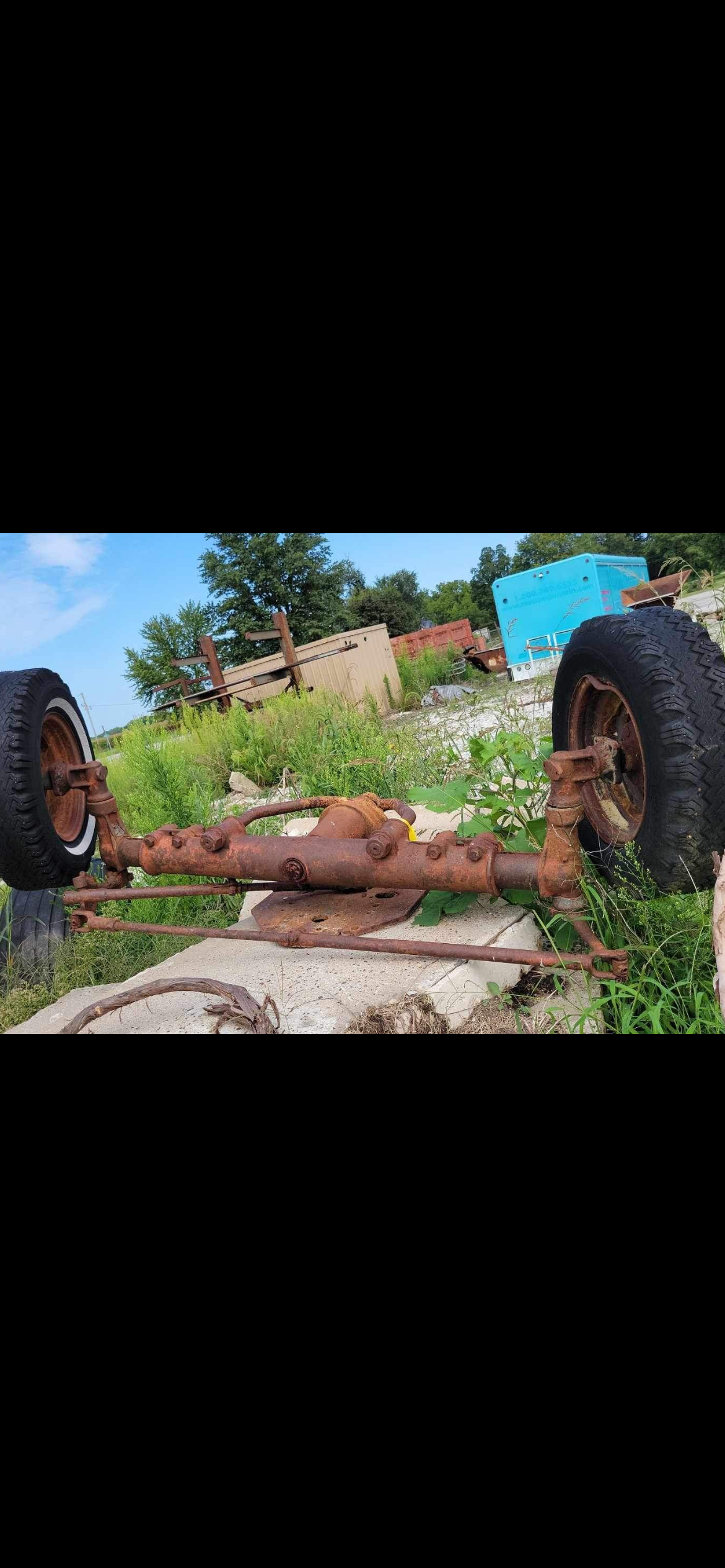

Can anyone tell me what wide fronts fit 1959 Farmall 560 ? I’ve been looking and can’t find anything. Looking for a Schwartz maybe but I do t know what other models fit or is there a wide front everyone likes ? I’m gunna keep the smaller tires up front if that helps
There are atleast 6 'styles/types to choose from. 3 styles of IH. The 'old style'(tierods in front); the new style(Tie rods in rear). One will have the cast type M style hub,the other will have the newer 6/8 bolt hub/wheel. There is the Swarts(most common);Norden; Speeco. There may even be others,depending on your area.Example: In Northeast Colorado(Ault) where I grew up, there was Heberlien Manufactureing that also made wide fronts.There were several of the Heberlien in the area . Wide fronts were more common in furrow irrigated areas where they grew onions,sugar beets potatoes.....Than they were in the corn belt of the midwest.As Jim said,anything from M through 1256.

Looks like this

Just FYI, that’s an aftermarket wide front a Schwartz or Speeco. Nothing wrong with it, in fact I believe the spindles on those are a bit more resistant to breaking than the stock IH front end. The give away is the center pivot that bolts to the frame is a weldment, on a stock IH axle the center is cast.

'Old style' IH wide front. Early one at that,due to the cast center.Most likely from an early M,would work on a 560,but you would need to drill about 4 holes in the lower frame rails.It has some odd hubs/wheels. Need more pics.They are not the best. Pass it by,keep looking.Measure the set back plate and the pitman,as that could have been on an H. Not likely,but possible.
Further examination says the original spindles have been cut off,and automotive type spindles have been welded on.Most likely to use more modern wheels.
