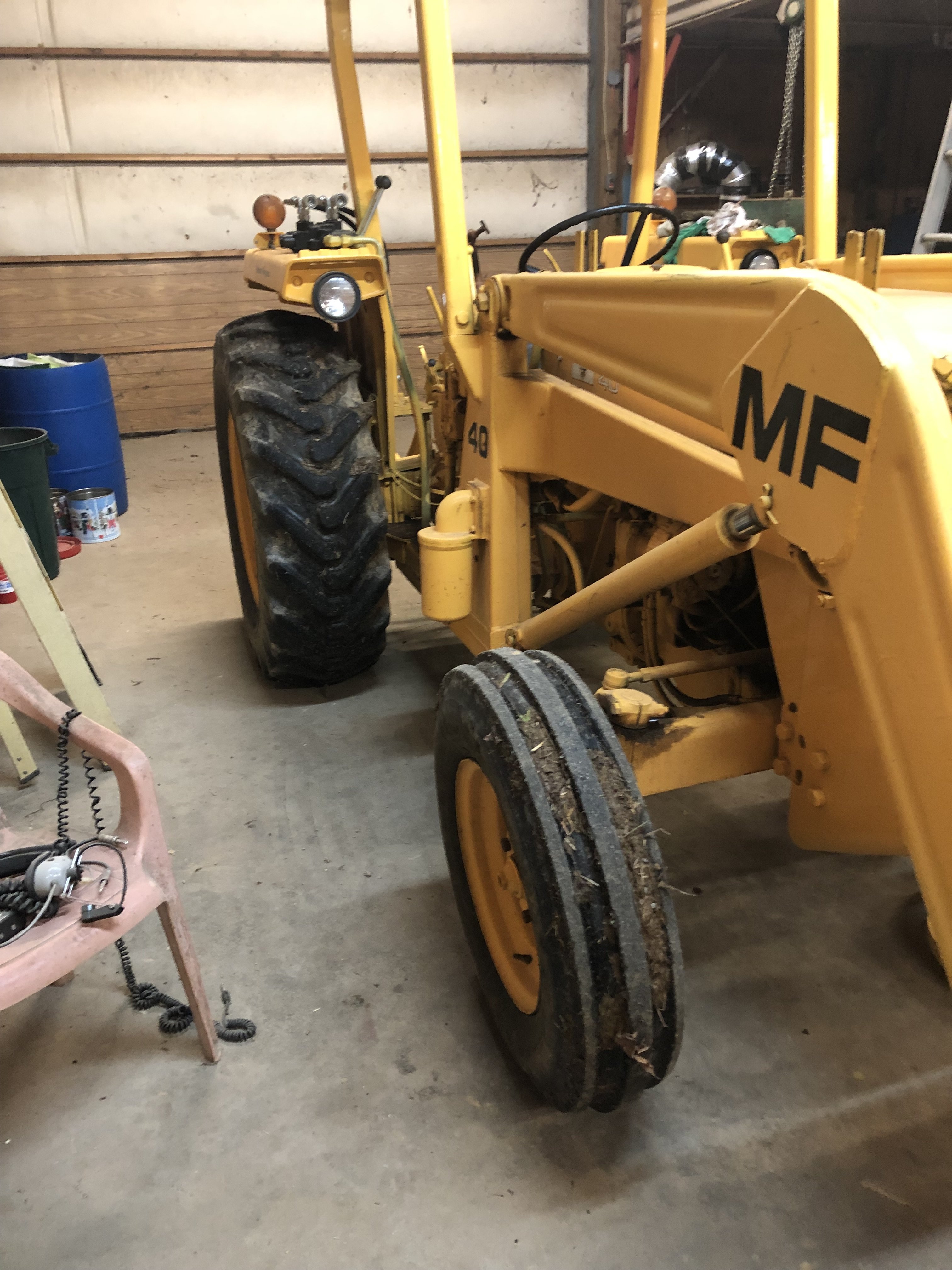

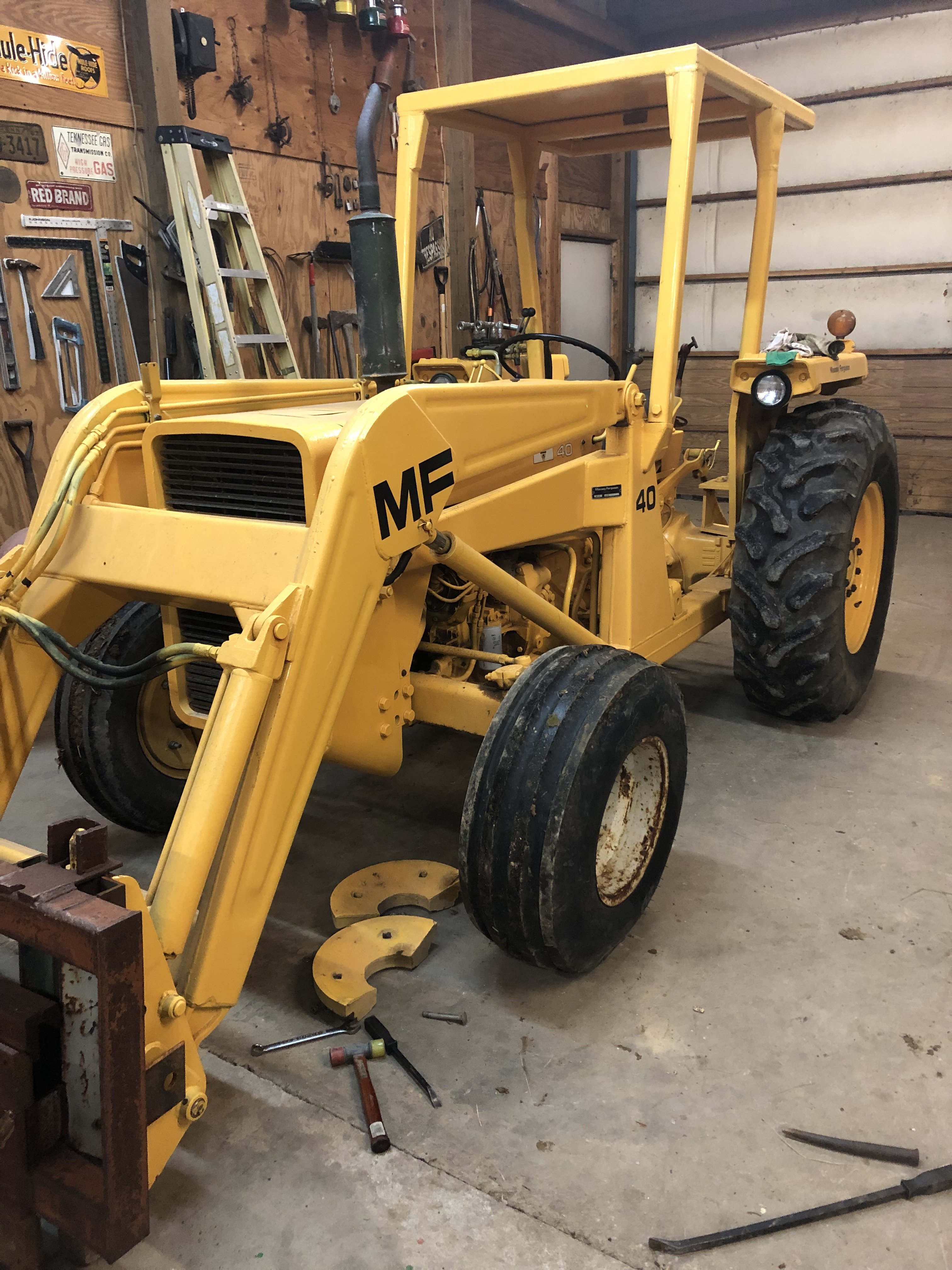

You're going to have to make sure you get the right backspacing for them to not rub. In the pic above I was just doing a test fit with the tire off of my 1850 Oliver. They fit fine but I couldn't find another set of wheels with the same backspace anywhere. Ended up just buying a couple of new wheels, cut the centers out, and welded them back in with the backspace I needed.
This set I found came off a 856 so I’m hoping the rims have the right backspace to fit a 656 front as well
