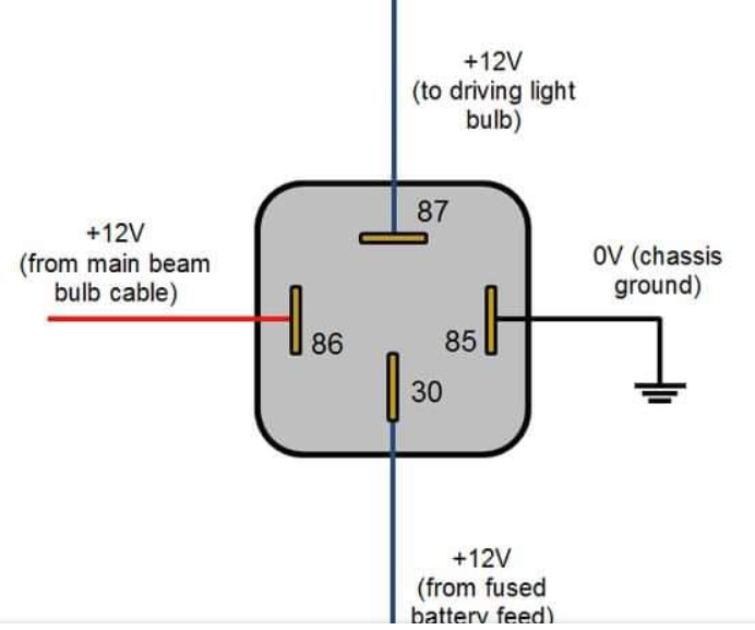

I would go from the key switch to the relay's pull in coil. I would take power for the relay's load circuit from the battery post on the starter to a circuit breaker (or fuse) rated at 20 or 30 amps depending on the rating of the relay you have. The out going side of the relay's load circuit runs to the light switch, or switches, then to the lights.
Does your relay have a diagram of its internal wiring on it so you can ID the terminals on it?
Here is diagram of relay. Probably all switches on at once.

You only want the electricity that activates the relay to come from the key switch. The power that actually makes the lights, light, should come from a fused connection, direct from the battery. Breaking it down into three separate connections makes for less to remember:
Key switch - rocker switch (or factory light switch high beam terminal) - relay 86
Battery - fuse - relay 30
Relay 87 - each light - ground
I wouldn't use any smaller than 12ga. That's just me, though. It's not entirely necessary. 14 is probably fine for LEDs.

The way I described it is how relays are typically utilized. You use a relatively light-duty switch to control the heavy-duty relay. The relay carries the electrical load from the lights instead of the switch.
No offense to Jim.ME, but I'm hoping he was just mixed up in his description, because it defeats the purpose of the relay.
You do not want to run the entire light load through the key switch, or off the starter button. It is acceptable to power the relays off a source like that.
If you want to be able to switch lights on and off in multiple groups, you would use multiple relays, controlled by multiple switches.

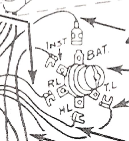

You could also creatively use the factory light switch on your tractor. First, you'd cut the little spring (low-beam resistor) off the back.
"INST" would connect to a relay that controls your instrument cluster lights and, let's say, your outer fender lights.
"TL" would connect to a relay that powers your flashers and/or red tail lights.
"HL" would connect to a relay that powers all the rest of your forward lights.
"RL" would connect to a relay that powers your rear lights.
DISCLAIMER: I may have TL (tail light) and RL (rear light) reversed.
Then things would work like factory. First position would activate the outer fender lights and your flashers. Second position would activate the rest of your forward lights and leave your flashers blinking. Final position would shut off your flashers and turn on your rear flood lights.
This way is a little more complex, but you can add as many lights as you want and not overload the factory switch. That factory switch is barely adequate to power the six factory lights on a 706 with flat top fenders.
