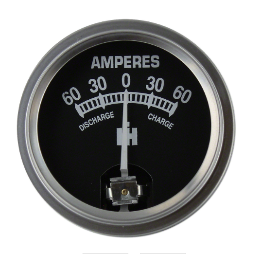

I have an ammeter on my M that spikes randomly(to the right). I bought the ammeter last year and thought I hooked it up right. It has always kind of maxed out randomly since I put it in. It doesn't stay spiked long. When it doesn't max out it stays about one line to the right of center. I have one side of the ammeter wired to the + batt wire side of the foot push starter. Other side of ammeter goes straight to the bat side of alt. Along with the headlight wires, etc.
Since I "believe" it is hooked up right, might I have messed up the ammeter in any way possibly having the wires hooked up wrong at some point? Thanks!!

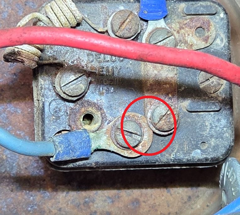

What type of alternator was installed, brand, a 3 wire or 1 wire? If an internal regulator type the spiking almost has to be caused by a momentary failure of a circuit in the regulator. Or something is shorting to ground on your wire between the ammeter and foot switch or the positive battery cable, none of that would last very long without a smoke show reporting it.

Also if this alternator puts out 35 amps (or much more is possible) the meter may be pegging from that issue. a greater amp range meter is needed in that case. Jim

Delco-Remy, 3 wire. The blue wire coming off the ammeter is the blue wire attached to alt. Red wire on ammeter to pos batt cable foot switch has nothing wrong with it. Could the light switch connections be causing issues. Lights work, just need to wiggle the round dial light switch until they turn on. Probably should get a new light switch comp sometime.

How many amps is the alternator and what is the max reading of your ammeter? "Maxed out" may be 21 amps.

Good point. Any added output from the alternator in response to a current draw in the light circuit would not go through the ammeter. Problem nearly has to be in the alternator. Could also be a bad connection on the sense wire that feeds the output voltage back to the regulator.
Unhooked the wire that runs to fuse/then headlight component. Started tractor and ammeter gauge was then "pegged full time". Left the black wire on ammeter that runs to back of pull switch.

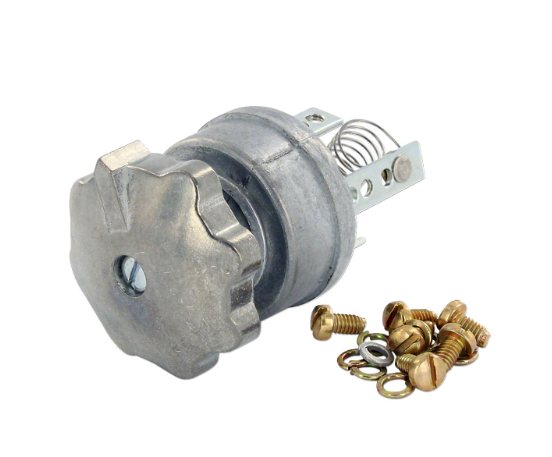

I separated those two connectors touching. Nothing different happening. But can you tell me if all the wires on the light switch are right? The lights are live. They turn off with the light switch but I don't have to tun on the pull switch to turn the lights on. So I have to have the lights wired wrong somewhere. And the amp gauge still maxed out.
