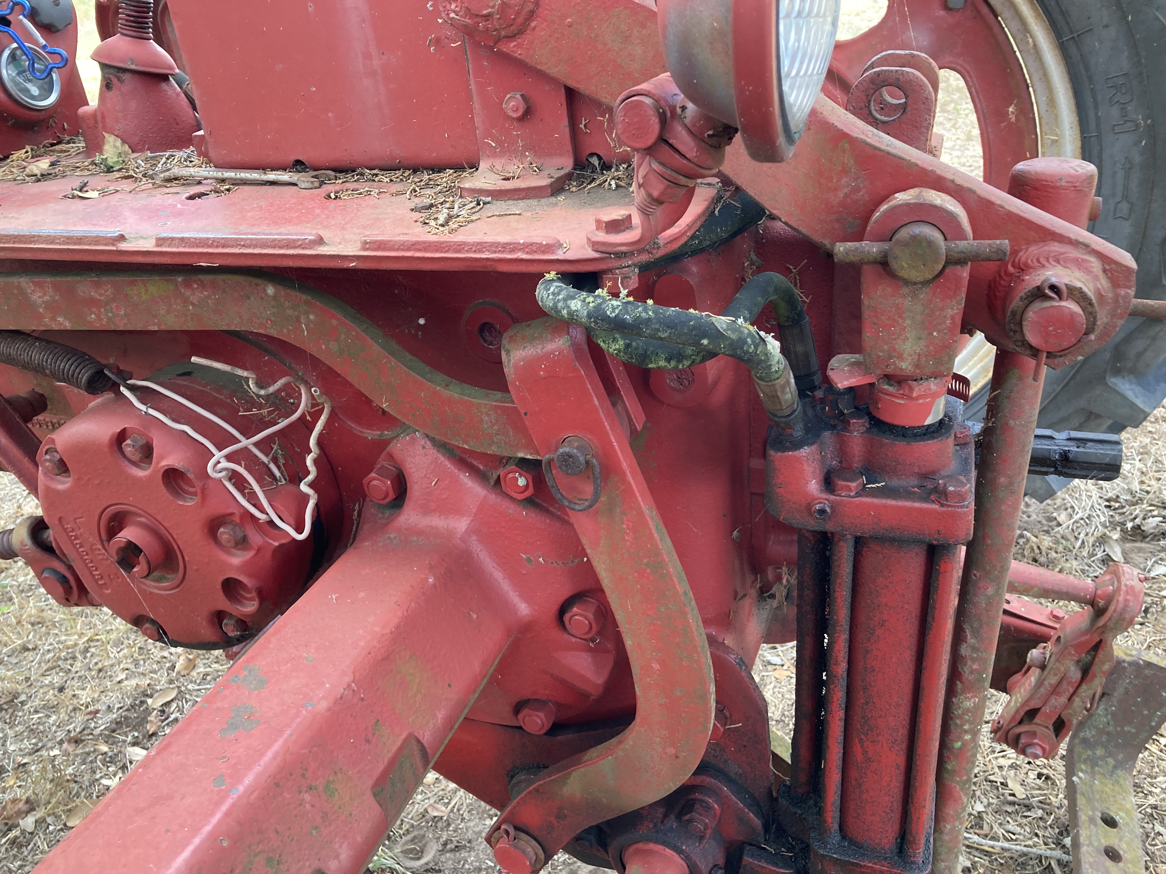

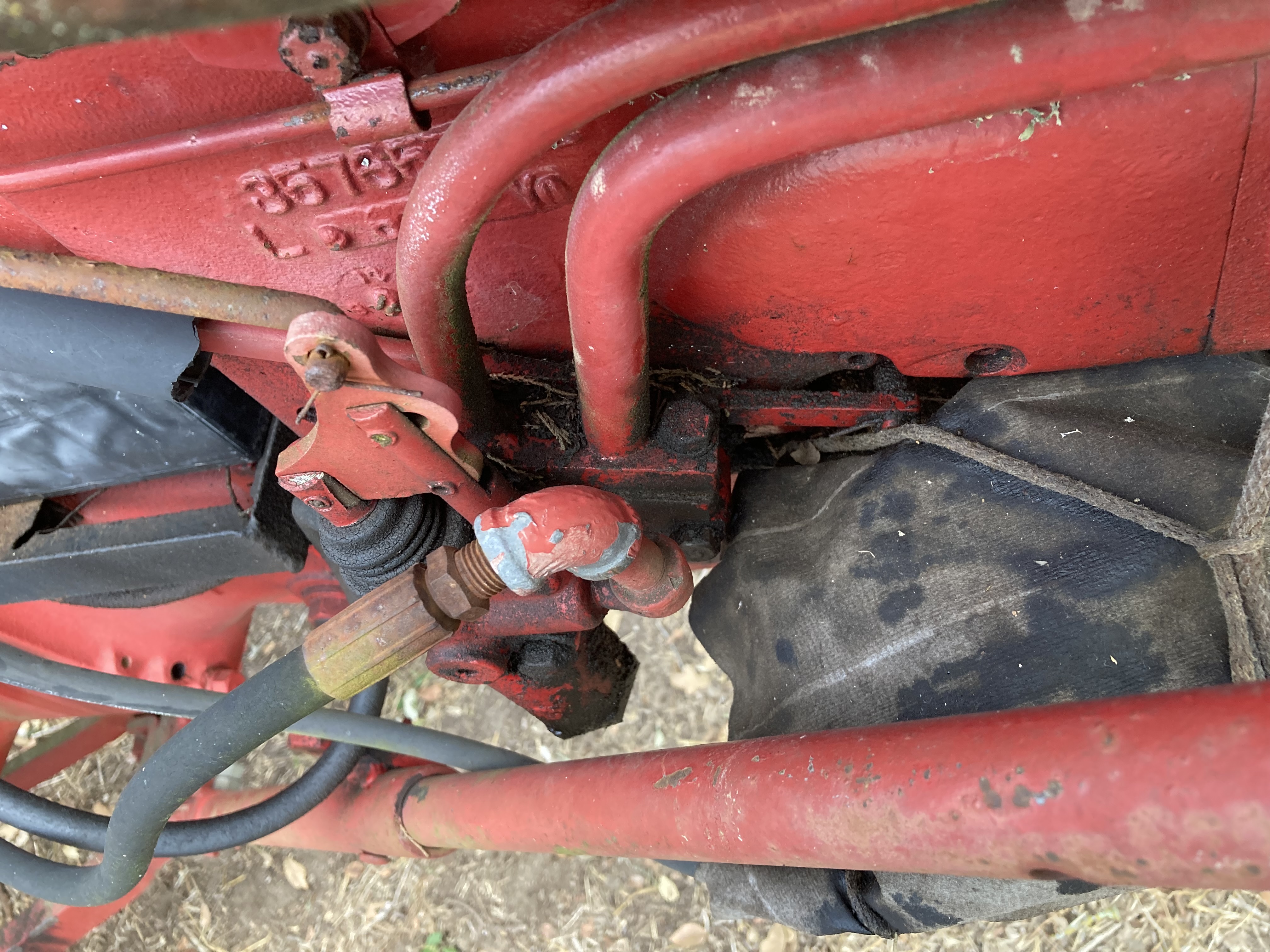

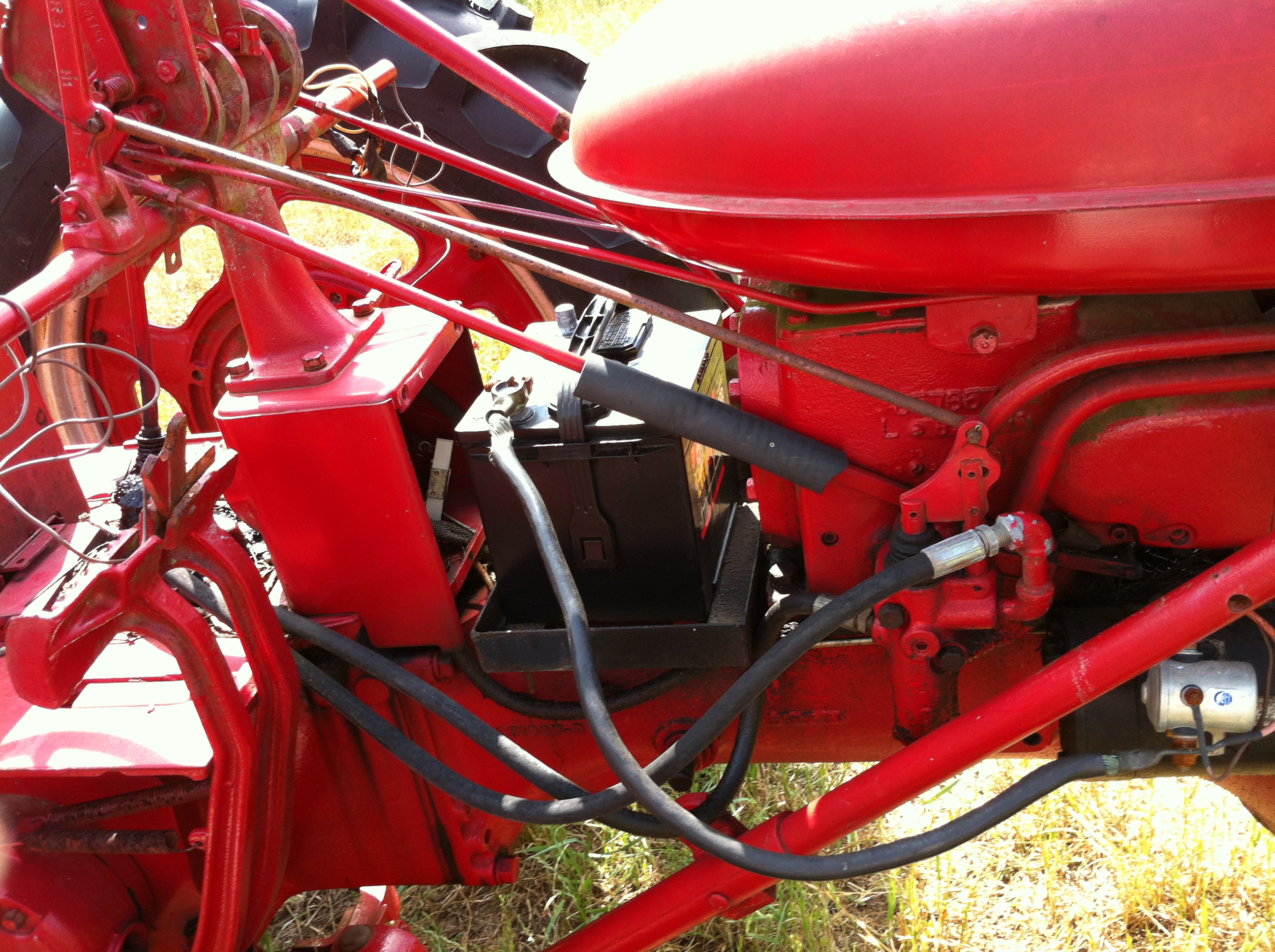

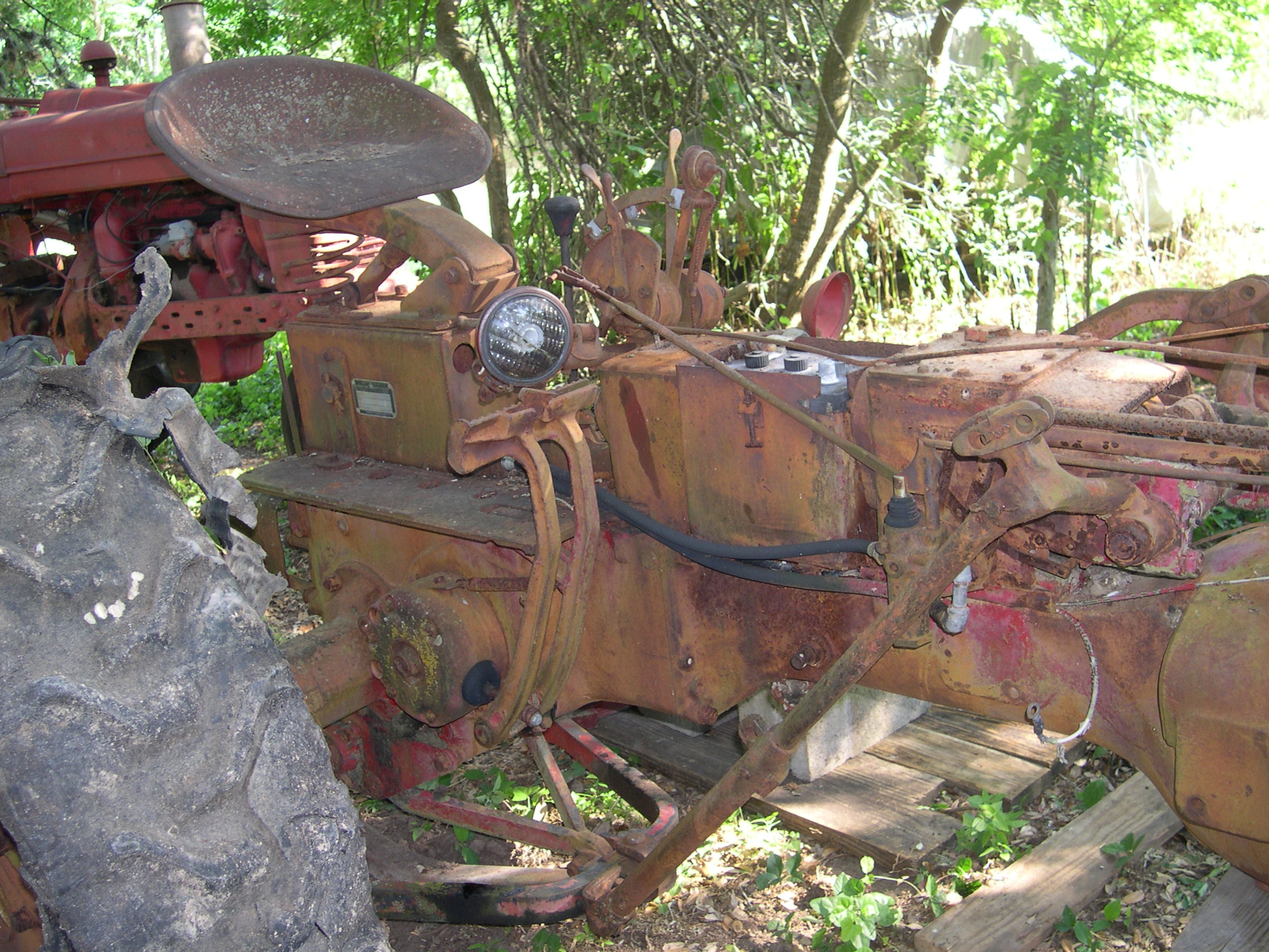

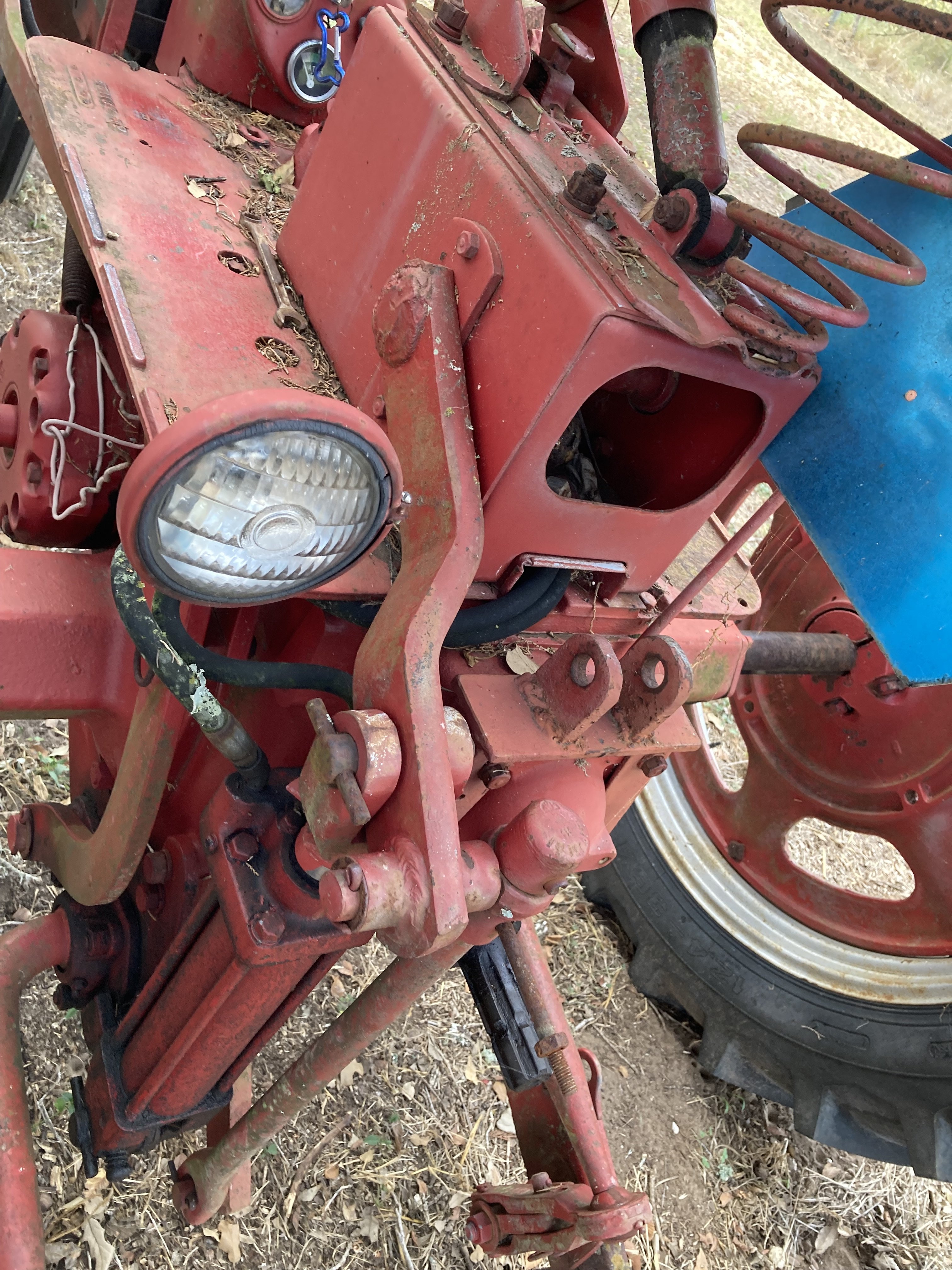

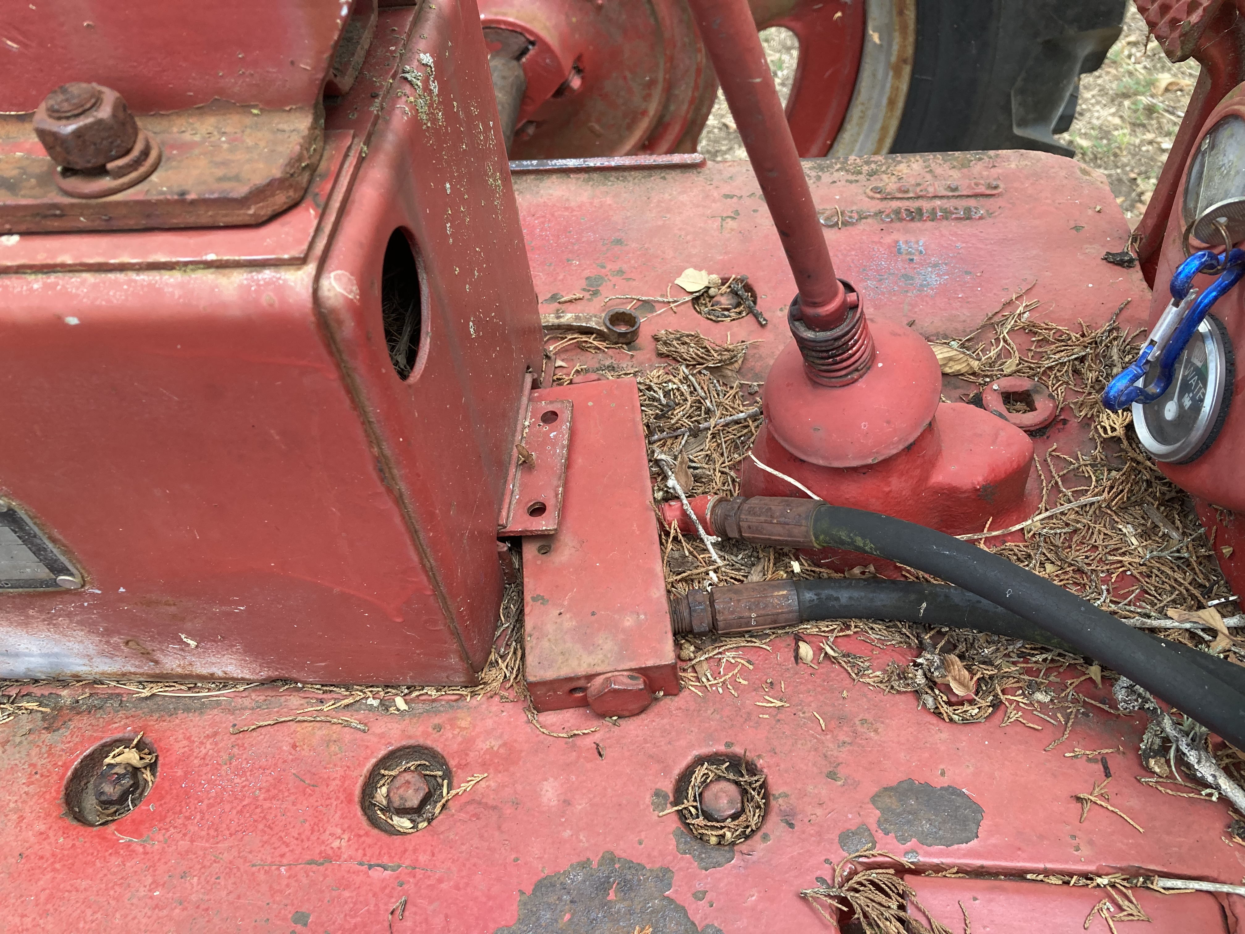

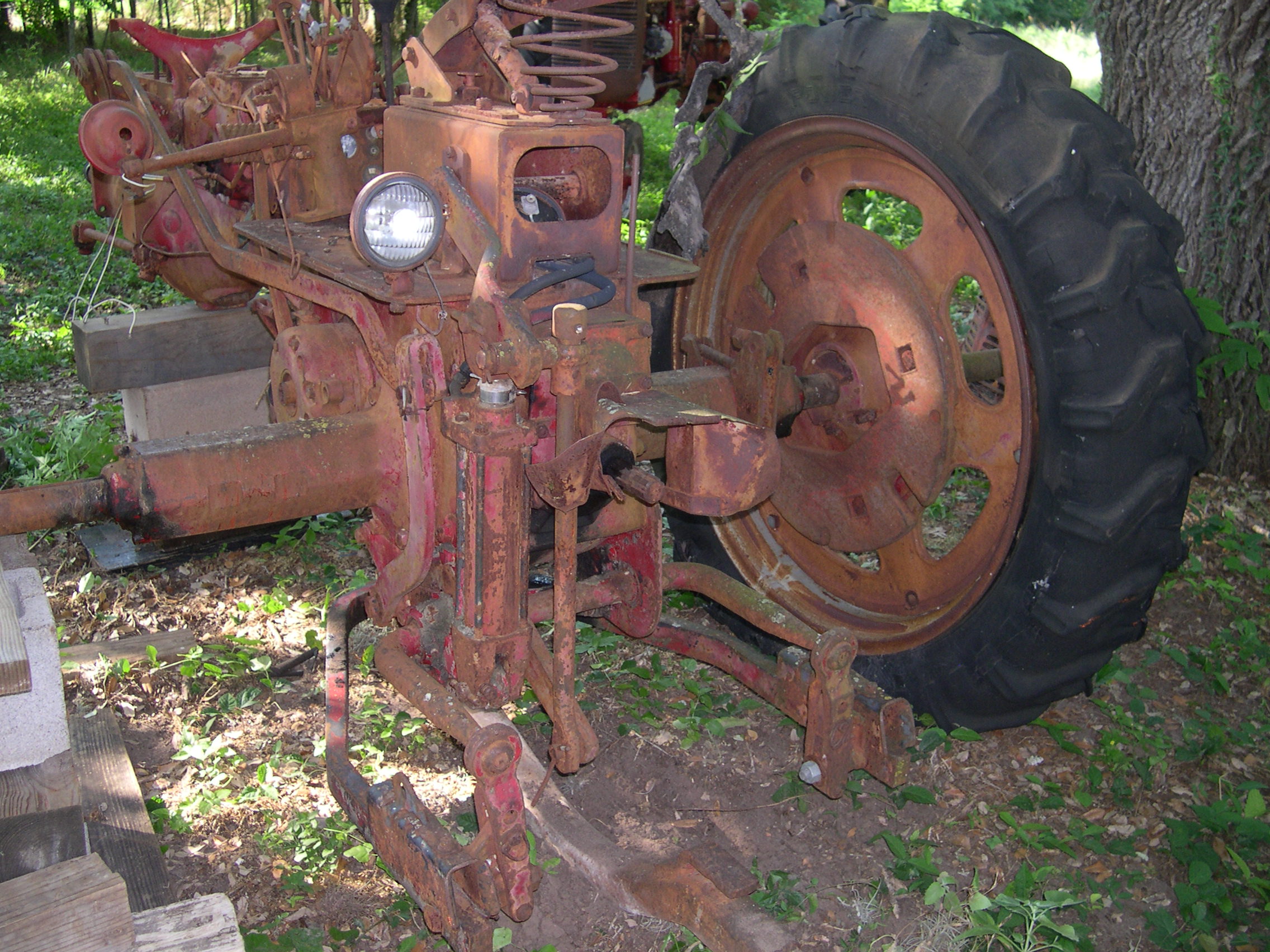

It should be the same. How complete is your donor? You need the seat base unless yours has the bar already. You need the bars from the touch control on both sides. There is a different drawbar. I got mine from a donor. The aux valve has a different set of lines from the pump to accommodate the valve. There is a leaver on the tree for the valve. There’s a hydraulic block with a check valve in it under the seat support. Here are some pictures that show most of it.

Thank you very much for the pictures and explanation. They are very helpful.

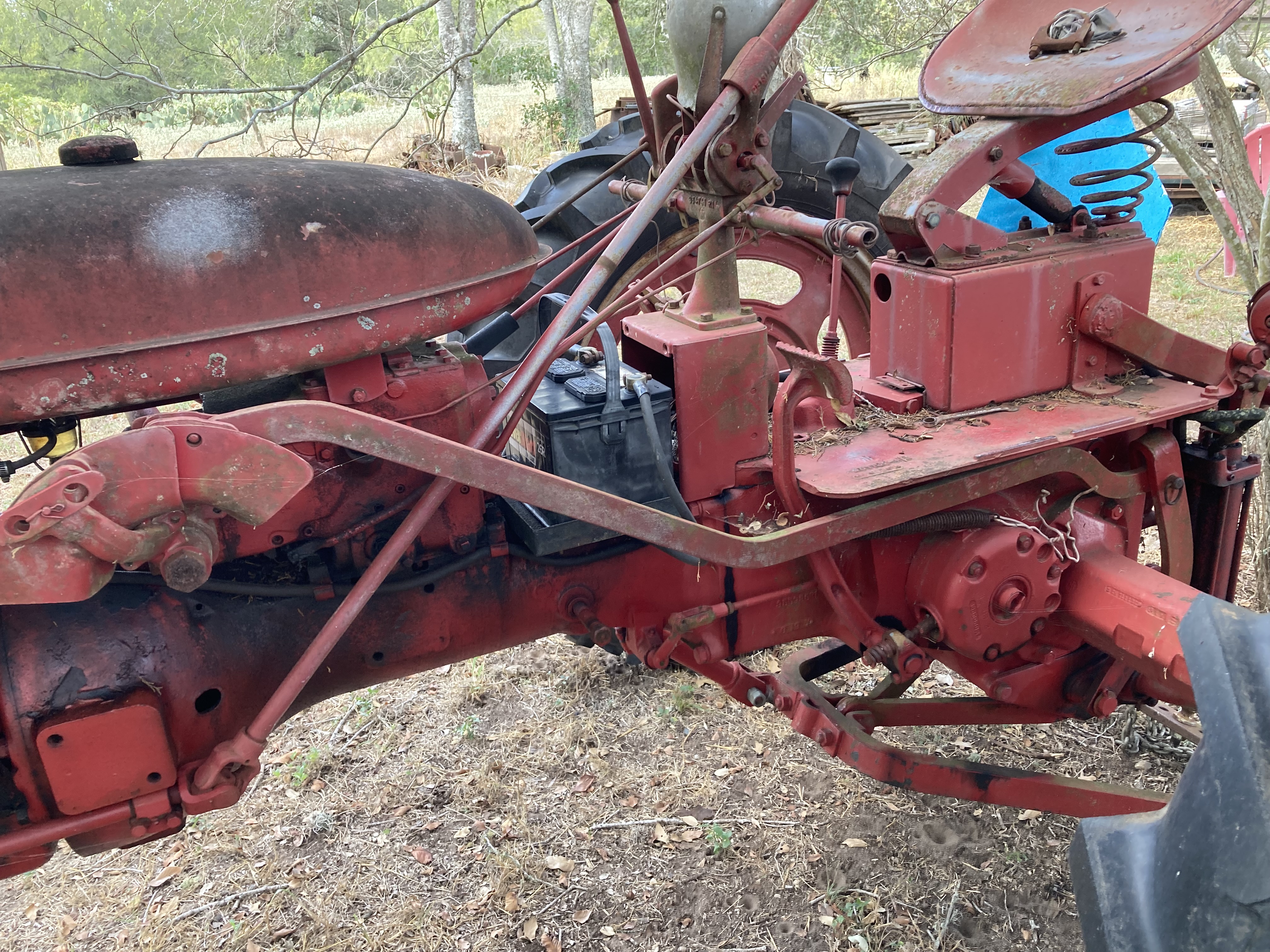

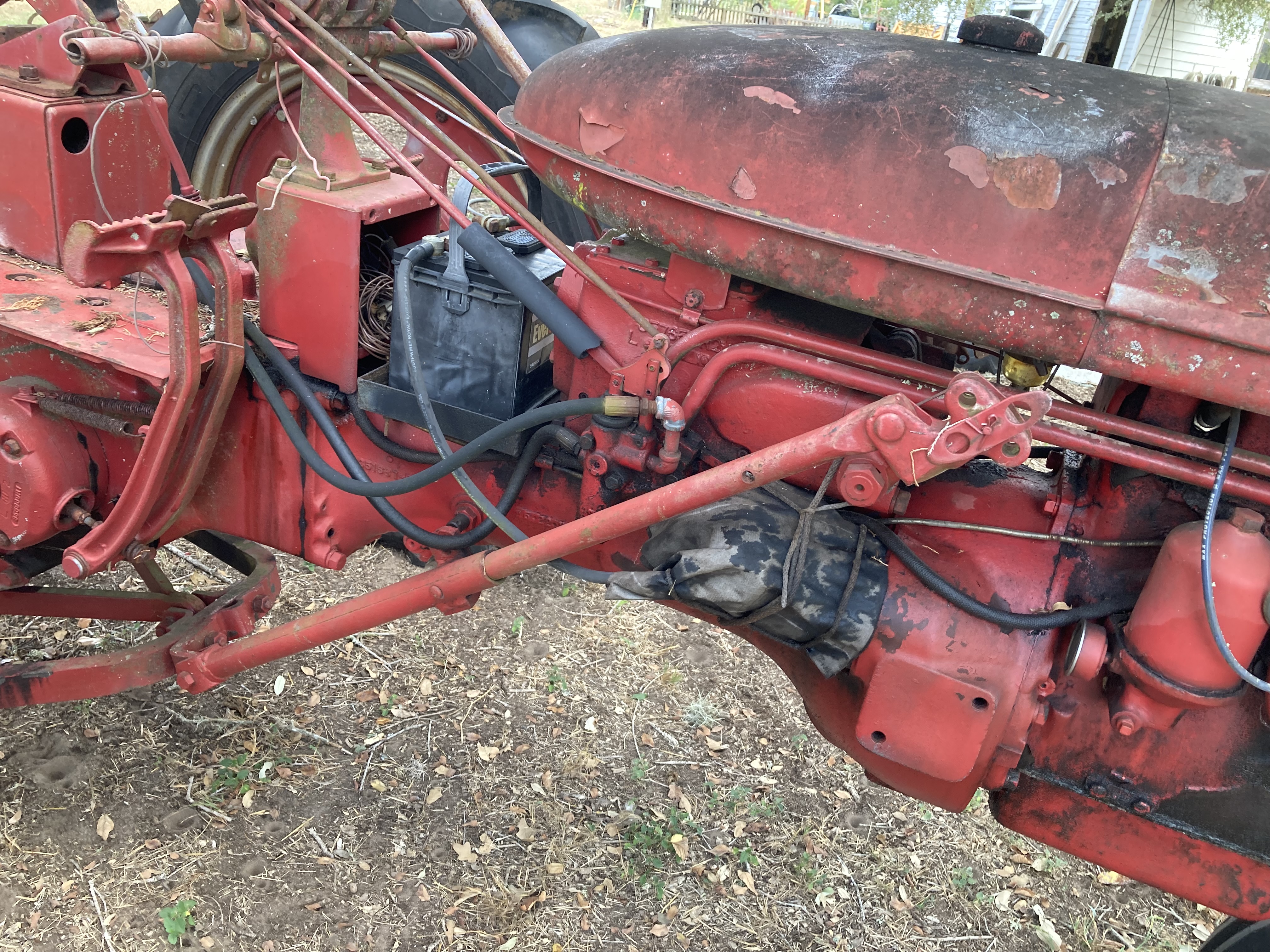

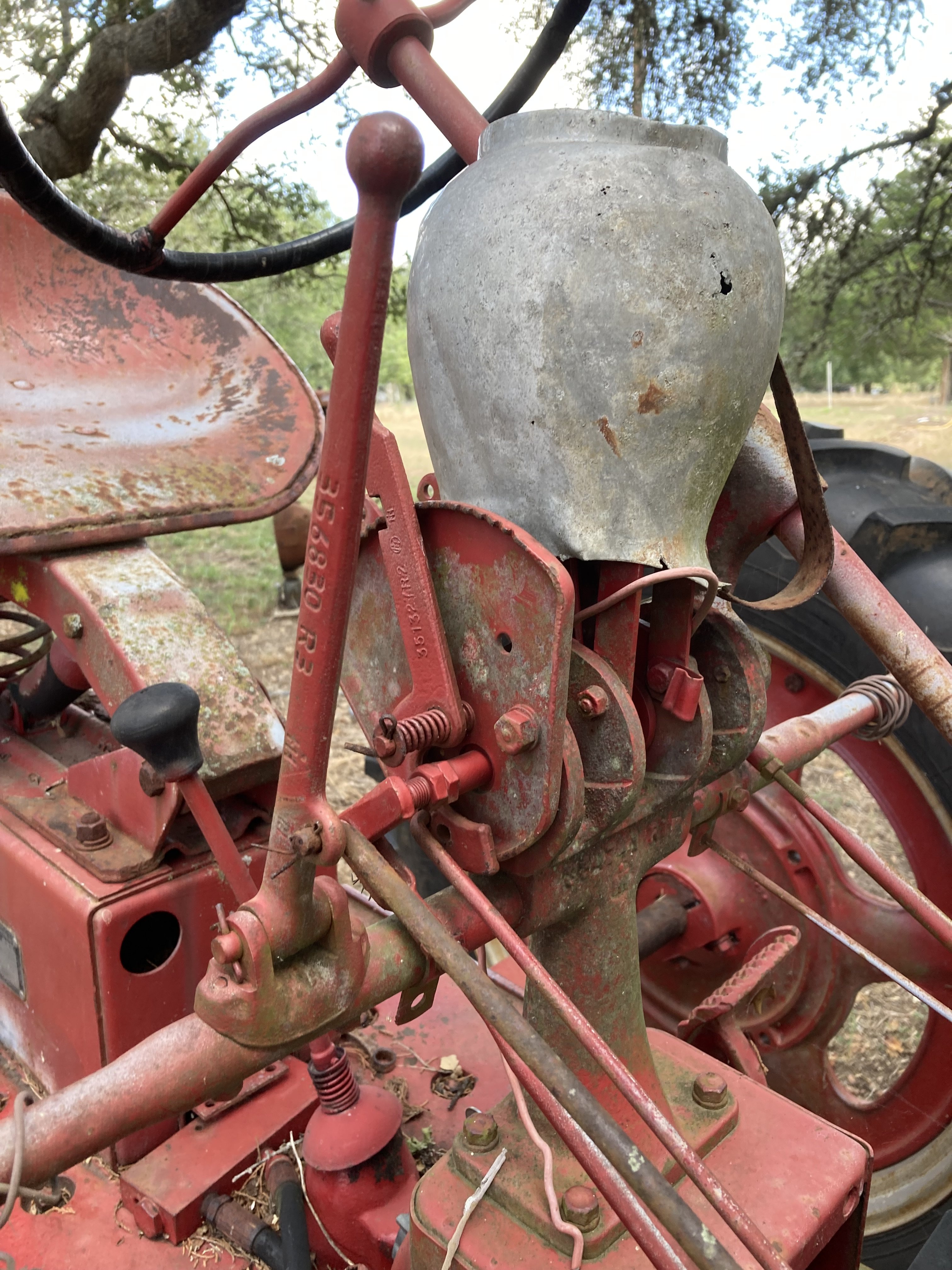

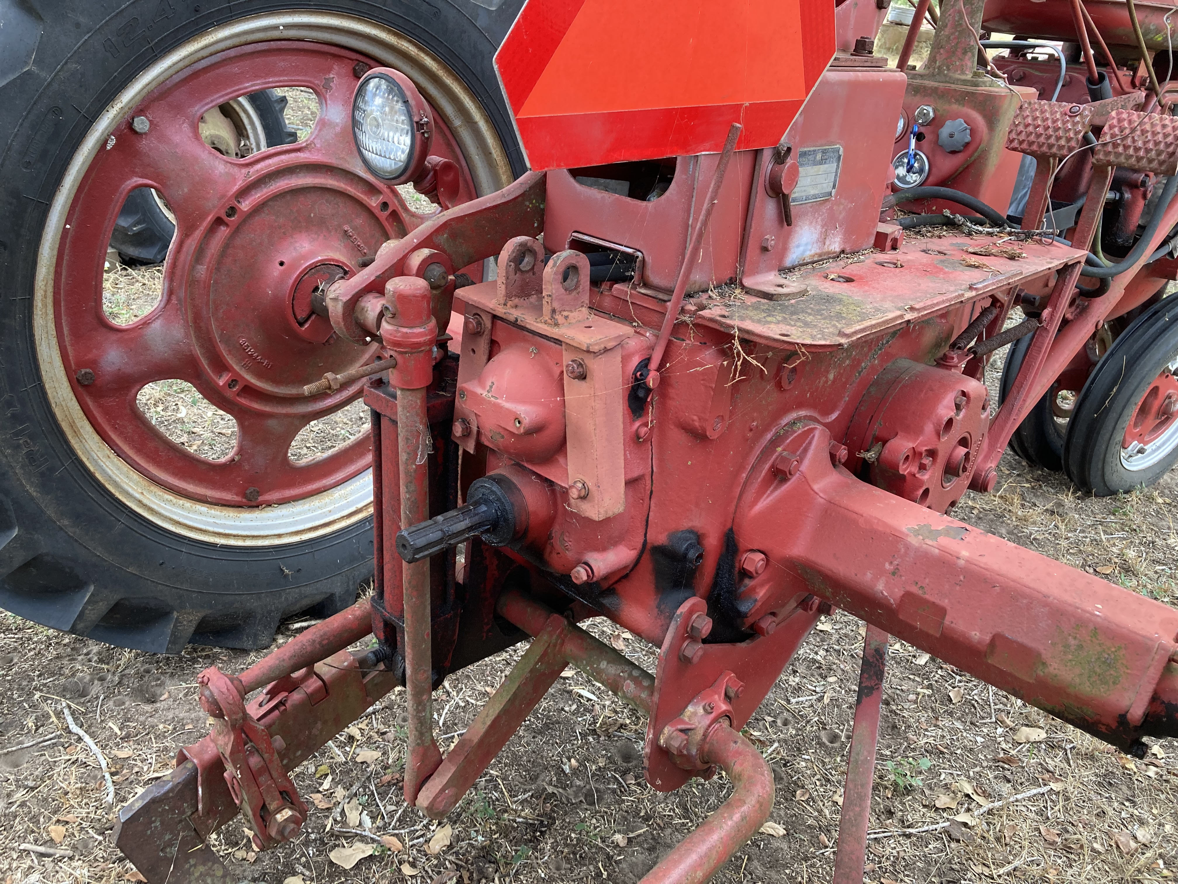

To make this thread a more useful reference I took a few more pictures. I was lucky to get a complete 1953 donor still on the rear end, my Super C is 1951. A lot of them in a pile are missing something.

I grew up with one of these on a 200. I see everything you need but the stationary side level link that allows you to remove the bar to the left side front touch control. About the only time you need either the left side level bar or the right side (top link adjustment) front to rear level link attached to the touch control is for plowing (with a C200 plow) . All other operations will work just fine in the stationary position. I have seen at least one where a SC owner replaced the right level stationary bar with an adjustable linkage from Tractor Supply, and it actually looks more stable to me. If you want to attach a stalk cutter you might need a 3-point factory adapter (not ideal but it will work). If you want some pictures, let me know.

None of the pix are from the OP. Just mine trying to show what I thought was complete for him to reference.
