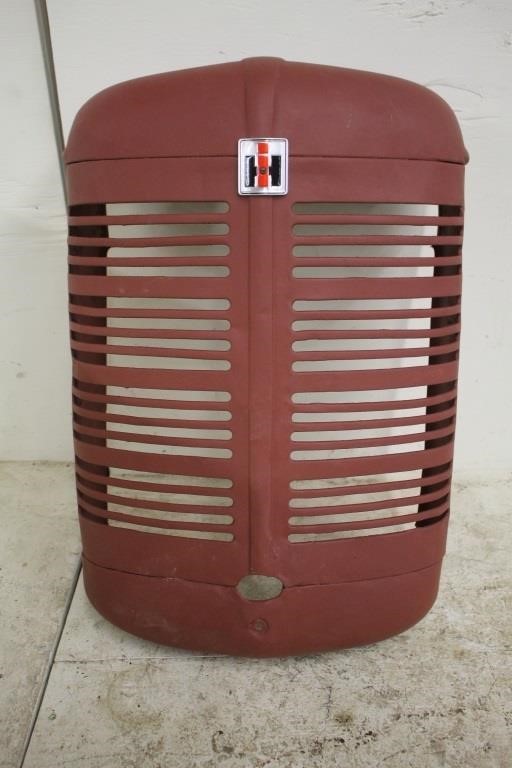

I just bought what I thought was a Super C. It seems to be a solid tractor. It has the Super C characteristics: Curved pedals, water pump, disc brakes, temperature gauge on the touch control. The date codes are "Y" 53 except for the engine which is "S" 49. I have read that a water pump could be added to a C 113. The block ends in R 069 indicating a C 113. Would you agree that it is not likely a C 123 which a Super C should have? I have read that C113 can be sleeved up to a 123? Thanks
The easiest visual for a Super C is the extra space between the crank hole and the last bar on the grill. I think all the sleeve kits for C113 are 3.125 now so they become 123 cubic inches. There are differences with the C123 block and It can take 3.25. Like @Jim Becker says the block was probably swapped with an earlier one. Good luck with it.

Thank you. That is like mine.
