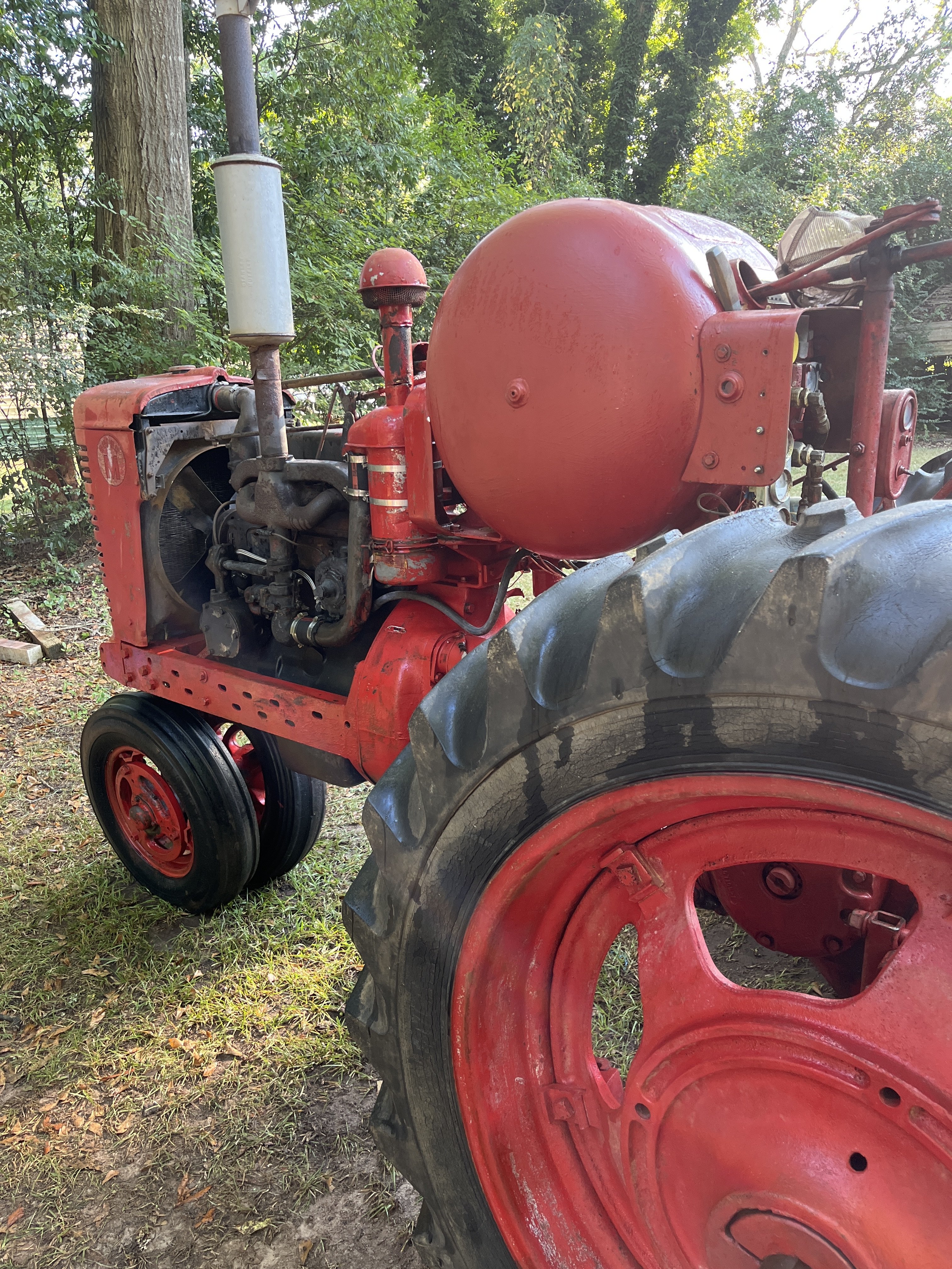

Morning,
I recently purchased a Farmall Super M Propane powered tractor.
Was wondering if Farmall built the propane powered tractors in their factory or did they send the to be modified.
Anyone have any idea how many Super M Propane were built.
Thanks,
Billy

AFAIK,The Super M was the first factory equiped propane tractor.I dont think records were kept on how many propane tractors were built. But not many I would guess.Earlier H/M were later equiped after they left the factory.AFAIK,Minneapolis Moline offered the first propane tractor. I think it was 1941,but not sure.

Of all the propane tractors I have seen I think MM did the best job of designing them so they didn't look so bloated with that propane tank.

I am about 95% sure all the Super Ms and SMTA LP models were sent to an outside vendor to convert/install the propane fuel system. I suspect that the engines were assembled at the factory with the parts to yield the higher compression ratio to run with LP. If you search around a bit you can probably find some previous YT posts on this. The “100” series (300, 400) were the first ones to roll out of the factory turn key to burn LPG.
As far as compression, the LP engines don’t even have a high enough compression to worry about them not being able to run on pump gas. Factory Super M LP CR was 6.75:1 vs 5.9:1 for gasoline models. I think current 87 octane gas will work fine in none computer controlled engines up to 8:1 CRs with cast iron heads and rough “as cast” combustion chambers.
