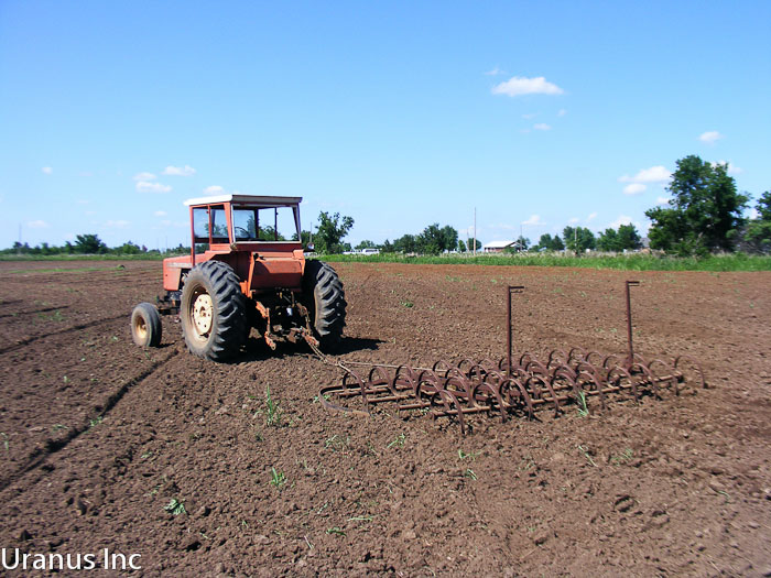

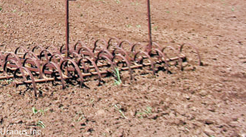

I used to do conventional tillage, like you're doing. I'm trying to go back over my hard drives to give ya pic of a well done field.
Had to snag an old photo off the internet from some years ago. Was putting up some pics of dryland farming around here. I think the originals are on an old mechanical hard drive that's crapped out.
An old pic off of Weldingweb. This is the final pass before drilling. Note how the springtooth is run at an angle. This allows you to follow the last pass you made with the seed drill. The drill leaves a pattern that's cross hatched to the springtooth pass.
Anyways.............look at the field, compared to yours. Lottsa clods. This is as smooth as a field needs to be. The clods range between 2 to 4 inches in diameter......................your drill will work in these conditions. There's a ton of fines down in between those clods. Enough to provide good soil contact for your seeds.
I had to work off the file that's on the internet, and crop a section. The original is on the bad hard drive.........sorry for the lousy image. But, you can see that this is anything but a pretty seedbed. It's a seedbed made for WEATHER. I generally used to get around 85%, and higher, germination. Right in line with the germination rate, as tested, for the seed used.
Lemme put it this way..............if you see dust blowin' off the field in moderate, to heavy, wind................ya did a lousy job. Your job is to conserve your soil.
A springtooth does nothing but level the ruts you left when you disced your fertilizer in. It doesn't cultivate, or anything else.............it just fills ruts.
It's a firming process.
The plow, or offset, brings it up, and loosens it.
The finishing disc firms it to the depth of the discs.
Then the springtooth firms it to the depth of the teeth.
Every pass is successively more shallow. Remember..........every pass releases soil moisture. You don't want to work ground down to China.
When you're done, you have a very firm seedbed.
Finally, if you use a hoe drill, as I used to...............you put that seed about 2" below the firm layer You hammer it in there. INTO MOISTURE. The hoe drill was the first "no till" tool. Very popular here in the Southern Plains back in the day.

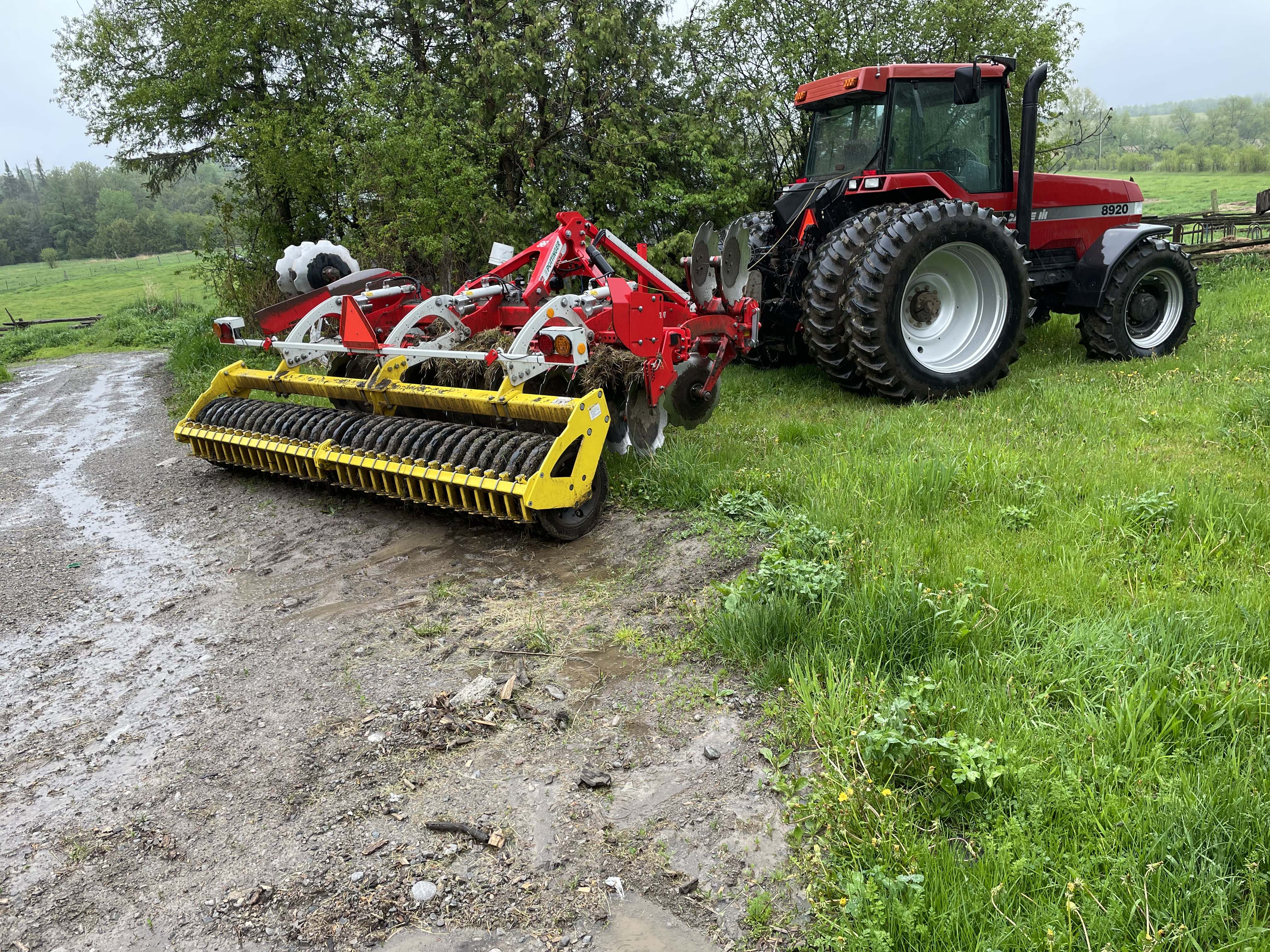

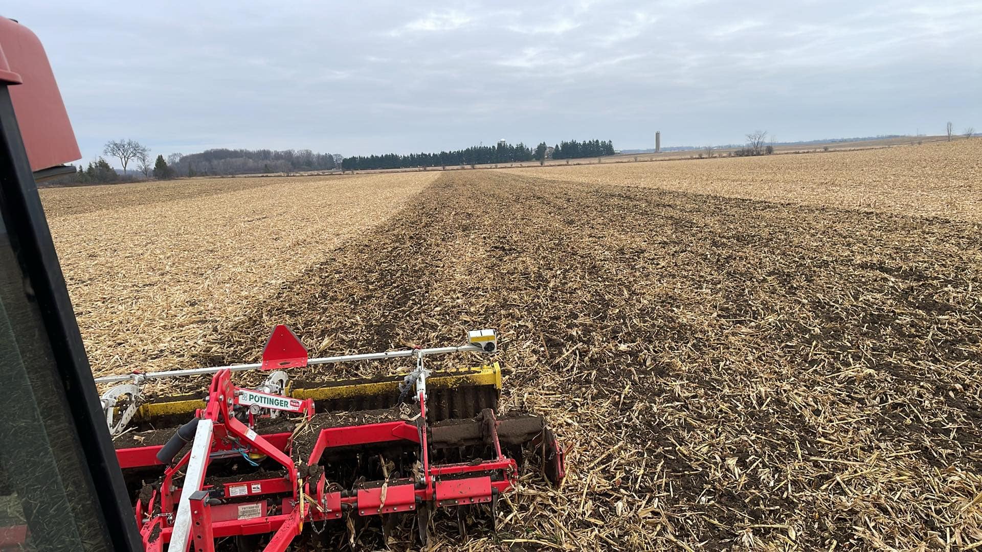

I used to do everything in conventional tillage, drag a mouldboard plough across 100-130 acres each year. Grew corn mostly for silage on roughly 30 acres each year and 80-100 acres of mixed grain ( Oats and Barley) for feed grain and straw. I hooked a set of harrows behind the 18’ vibra-shank cultivator , and had a cultipacker hooked onto the back of the seed drill. Erosion has never been an issue for me, but time between morning milking and night milking was always at a premium. So trying to get two jobs accomplished in one pass was important to me. The last few years I dairy farmed I bought a high speed tillage piece, built by Pottinger, called a Terradisc. Now I no longer plant any hay or mixed grain, just corn , soy and wheat. The wheat gets planted directly into the soybean stubble with Zero tillage before planting. Once or twice across wheat stubble in the spring and the ground is ready to plant corn. Similar with the corn stalks, 2 passes over the corn stalks behind the combine, and one maybe two passes again in the spring and ready to plant corn or beans. Beans always get rolled in so field is as smooth as possible for harvest day. So I have done it both ways, conventional tillage takes far more time and uses more fuel. The way I do soil preparation now is fast and only requires one piece of equipment. Cuts, mulches levels and rolls all in one pass, and in less time then it would take to plough. First picture is mulching corn stalks last fall after harvest. Second picture is a rear view of the tillage piece.
More and more of these terradiscs are showing up around me too. From what I see they are quite the unit as far as finishing a field goes. But they can take a lot of HP to pull at the right speeds.
They do require some hp, but I never have been able to figure the equation of time vs hp over fuel consumption. Multiplied by capital cost ?? For me it really comes down to the number of acres I need to get prepared, and the time in which to achieve that goal. I used to get one of my boys pulling a disc harrow behind one of my 100 hp tractors while I dragged a cultivator behind another tractor the same , both tractors burning diesel fuel. Now it’s just me with one 155hp tractor burning the same or less fuel in a day getting the same job done. Both ways work, but one way requires more man hours/tractor hours to get the same work done.

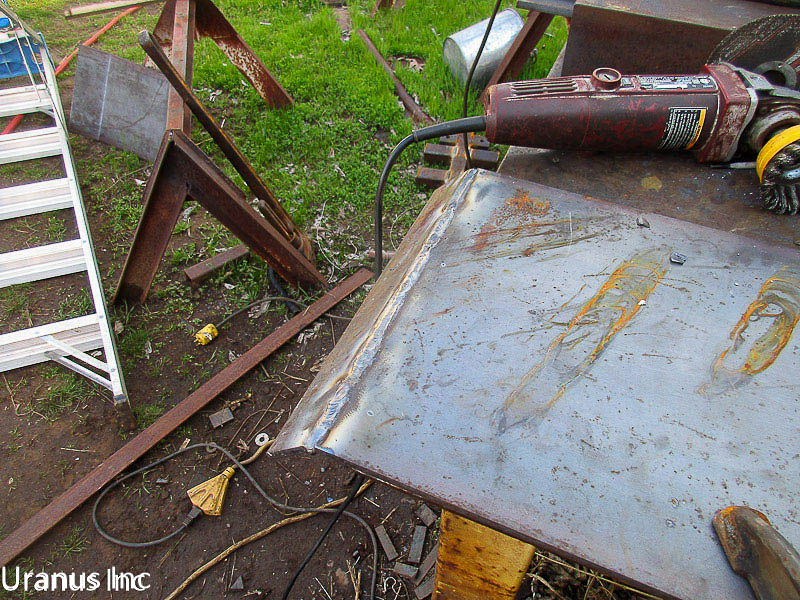

This is for you guys that run disc mowers.
I generally run a sickle head. Last year, I had to run a disc mower. When running a sickle machine, I set my gauge wheels to run at least 6" above the dirt.
However, facing using a disc mower (I hope I haven't posted this before), I needed to lift the cutting bed out of the dirt.
This is just plain STUPID. These machines, if you run them level, will literally run in the dirt.
I decided to make some skids to keep the bed up where it should be. (I don't/didn't rely on tilting the bed..........if it's made to run level, it ought to run level)
Get ya some plate, mark it, and slit it with a razor wheel. Bend it further than it needs to be bent..........to compensate for welding.
Tack it up to hold dimensions when it's finish welded. The tacks will hold the angle from changing when welding.
Weld 'er out. Just concentrate on filling the bevel/bend. You'll grind it smooth later.
If you did it right, you held your angle. Usually, you need to bend about 5* beyond what you want to wind up with.
Smooth it all out, and you have some skids that would cost you about 5 bills to buy. Note the lip at the back of the skid. This is to prevent the skid from digging in should you need, for some reason, to back up when the cutter bed is on the ground.
I won't go into the structure to actually mount the skids on the Krone mower. Mowers vary, and it's not my job to do your thinking for you. You should be able to figure this out for yourself.
We're good to go. The bed has been lifted enough to provide an acceptable amount of stubble, for quick recovery, and weed prevention..............and to protect the knives from obstructions (like rocks)
With float, the effective clearance will go as high as 6 inches when you encounter an obstruction. I had scarring on the skids when finished with the field.........which tells me it encountered rocks. But, due to the lift................no drama.
