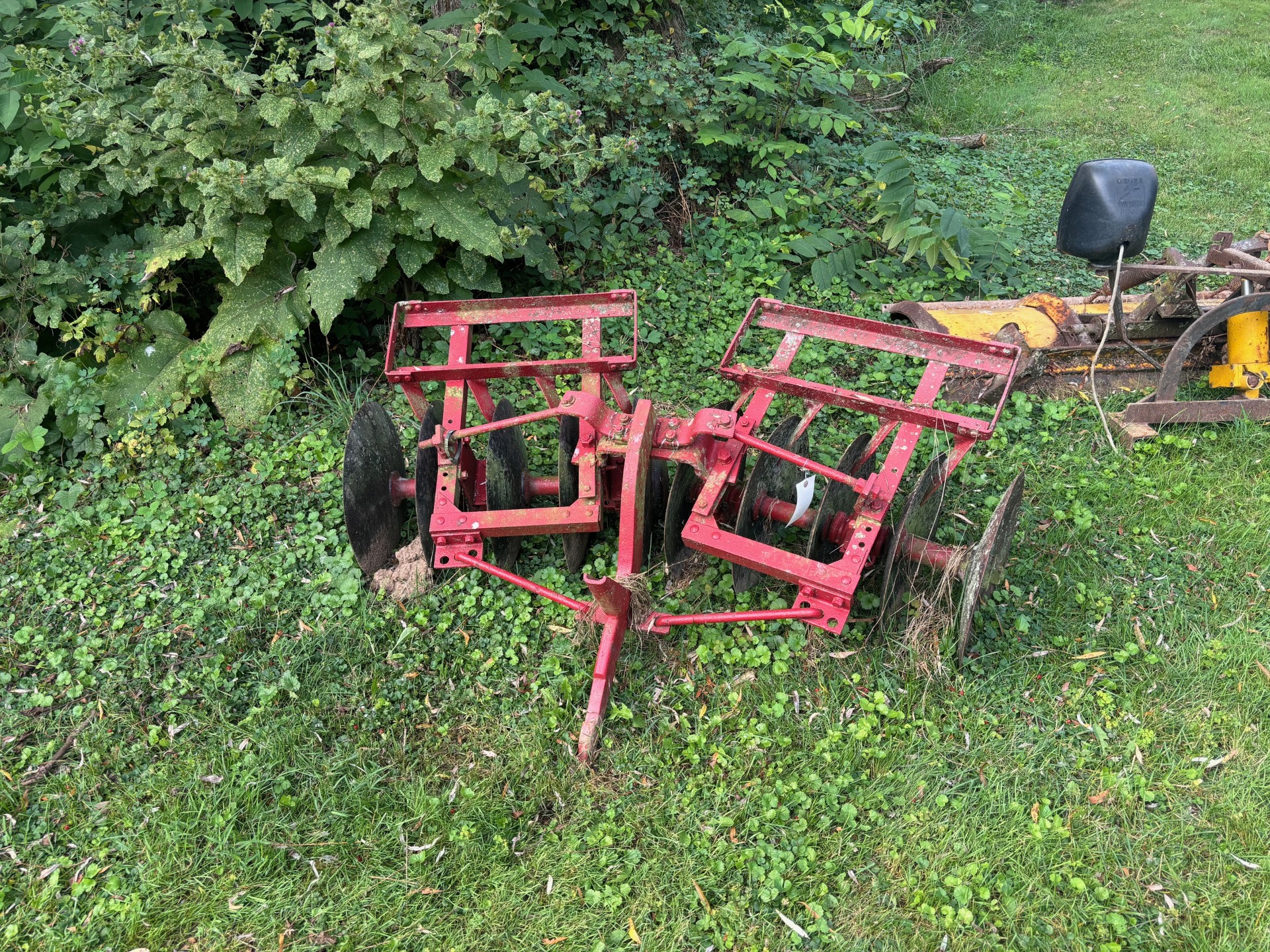

I just picked up this fast hitch disc today at an auction for $225. Was wondering if anyone would happen to know the model number. It is roughly 60" wide. I plan to use this with my fast hitch Super A. Thanks!

The model number escapes my memory at the moment, but it is a Farmall bush & bog disk that is meant for the Farmall Cub being it has the downward sloped fast hitch and 10 total blades. The other style intended for the Super A-1 through the 140's has a straight FH prong and 8 total blades of a considerable larger diameter.
