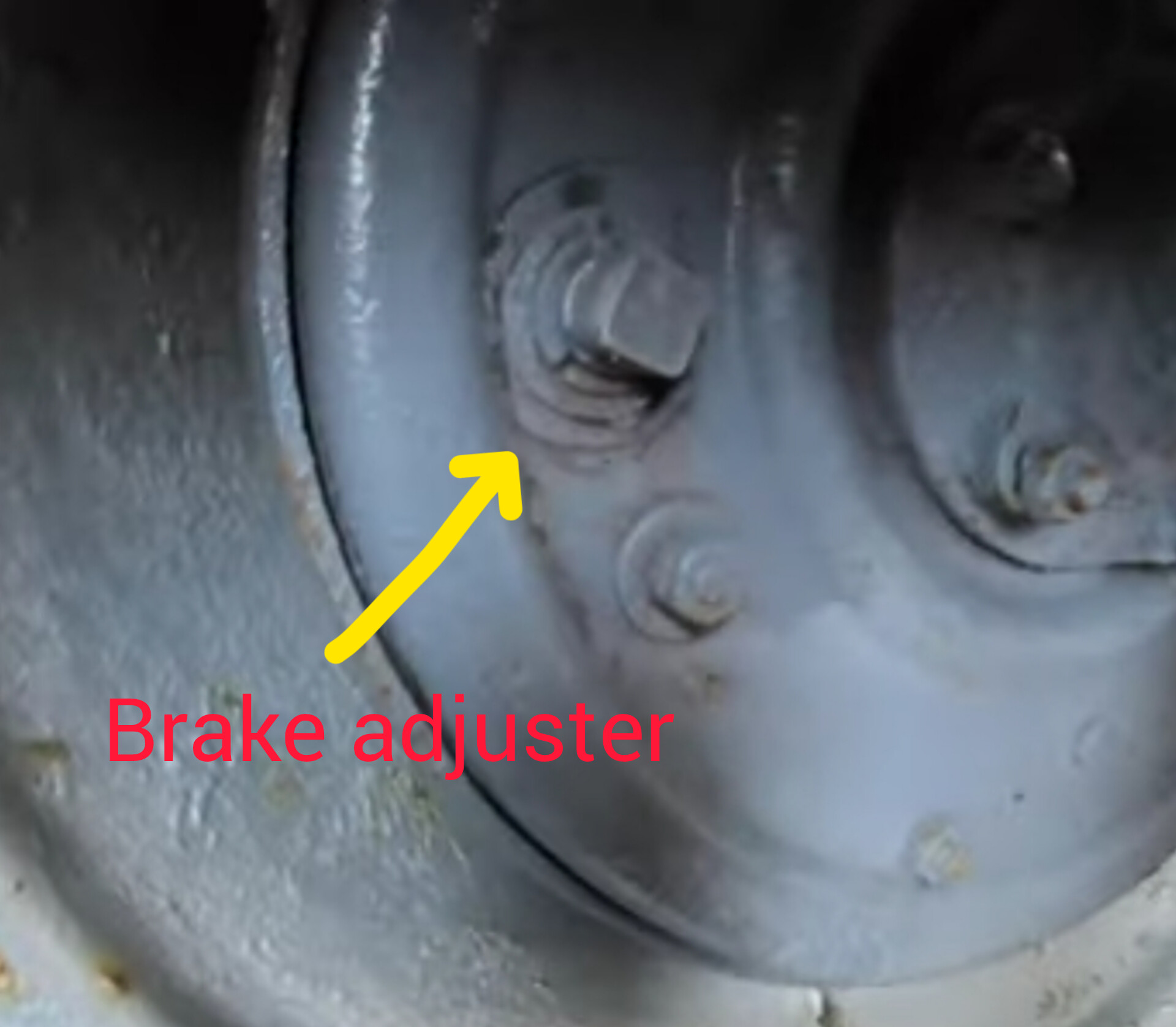

ThanksTo tighten the brakes. While at the rear of the tractor facing forward.
Right side.. With the wrench pointed down.. Turn the wrench toward the front of the tractor.
Left side.. With wrench pointed down.. Turn the wrench toward the rear of the tractor.
You should raise the rear tires off of the ground if possible. Turn each tire by hand as you adjust the brakes. Adjust them until you can't turn the tire then back the adjuster off two or three clicks.

The adjustment is inside the drum attached to the shoesWhere exactly is this adjustment located? Is it in the brake drum itself? I'm just wondering...can't picture it.
Does the drum come apart with the tire on?The adjustment is inside the drum attached to the shoes
No. I can adjust the brake through a slit on the inside of the drum. But I can't remember if I need to rotate the adjustment star clock wise or counter clock wiseDoes the drum come apart with the tire on?
got it. thanksNo. I can adjust the brake through a slit on the inside of the drum. But I can't remember if I need to rotate the adjustment star clock wise or counter clock wise
Your picture reminds me of Girling brake adjuster as used on TE models. I could be wrong.
Mine is different. Mine has a slot where you fit a flat head screwdriver and turn the star adjuster
Number 10 on the picture by the spring on the left sideMine is different. Mine has a slot where you fit a flat head screwdriver and turn the star adjuster
